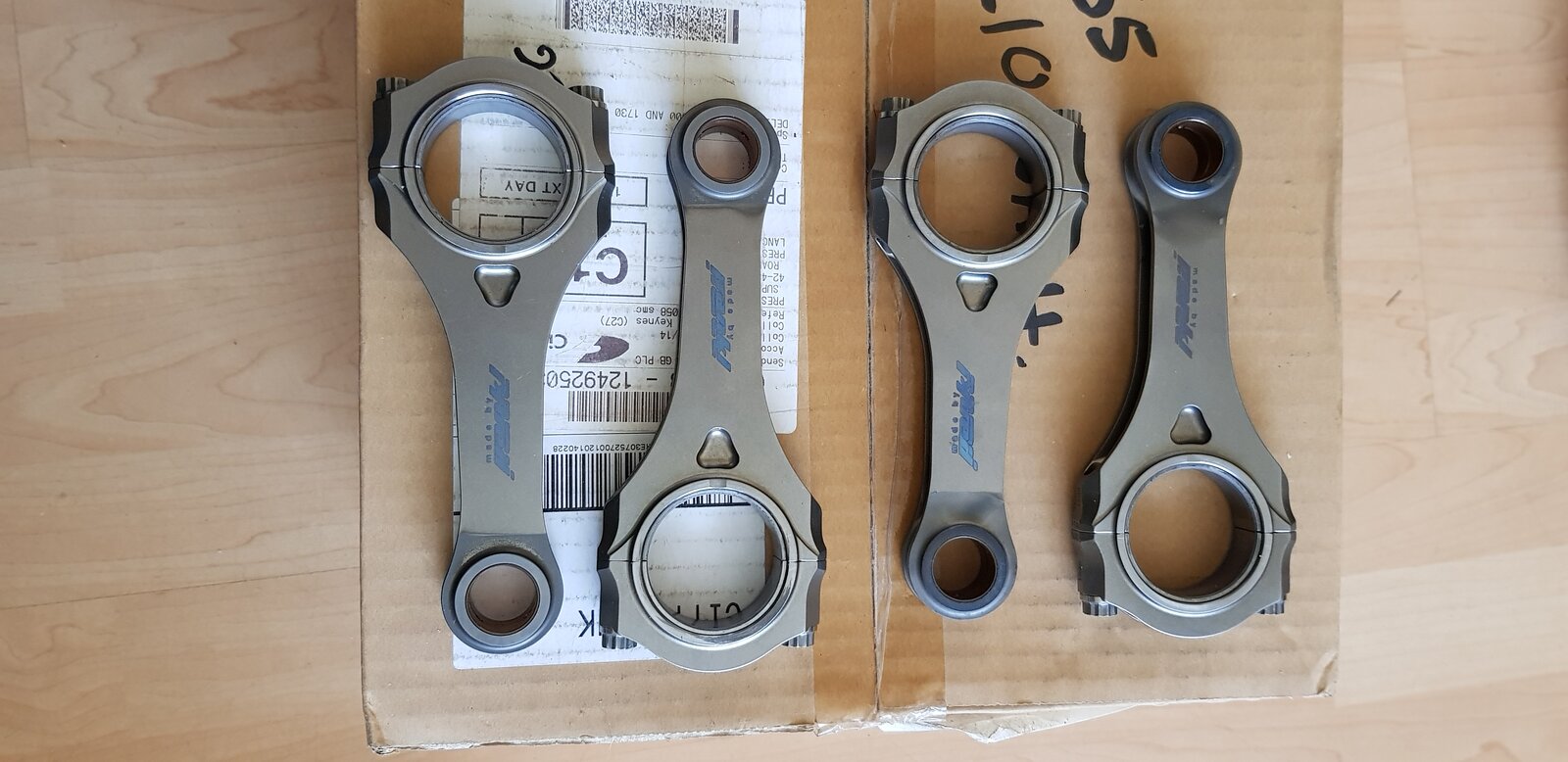

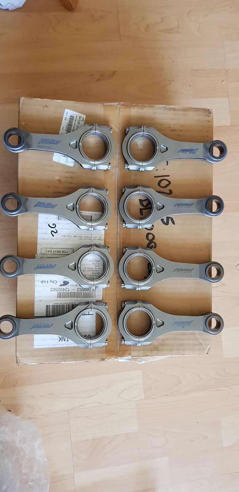

  1. I have 4 (what I believe to be) matched pairs of Pankl 996RS con rods, 2 x part number 65P2A006b which is an A dimension rod and 2 x part number 65101160c which is a B dimension rod, includes bolts of which 2 are new and the others are used as stamped (1, 2, 3 or 4 tightenings). I believe these to be ex MonsterMob circa 2002 as they came with the 2 Stuart Easton 748RS engines I bought in 2015.
    Clearly these rods could be priceless as easily as they could be worthless so I'm happy to negotiate how best to buy with confidence and agree an appropriate value. Andy

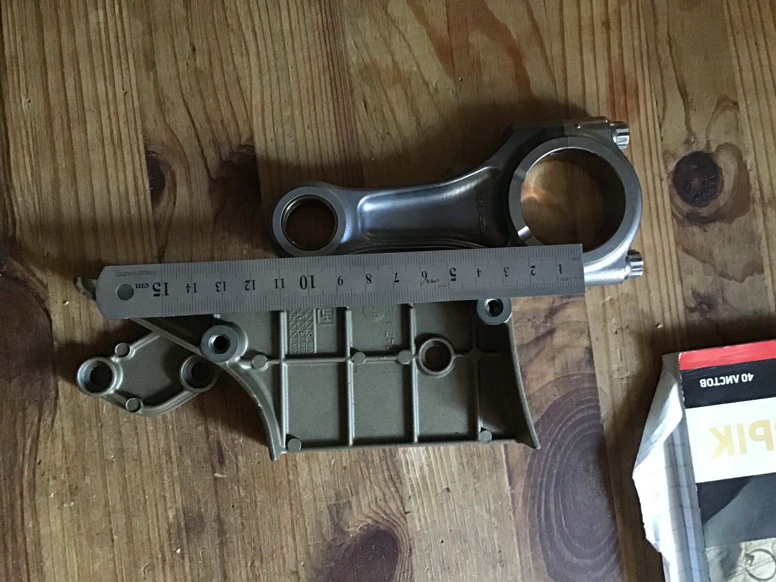

  9. Their (Carrillo) rods for the 748 and the 996/998 are the same overall length which has confused me. The Pankl rods I have that are definitely 748R/RS are shorter overall than the rods I have been told are 996RS. Aaarrgg. Need a hair pulling out imoji. Andy
  10. I would list them as an eye to eye length or research the name and that measurement for a part number
  11. Think JoeC was selling some 996rs rods. About 100mm iirc
  12. Infuriatingly, my vernier is about 10mm too short but centre to centre is approximately 127mm.
  13. Ooh err, mine measure 127mm. Wtf have I got ? Andy
