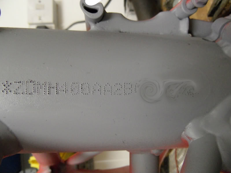

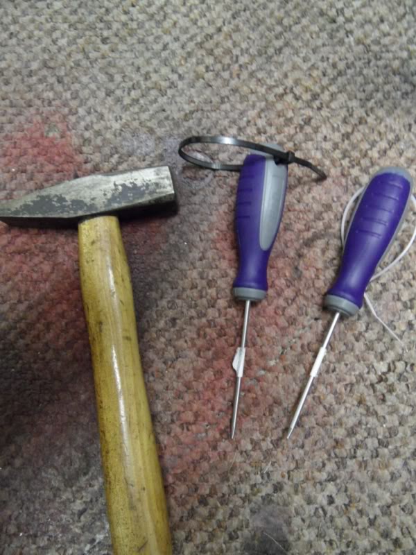

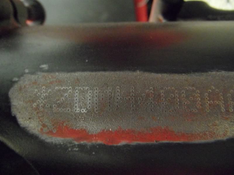

  2. I had a frame coated and after the process the VIN was just not there. So I stripped back the coating to reveal a very flat VIN which was just filled by the powder coat making it invisible
    So I re did it by hand dot by dot
    Then had it wet painted.
