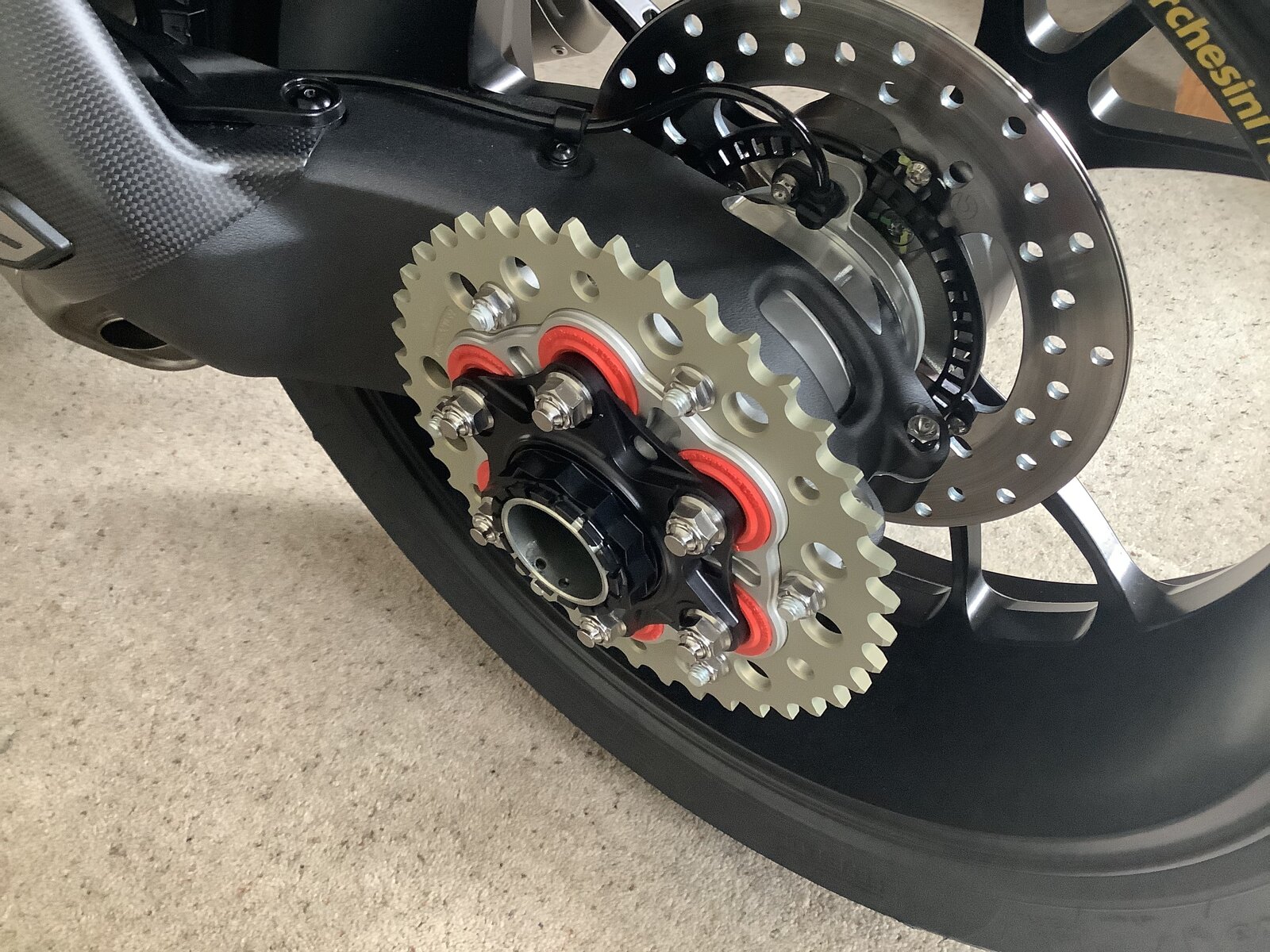

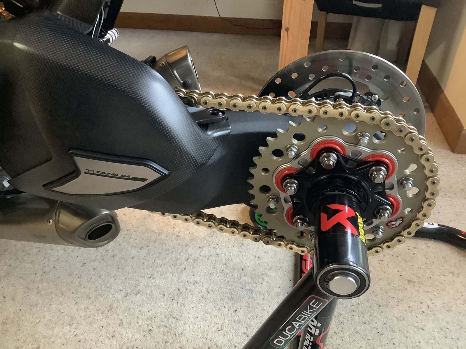

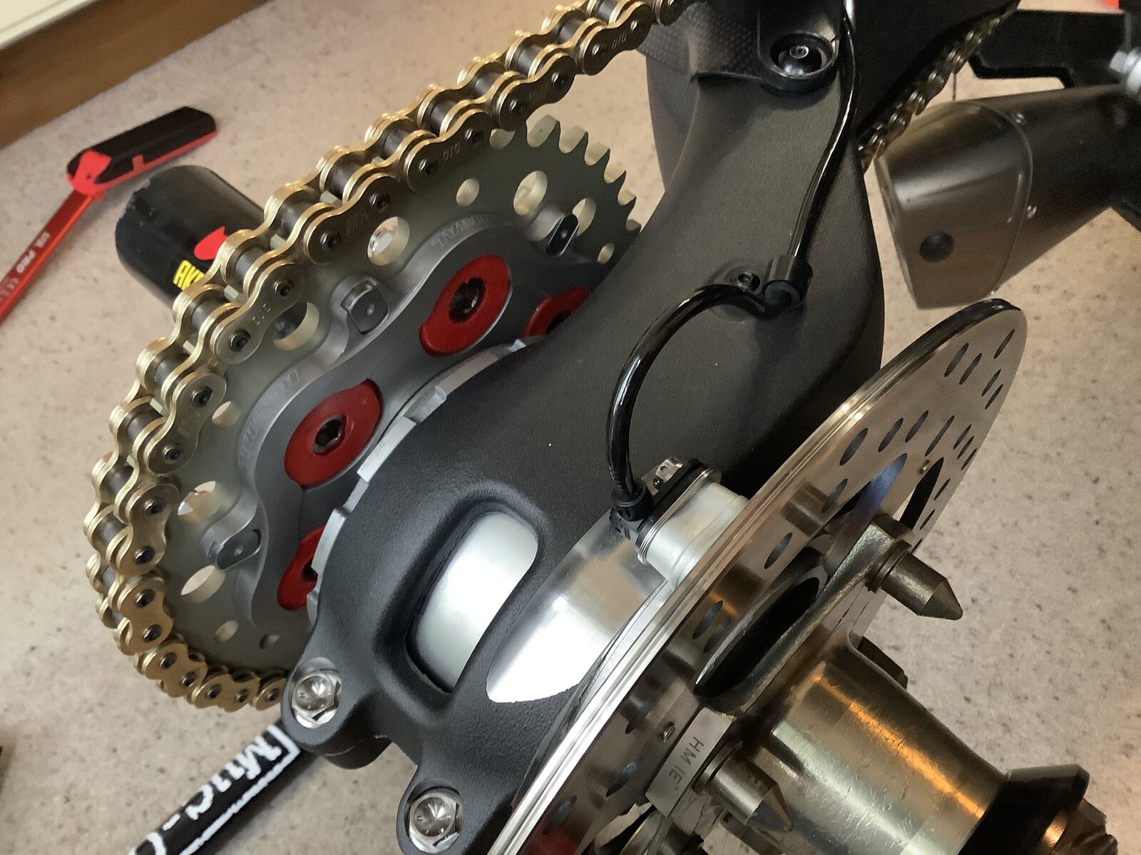

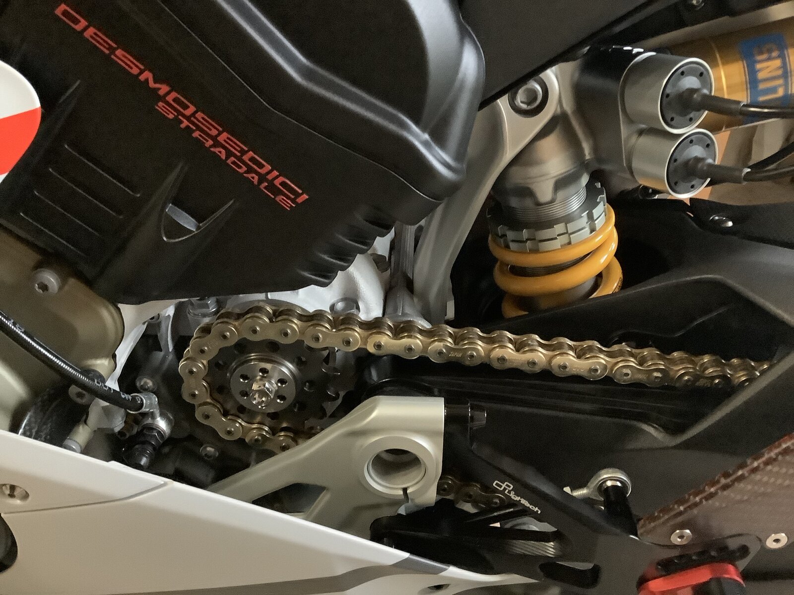

  8. I’m running the 520 conversion, Renthal lightweight front and rear with quick change Renthal carrier. DID EVR3 race chain... I’ve since gone down one on the front sprocket. Exactly the same part number for Renthal front sprocket on my old 959... Shop around as it should be easy to find! AR racing have always been really helpful and keep plenty of stock...
  9. 5B07123C-CB73-43B2-9665-7999E0CD4A30.jpeg 98221434-BA27-478C-B105-174187A6B36D.jpeg ED370785-8525-46EA-89FC-8A06E4C9EE55.jpeg 4ED062CD-8FF9-4662-A000-51509DEFC916.jpeg
  10. Hi Dave can you do a photo of where your chain sits in relation to the chain rubs please?
