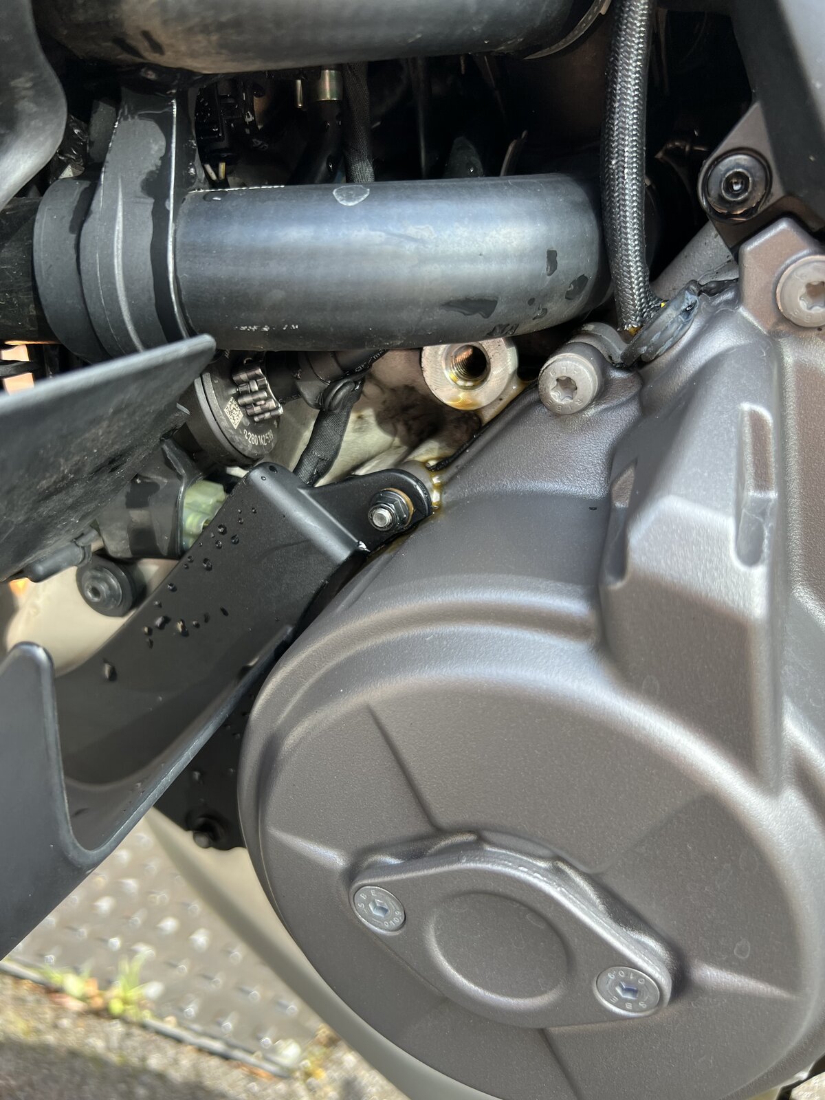

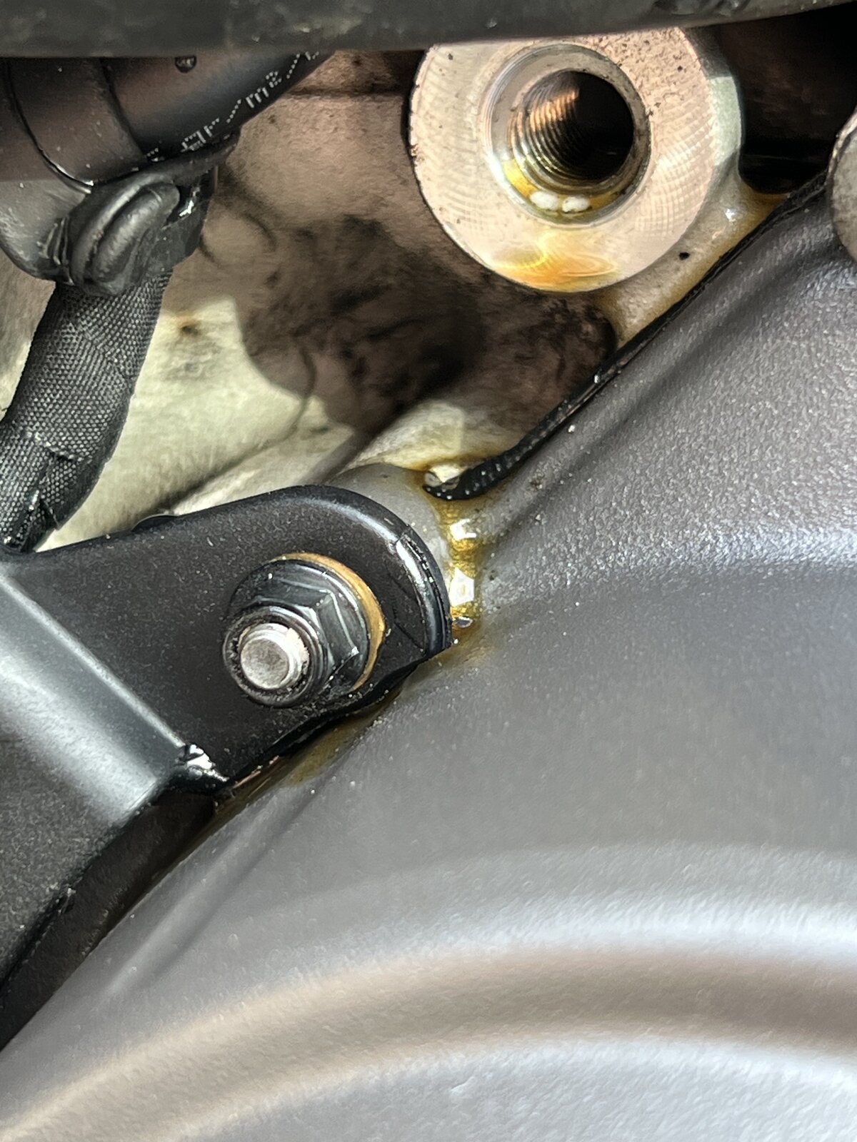

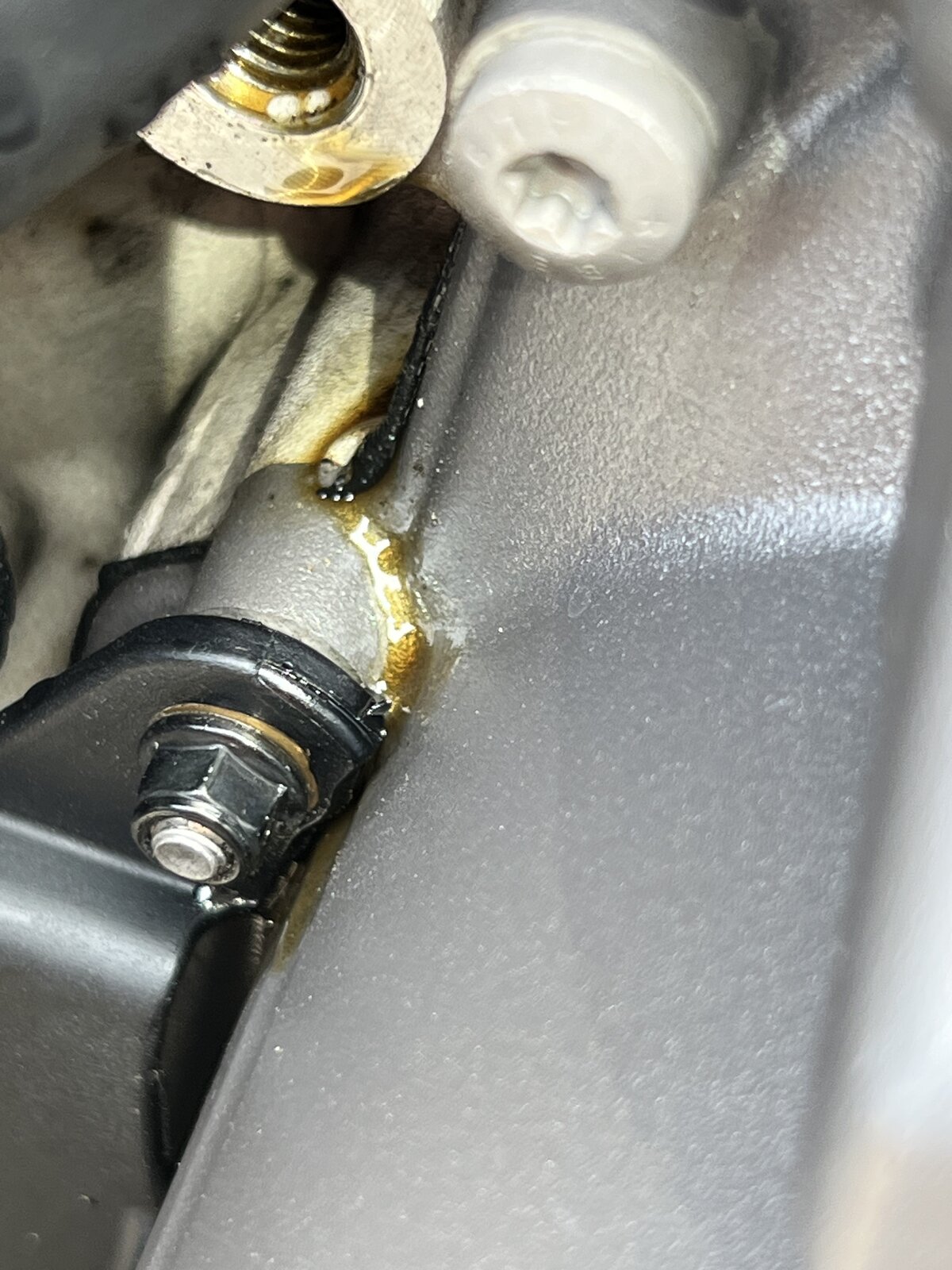

    Mine is currently in Riders with an oil leak, which was also picked up by the German dealer. Known issue apparently.
  7. Confirmed new water pump required. German dealer said it was a known problem but mainly on the earlier bikes not a 2023.
    Warranty it is.

  8. New water pump fitted under warranty. 3000k miles
