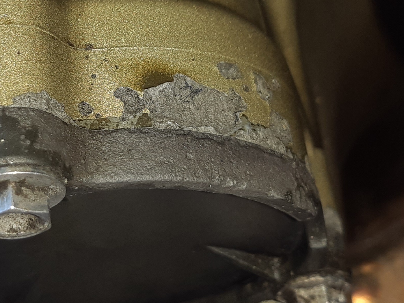

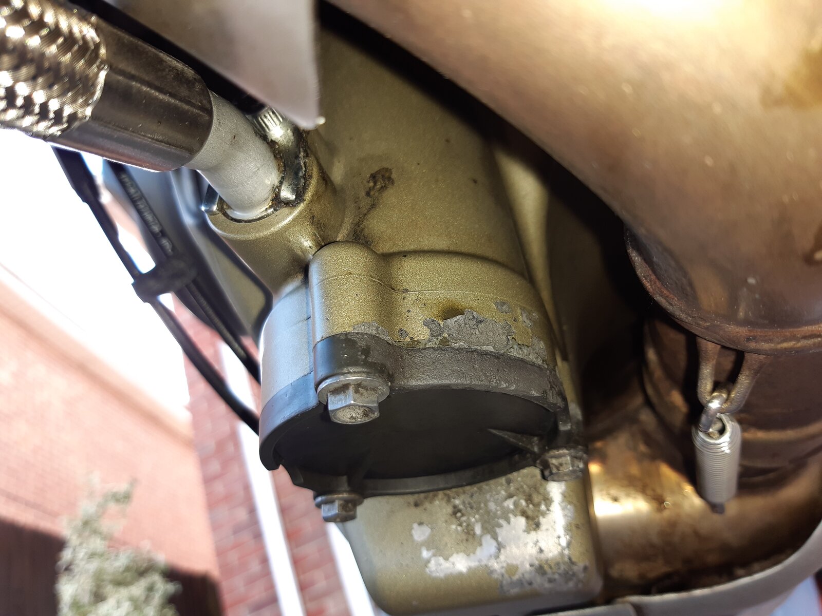

  1. have a streetfighter V4 2020. Its garaged and only sees dry weather. It's done 650 miles. I checked the underneath of the bike at the oil filter area and the engine case is breaking up as if there is a quality metal issue with the casting. Has anyone come across this before?

  5. Christ, that does look dire. I’m pretty certain my 2018 V4S doesn’t look like this. I’ll double check today.
    For MY20 with 600 odd miles Ducati U.K. should address this. Unless the 600 miles were through salty winter crud then left for 6 months....
  6. All dry miles no wet weather riding. Only purchased in November 2020

  8. Hmmm, thing is riding on winter roads (even if bone dry) will sling a saline dust on the underside of your engine. When the engine cools it draws moisture. Boom... a shitty little cocktail to corrosionville I’m afraid.
  9. But looking at the pictures again I would say it looks like chipping damage rather than corrosion.
  10. Bike washed properly after every ride. Not expected after 4 months! Never had this issue with any other bike I've owned

  14. That is defiantly corrosion, pitting on the cover and looks to be a little crevice corrosion lifting the anodising.
    what are you using to wash the bike? Hard water area? water softener (salt)? pressure washer?
  15. No pressure wash. Turtle wax wash liquid. The casing has a chunk of metal missing. Surely that pints to a lack of proper paint protection! Only ridden the bike 7 times in dry weather.

  18. If it is corrosion its should be through the casing and into the big ends by November this year. Good paint protection for 17.5k!
  19. A 2020 bike with 650miles should not look like that, with or without salt on the road. Its a road bike, sold in the UK so it should be reasonable fit for purpose. You didn't buy a summer, dry day only bike, with warning to wash and dry it immediately after use.

  20. Looks the same has happened to the actual cover as well as the sump casing, I recon they are going to say it’s salt corrosion? :(
    Still poor though, that paint on the bottom of the sump behind it is thinner than a fag paper! A quick Google search and I found images of V4 pani’s looking like they’d been sand blasted, one of them even had a hole punched through it from a stone, people making diy sump guards for them.
