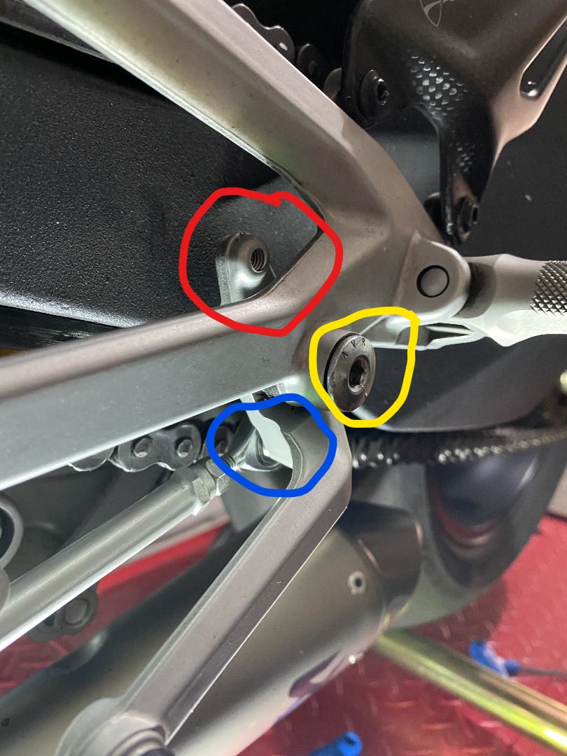

  4. Red circle is the OEM location.
    Move the linkage to the blue circle for reverse shift

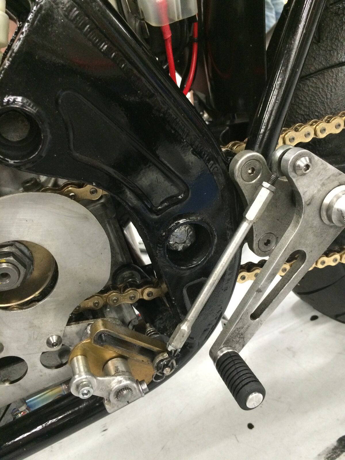

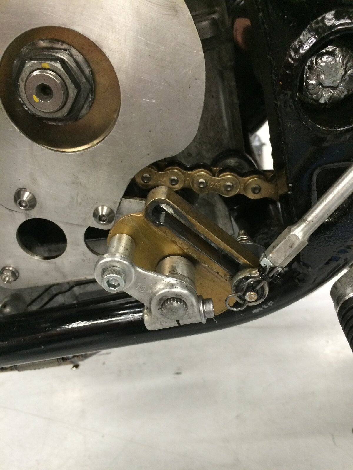

  6. On the subject of race vs road shifts, (however not on V4s), here's an interesting engineering solution, spotted at Spa. A quick change shift pattern on an endurance race bike to suit different riders on the same bike
