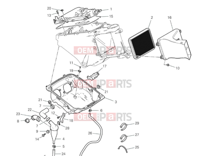

  7. Is there no schematics or service manuals showing how the air intake looks? With that would be a bit easier to work out location, and wade line height.

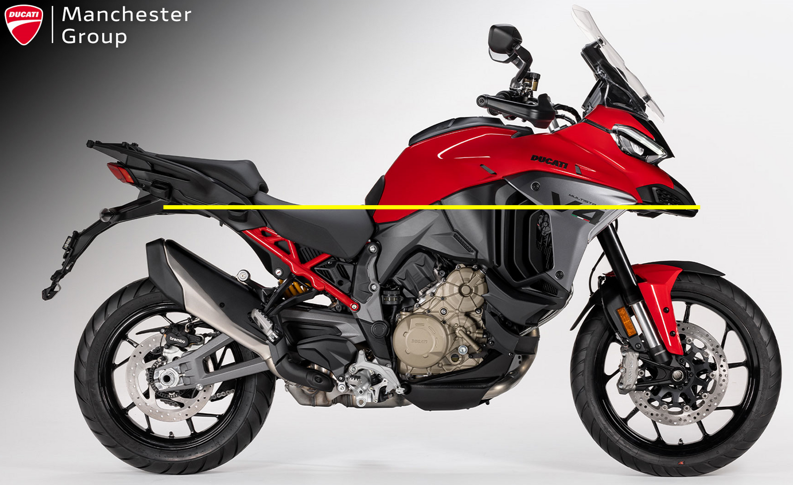

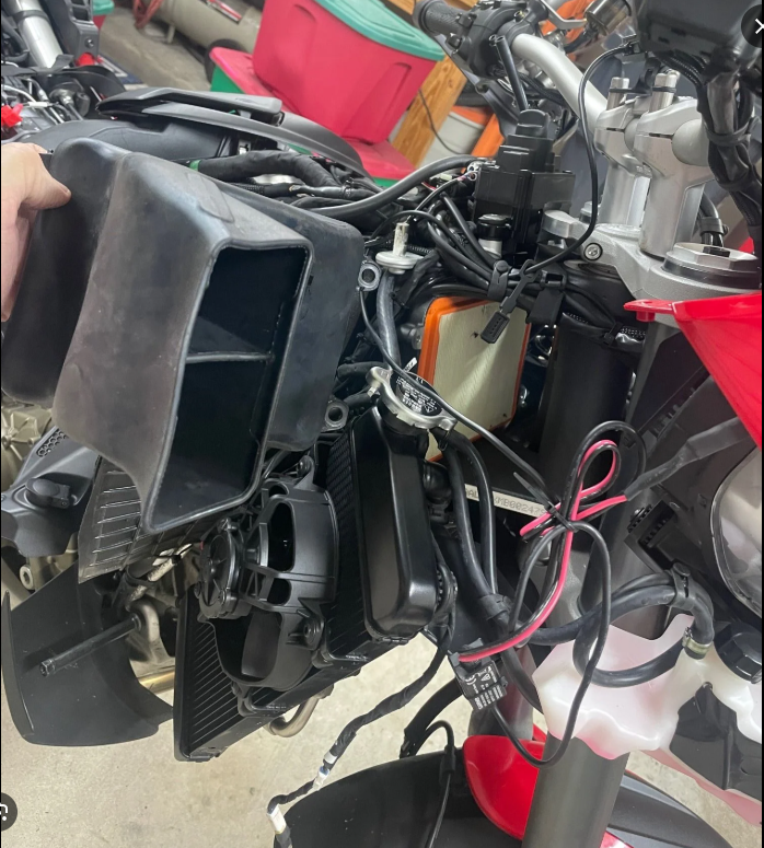

  8. Front of the beak I would say?
