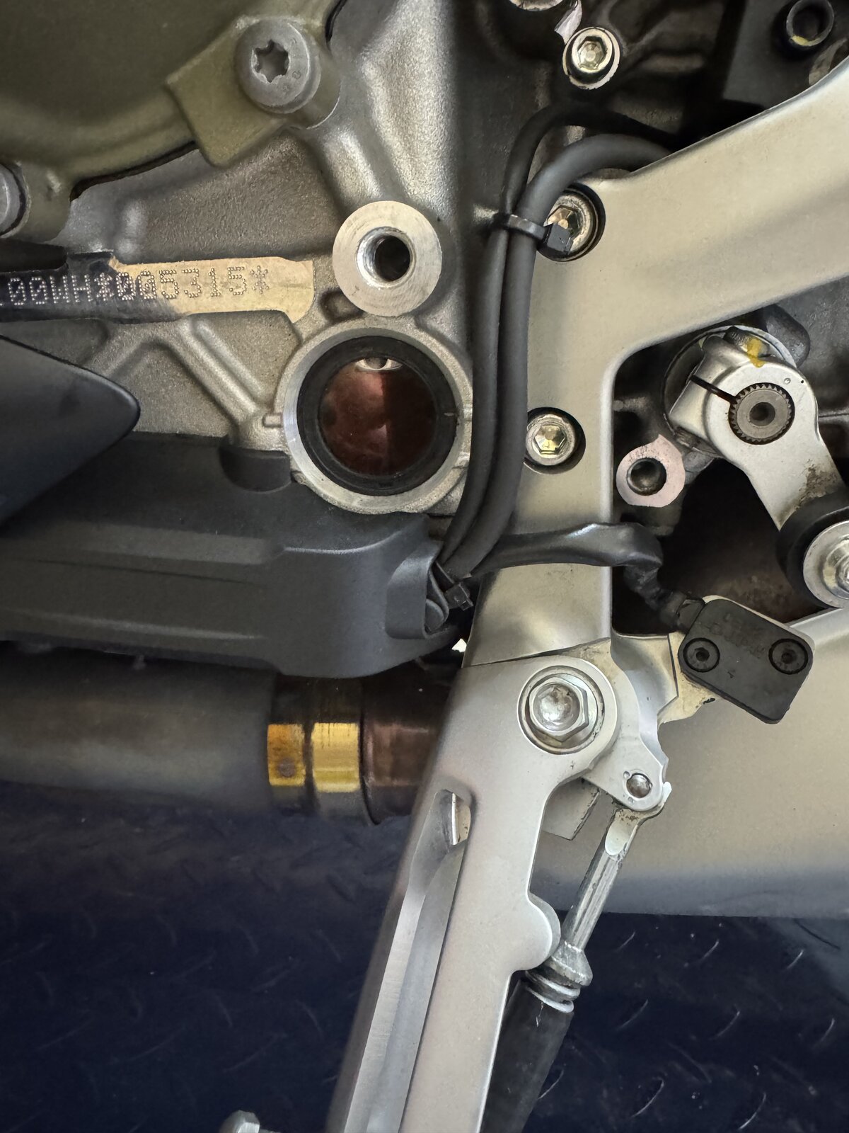

  1. Had a 22 plate bike delivered to me a couple of months ago and the oil level was just under the minimum level in the sight glass.
    the bike sat for 6 weeks for various reasons until a 200 mile day out, the day after putting the bike away the oil level looks to be brimmed,
    this bike was main dealer serviced 3 weeks before I bought it and after speaking to them today they explained the filling procedure as run the bike up for 15/20 minutes, leave to cool 2.5-4 hours and top up if needed!
    is it a pain to do an oil service on these bikes as I’ve read varying ways, and as this seems massively over filled? I wouldn’t know how much to put in?
    Is there any specific tools needed? Apologies for so many questions as first v4 and streetfighter.
    ideally change it myself as off the weekend and be good to get more miles under the belt.
    Any help would be much appreciated
    cheers
    #1 raphael, Aug 5, 2025 at 8:13 PM
  2. The quick way to do it is to weigh the amount you take out and put exactly the same back in.
    Last one I did was filled correctly but even 30 minutes after stopping it seemed to be low. Allowed to sit a few hours and the level came to the correct height
