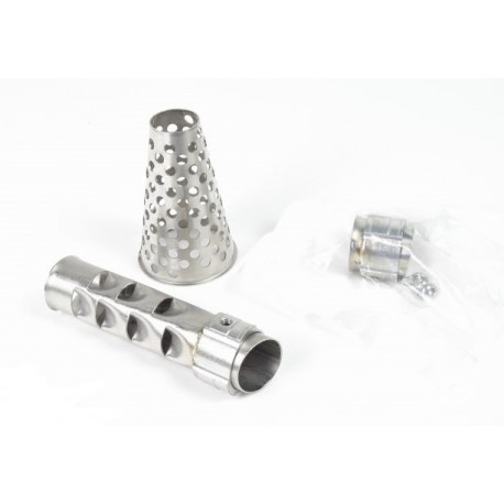

  1. Aup guys running a akra exhaust on my v4 worried about noise testing for track should be fine for donny loud days but ducati do a uprated d.b killer kit as pictured but they say it only drops it to 107db ? Couldnt tell me at what revs tho ? Anyone running the akrapovic exhaust and what have u do to it down to under 105d.b
  2. I ran that set up at the Ducati day at Silverstone in July. I wasn't measured in the pit lane but I thought I got pulled by the drive by meter. Turned out it was the 1199 behind me. Drive by was supposed to be108db. Running in Spain, my impression was that even the new version 2 db killers would not be enough for many of the UK circuits. Andy
  3. How does the big cone 1 fit it looks to big for the cans ?
  4. It goes in the front end of the can not the back. Pretty sure it’s the vertical cylinder exhaust can but best check. Andy

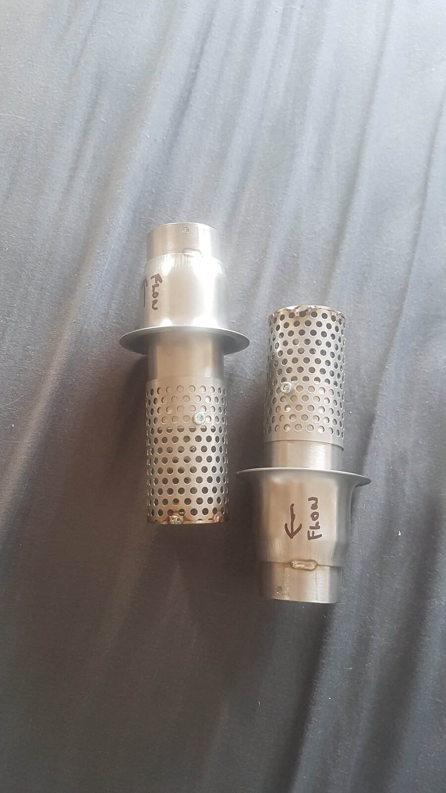

  9. Did anyone sort any baffles that was good.enough to bring the noise levels down enough for uk tracks ?
  10. Ended up buying these adjustable baffles for the akro system been tested as low as 92 static
  11. Hi
    Were did you get the dB killers from?
  12. I need some of these. Where did you get them from?
