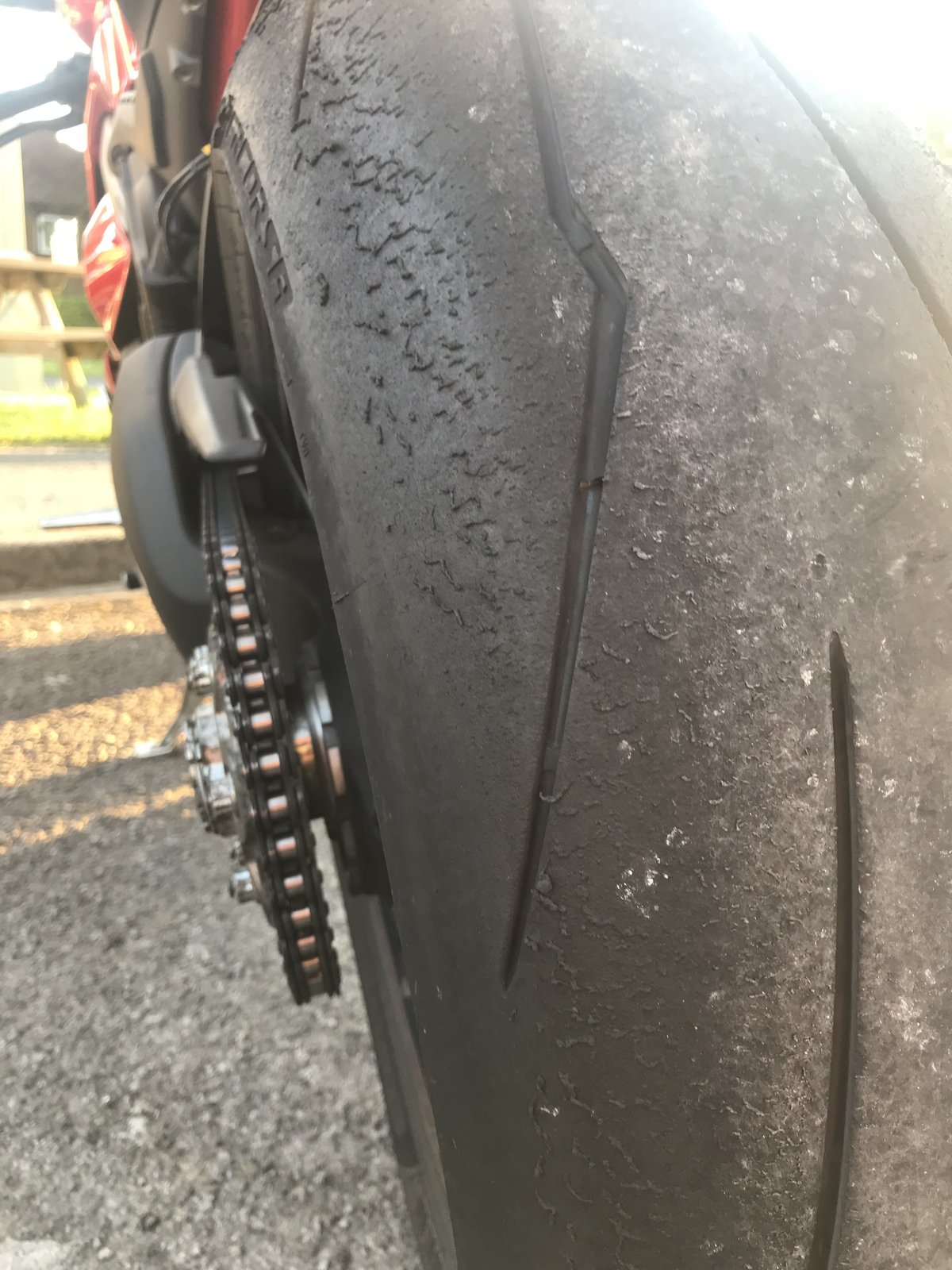

  1. FFF304A9-E45B-4087-81B6-791C79345BFA.jpeg Hi all,
    What tyre pressures are recommended?
    I’ve dropped mine to 30 & 30, I’ve got a bit of blistering on the rear whilst running in:yum (not hard use) :p
  2. 30 is too low on the front, it should be at least 32. We're running 35psi on the new Metzeller and Pirelli front tyres on track this year. For the rear it depends how hard you are going, for normal street hooning it's about right. It's difficult to see from your picture if there's any hot or cold tearing but if there is it's not too bad, but maybe starting to tear and may get worse if you start to use more revs. The way to check is to carry a mini tyre gauge and check the pressures are staying consistent. If they are going up after hard use then you need to let some air out.
  3. Hmmm ok, little different to what I was using on the 1299. I didn’t say but it 30 & 30 cold pressure I’m using.

  4. I'm no expert nor a gifted amateur but that looks like hot tear to me so you need a pound or 2 more pressure in that tyre. Andy

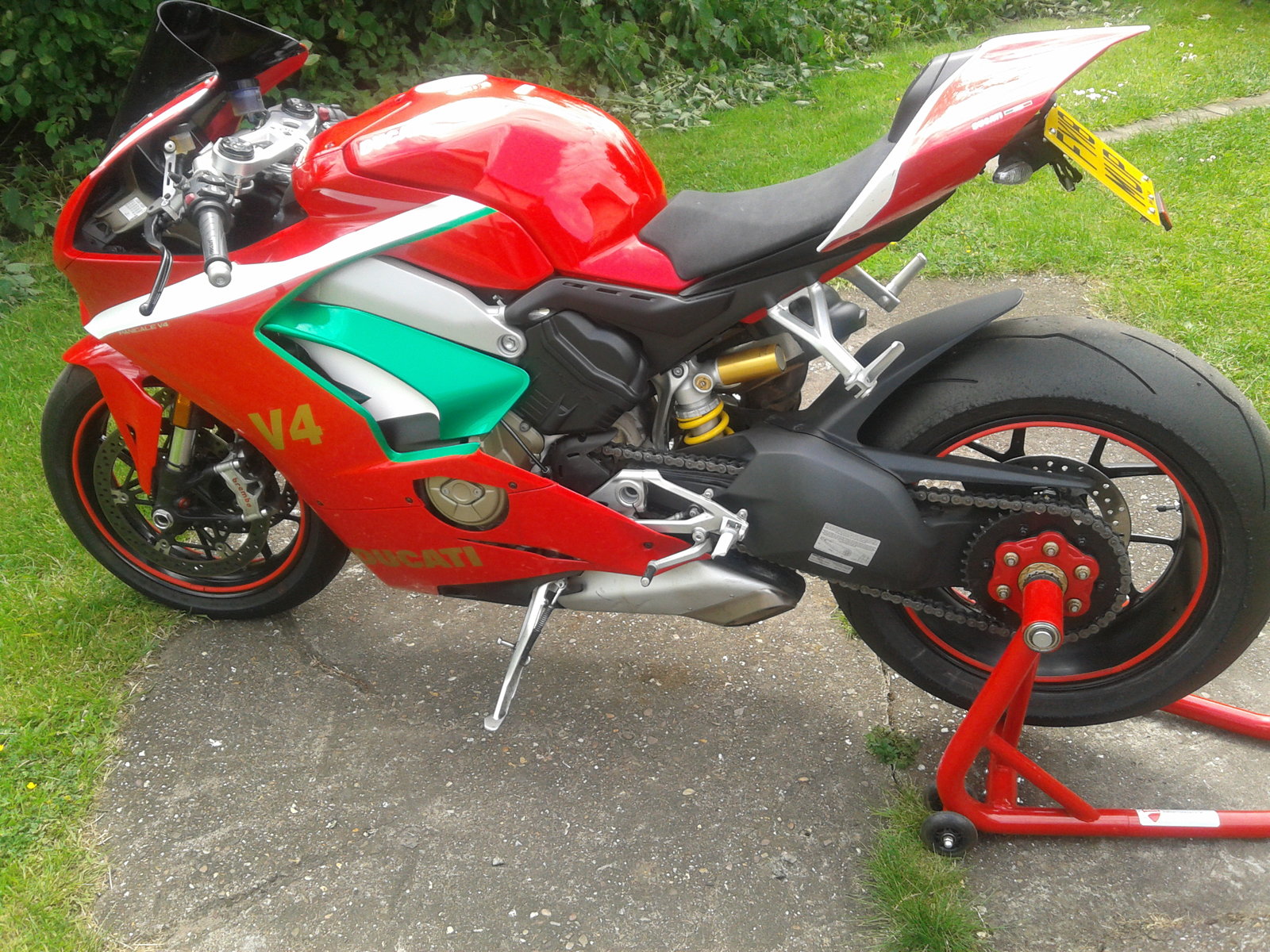

  11. I have dun 2 track days on mine snett & silverstone & found 26/27 hot on the rear works well & I was told 30 in the front hot but found it was not getting hot enough so after playing around found 34 hot works well so very much like ur pressures, I have also geared mine down front & rear & found it much better & I found a surplier that didn't rip me off on the price , ru doing donnington 5th july its a ducati only day 20180614_140008.jpg
  12. u need to get some chain lube on it chillo lol

    So 32 in the front cold is pretty much spot on as i checked it after a hoon and it was 36 hot :)
    For the rear 30 cold had it up to 36 hot, I dropped it to 28 cold and had 34 hot, still to high. So I’m going to try dropping a few more psi down to 24 cold and hopefully that will work out at 27ish. Obviously Road needs to bit of a compromise though.
