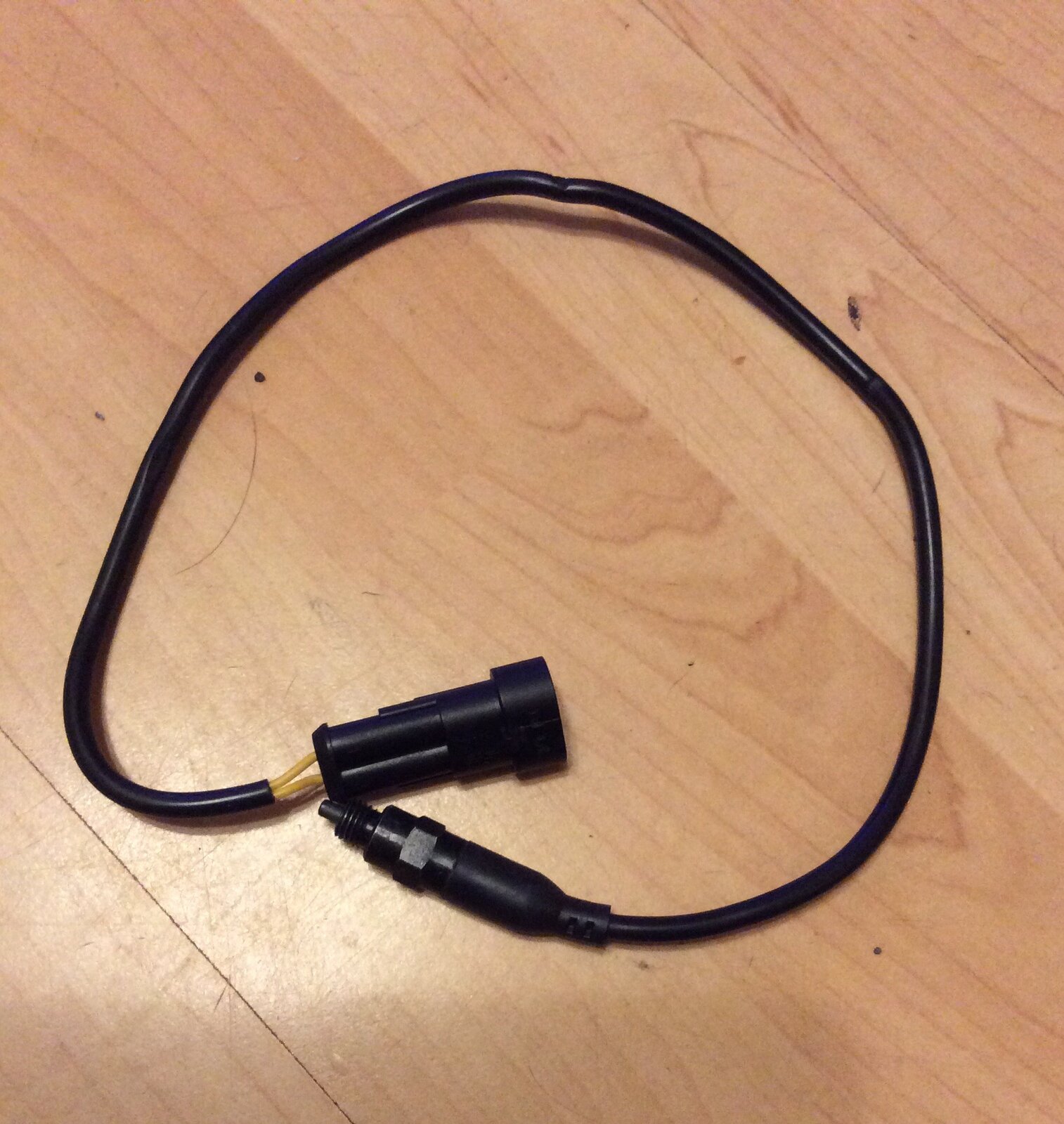

It will be one of these, https://kojaycat.co.uk/epages/95000...tPath=/Shops/950000457/Products/DUC-19JST-SET but sure if you search kojaycat, you will find a smaller quantity. Andy
Scrub that, just remembered, this is the rear brake switch removed from my V4 to fit Spider rear sets. Andy
