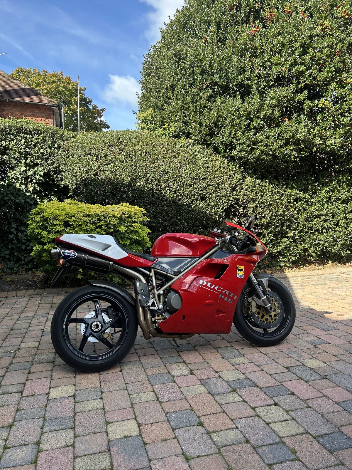

  12. Beautiful lines, credit is due to the gardener for an excellent display of topiary… if only you could move that bloody bike so we could get a better look!
  13. Nice foliage. Like the driveway too.

  16. Pity it's obscured by beautiful motorcycle!
