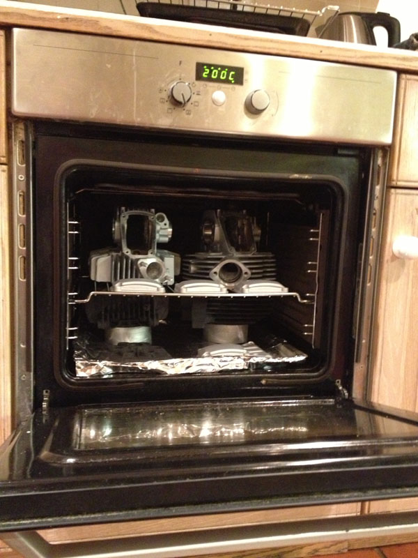

    I did this chap
    Heads 8 - Done by Lindsay fae Angus, on Flickr
    in VHT and baked in the oven (when it was bare - obvs :smile:). Am very happy with the finish.

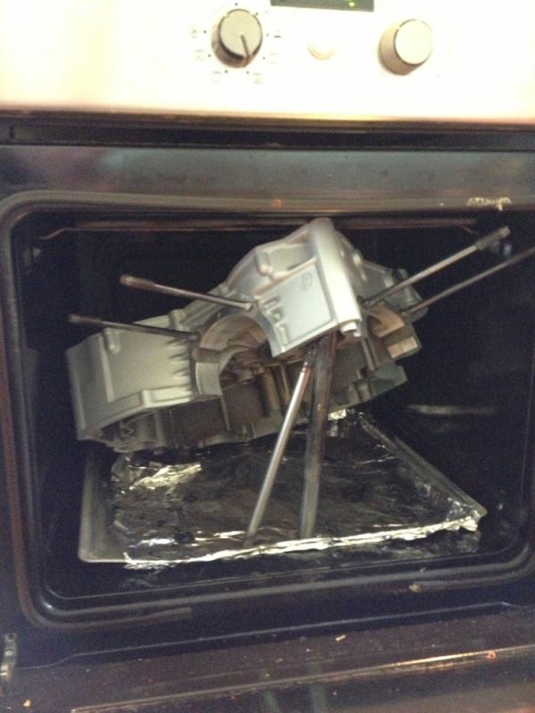

  16. OK so I baked them at 80c for 1 hour, let cool and then 160c for 2 hours, the powder-on-your-fingers thing seems to have stopped so hopefully it'll be good.
    Could just fit each side in the oven on the diagonal;
  17. More haute cuisine;
    Nigella eat your heart out... :biggrin:
