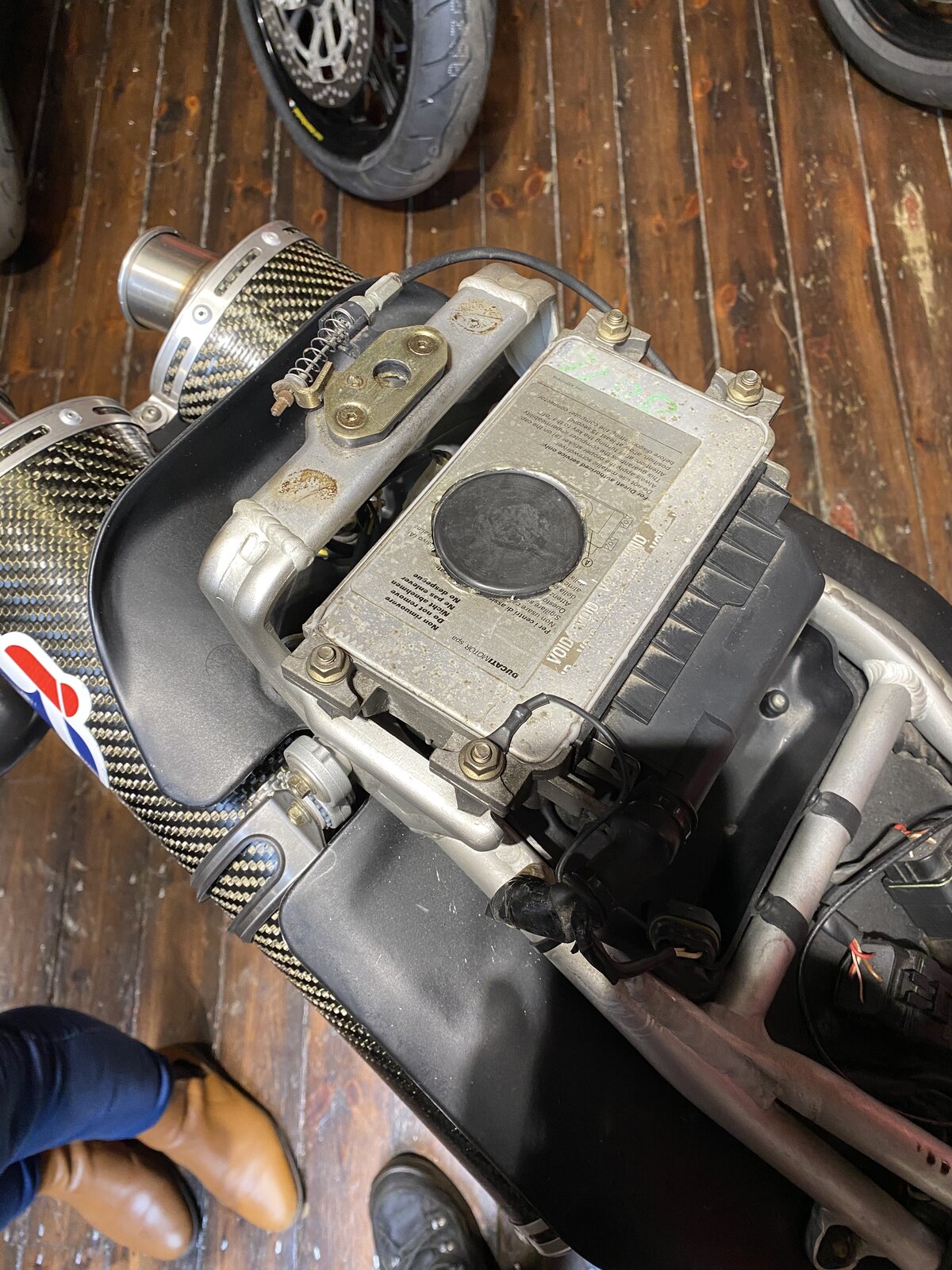

  1. After spotting the 748R for sale last week this morning I traveled the 200 miles to have a look. On first impressions the bike looked super, after the initial excitement I set to work spending time looking over the bike for any potential problems. I think although only having covered 6500 miles you can easily forget that these bikes are 20 years old, the problems I found included flakey silver engine paint, cracked temp gauge, small crack on the underneath of the mirror arm and finally something going on with the under seat ECU? The bike has had a carbon termi exhaust fitted, I wasn’t sure if this is anything to do with the sticker and grommet being removed from the top of this ECU ( pic attached )?? Just asking if all of these sound normal issues on these bikes and if they can be sorted later? Obviously I will be using these to haggle the asking price down!
  2. The grommet has to come out to fit the eeprom in the ECU for the Termis. This wrecks the sticker. By not replacing the sticker there can be water ingress into the ECU. The stickers can be picked up on eBay.

  3. Looks a little unloved from that picture.
    Tool roll is missing.
    What Chris said above. If water has got in then that’s a problem.
  4. Yeah I think the ecu is looking a bit rough to some of the other parts you can see in that picture IMO plus cracked temperature gauge hmm

  8. Paint flaking is normal, temp gauge cracking is normal, sticker missing on ECU is normal when EPROM gets changed.

  9. Never had a sticker on my 748 for years - no problem with water ingress.

  10. did you use it much in the wet though R? - if you were lucky/big grommet was nice and greasy or a really good fit then I guess you could get away with it. Each to their own, but for a bit of sticky tape, it's not worth the risk for me, had one fail after a torrential journey from picking up at Manchester.

  18. Walk away, now ! Your picture is not showing the correct mono subframe, it’s a bodge. Andy
  19. What is incorrect with the subframe? Sorry for all the questions but it’s good to know when viewing bikes
