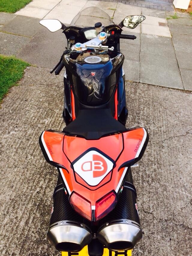

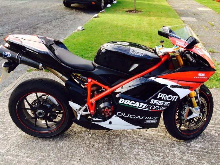

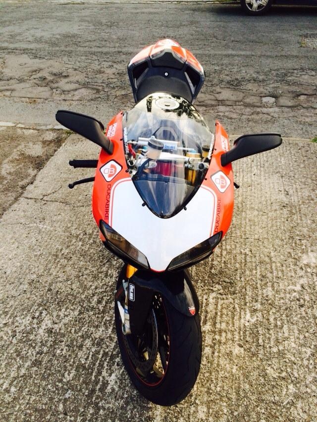

  10. image.jpg image.jpg image.jpg This is all vinyl, fraction of the cost of a paint job and removeable

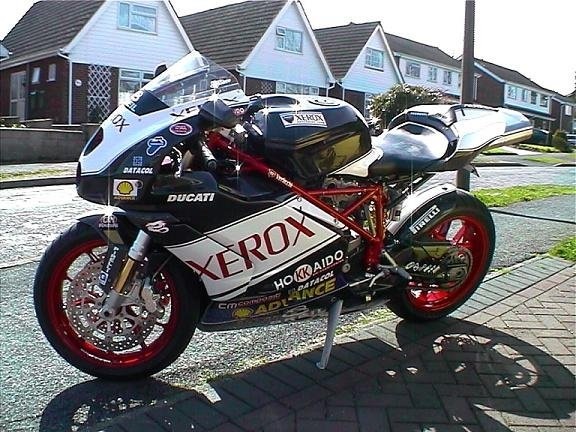

    Had a full Xerox rep done on my carbon 749s. Cost £150 ish. Easy to remove, a quick polish and everything back to plain carbon.
    Not the best pic, but, trust me it looked great.
    All decals applied in one piece, with no joints, the white wrap around the back of the tank was done in one piece and was a work of art.
    Supplied and fitted by The Image Works, near Ilkeston just off J26 M1.
