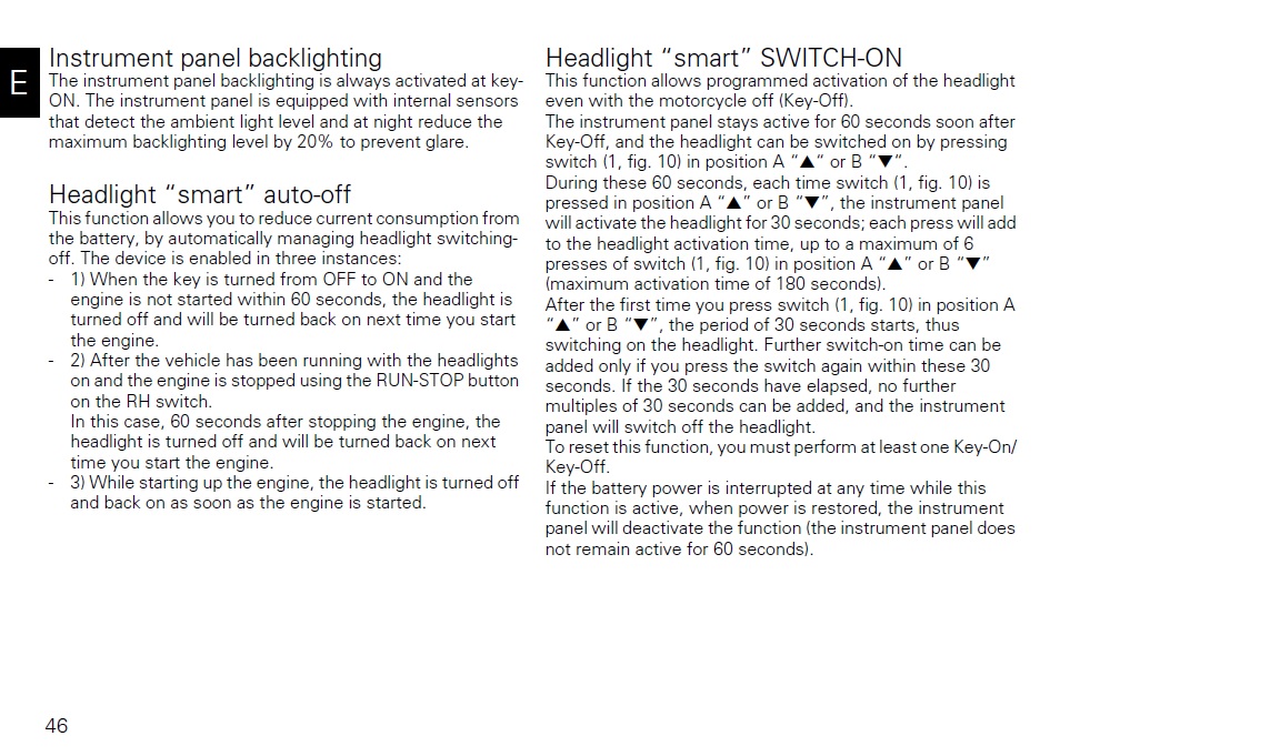

  10. Does your bike have auto lights on though? If you wait until they go off a minute or so after you turn ignition on them it could pick up to 12.5 volts or more. If this is the case, then it's a better indication of the standing battery voltage.
  11. Chris - the lights do come on with the ignition, don't actually know if they go off after a minute. I'll have a look in the morning.
    This is how the headlights work
