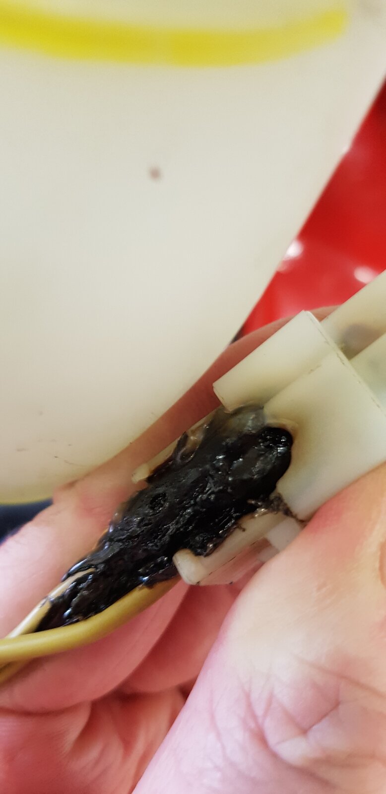

  8. as above Gary, might be worth considering a Mosfet type Reg at the same time. Many threads on here outlining similar problems which often start with associated wires and the two connectors (reg and alternator) rising in resistance due to light corrosion resulting in same overheating.
    https://www.ducatiforum.co.uk/threads/yet-another-reg-rectifier.13136/
