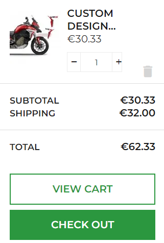

  16. Old thread resurrection ...
    Has anyone tried ordering from Vulturebike recently .. a couple of V4S side panel stickers about £30 seems OK - but the cost of shipping !!!
    Seems crazy.
    Conquest racing don't appear to supply them any more.
    Any other options ?
    Thanks.
  17. Their shipping has always been ridiculously expensive. Sometimes their stuff is on eBay with cheaper delivery costs.
  18. I ordered some at the end of last year and just had to suck up the shipping cost :(. They probably could do with re-negotiating their courier costs as there are other Italian suppliers I’ve used whos shipping costs are 1/2 of Vulturebike.
    Be aware you’ll get charged VAt when it arrives if you’re UK based so make sure the price you pay them is ex Italian vat (unless they have the facility to charge you UK vat and remit it to HMRC).
