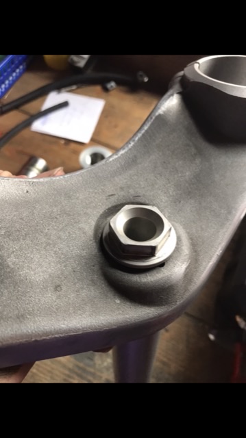

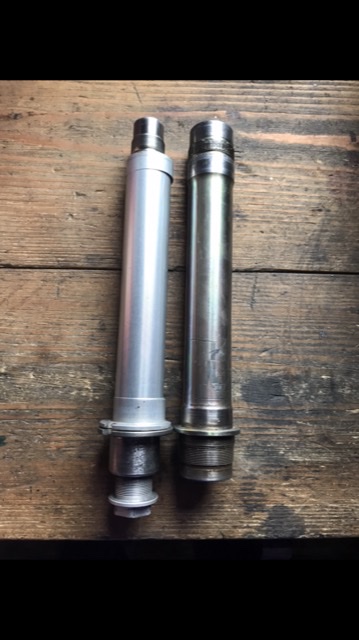

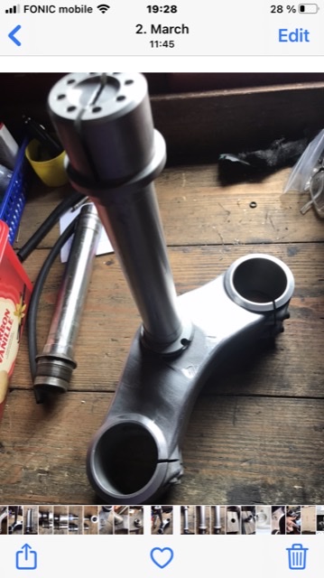

    I’ve had a few done in the past. Saves on the expense of the 56mm items as they command a premium. The last one I had done was from a 748. Cost me £15 for the yoke and £35 for the machining.

  6. The last one I had milled out I adapted it to have an adjustable offset a’la 749r
    197ECAC8-8B6C-456C-B9AC-9283463211C8.jpg CC91FFED-EAD6-4692-BCDA-B1C24139B099.jpg D3CAA251-C02A-402E-BF56-B76E82FA8AEF.jpg
  7. Very nice. Wasn’t sure if it was doable but this gives me some reassurance. Cheers for that
