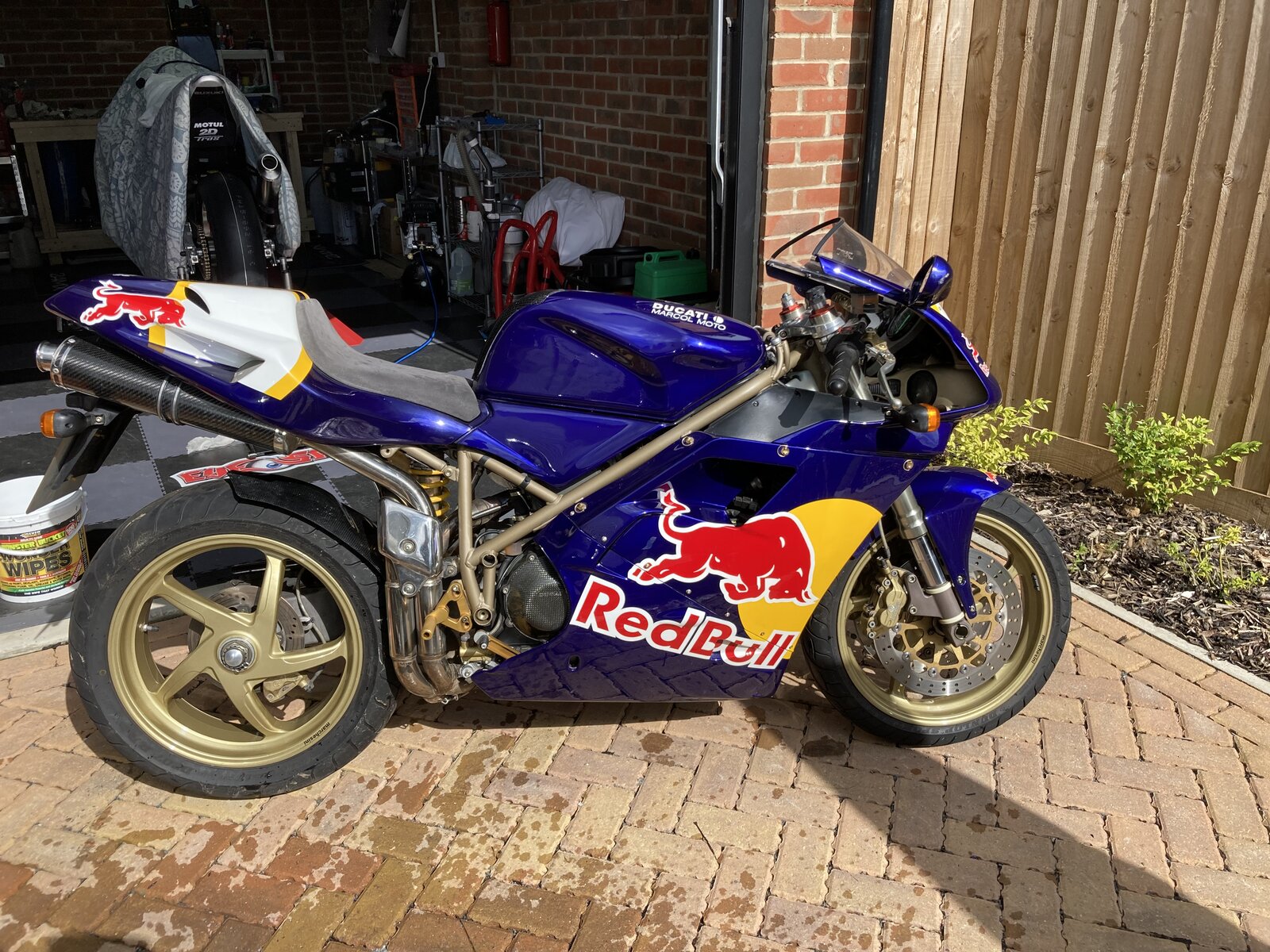

  1. AC68876C-1148-4B54-B5A0-C29452F05EDF.jpeg Got my hands on a Marcol Moto Reve Racing Ducati…
    A 748 with top yoke numbered 8….I am not sure but I think it might be the only 748 version in 20 as the rest were 996…Maybe someone can help me with this?
    It has not turned a wheel in 17 years so I need recommission it but that has started already.
    Washed it, stripped body work and tank, removed fuel pump, airbox and turned the engine over by hand.
    Hoping to get lots of guidance from you all as this is my first Ducati
    Thank you
    Nikolai

  2. First thing to do is to get it to run…
    New belts
    Plugs
    Oil & filters
    Valve clearances
    Then assuming that all works do all the seals and perished items and make it look very pretty again.
    I have to say that they are so easy to work on
