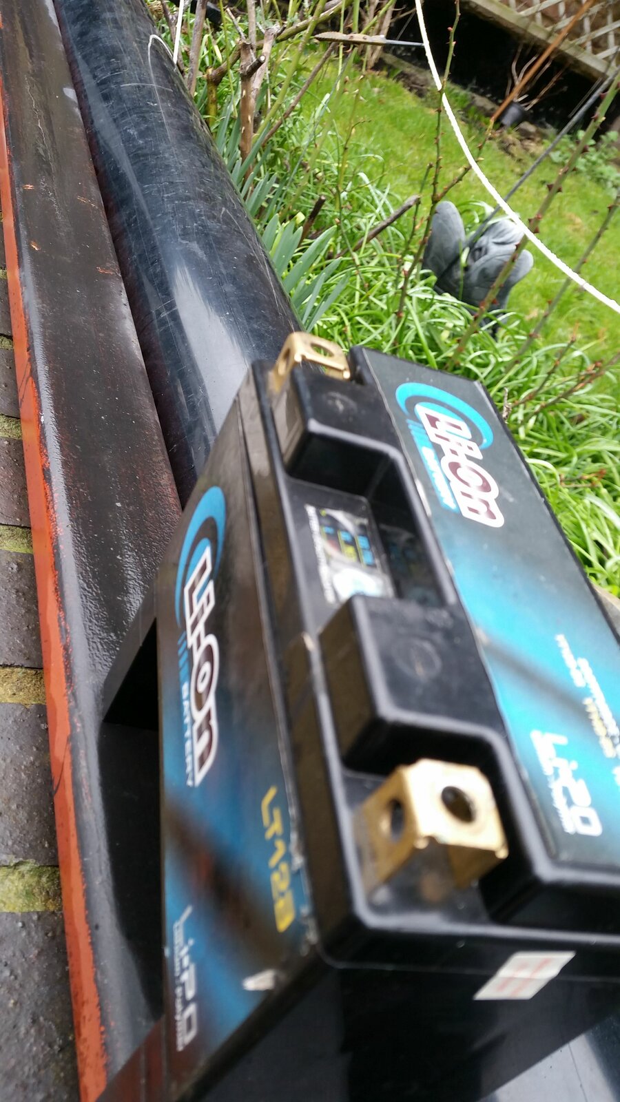

  1. Just removed a dead Lithium battery from a 1098R and sent it back to its owner (so I can no longer do any further tests).
    Looks like it got pretty hot.... enough to melt the case of the Lipo battery.
    Apologies for the poor picture, as you can see the middle of the case is swollen.
    Stu when you get the bike can you also advise if there is any signs of over heating on the stator (especially this) and/or rectifier/regulator set.
    Battery voltage upon arrival was 0.0003Vdc on a Bench Fluke multimeter.
    Added a 12V battery in parallel, via 20 Watt 12 Ohm resistors, minimal (micro) current to start with, left it three days. Eventually got to 5.91Vdc, so this suggests that some of the cells are faulty.
    For comment or discussion.

    I've not done any active checks and the bike is now on it's way.
    It appears that the LiPo battery has severely over heated, since I put on a AGM battery and that started the bike this morning (after 5 days?) I'd suggest that it wasn't drain that caused the battery to overheat, but instead charging. More than likely the 1098R own "generator set".

  13. As soon as we get Ash to answer the tender question we can state that this make/model of battery was unsuitable for this actual bike, as configured for the track.
    The battery may have behaved differently if all the normal electrics / loads where present, but I wouldn't guarantee that the same would not have happened anyway.
    The battery melted.... and once the new owner opens the battery (it's in the bag, make sure you unload it off the van), we will be able to see what happened in this particular incident.
