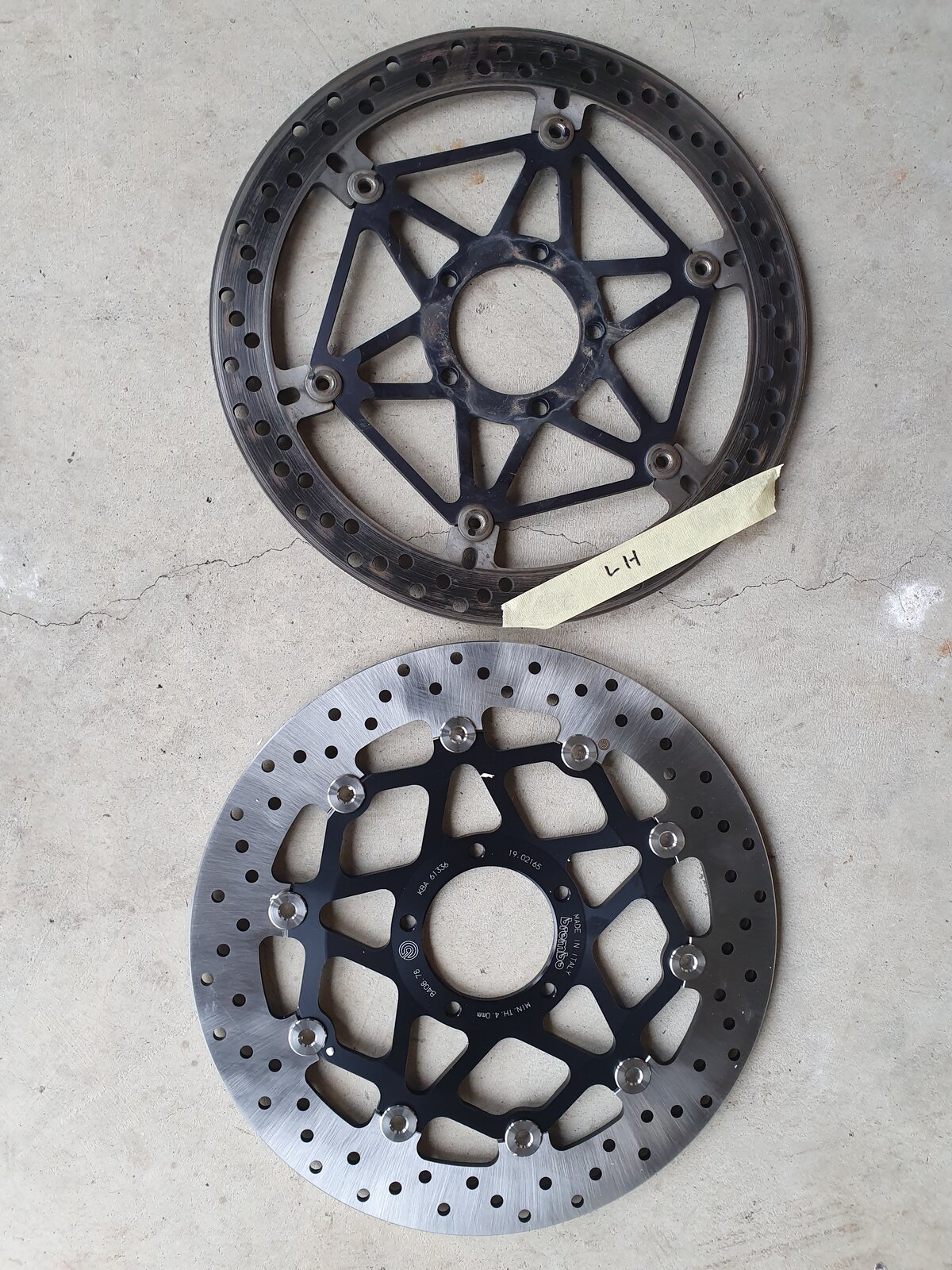

  15. The OEM Ducati Brembo discs are built to a price point. When comparing to the Series 1 Brembo replacement you can clearly see the considerable difference in metal to absorb heat.
    Best upgrade ever.
