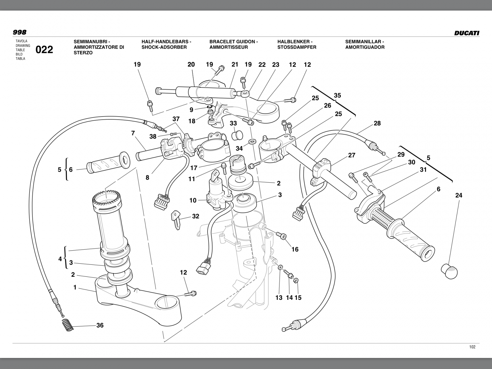

    Think I might be missing washer No. 34. The one that goes under the steering damper to frame mount. Would anybody know the thickness of that washer?
    Thanks, Ian

  2. It's a shallow top hat spacer. Just in there to stand the rod end off the mount. You can use a m6 Spring washer if you're stuck. Quite are few have been misplaced over the years and it doesn't seem to make much of a difference to the operation.
  3. Brilliant. Thanks a lot Neil. Would you know if it's the same top hat spacer as used on the subframe undertray, by any chance? I've got a few of those ones spare.
    Cheers, ian
  4. I have just used an ordinary washer in the past with no problem, which is what I though number 34 was. The top hat washer is number 18 and goes in the steering damper swivel mount.
