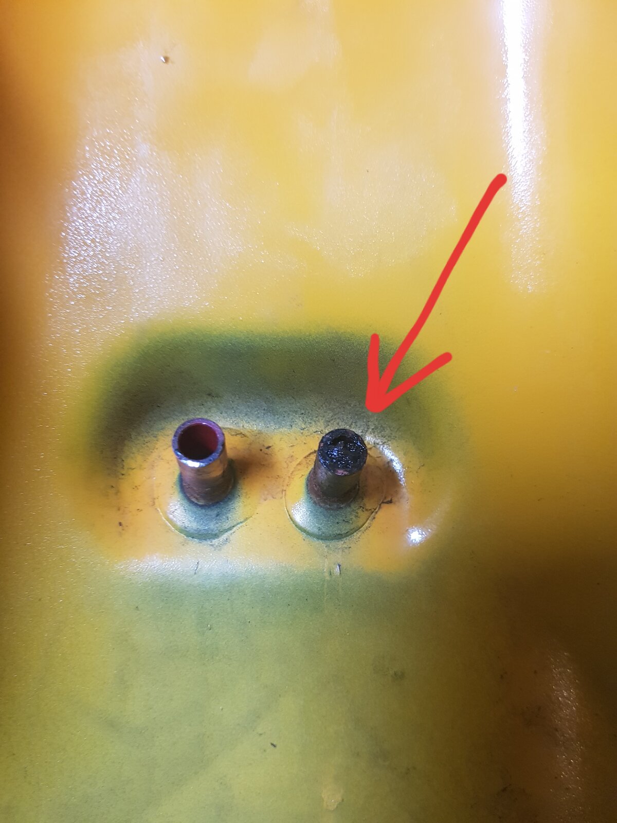

    With the tank off I noticed two things, first one of the drainage holes was totally gunked up 20210223_133316.jpg

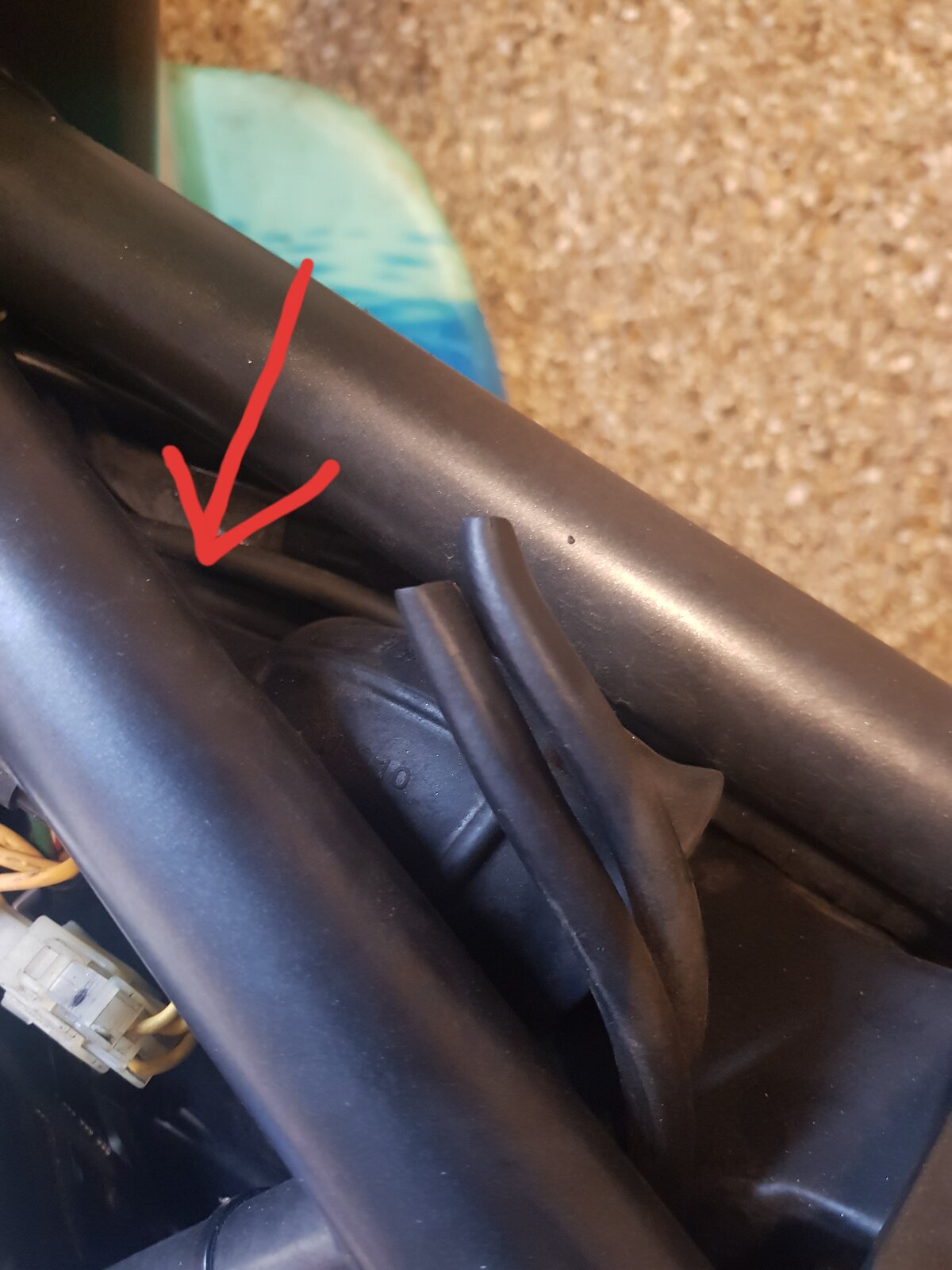

    I trimmed the pipes and diverted them closer to the top yoke behind the air intake, which is logical really seen as how the drainage holes in the tank point in that direction and not straight down: 20210223_133239.jpg

  2. One of the tubes is a breather, the other the filler drain. It would make more sense to at least take the rain straight down so that any water drains straight out and there is no trap that could silt up and lead to a blockage.
  3. Agreed
    But the metal tube ends that stick out of the bottom of the tank dont pint down, they point toward the front of the bike, hence the re-routing of the rubber hoses
  4. They may indeed point forwards but that's no reason to take the pipes upward, they could go forward and down. Taking the drain hose upwards so that water remains in the lower section be just plain daft. But suit yourself.
  5. I think theres been crossed wires here, the pipes dont go upwards in their new position. I've moved them forward so they dont kink, but they dont go upwards.
    Should have been clearer, sorry
  6. Yes perhaps we might be. I have a Classic too and I've always ensured that the hoses take their most downward route past in front of the alternator casing. I guess that by trim you have removed an excess at the top that was causing them to kink upwards. There is actually no need to trim them if you pay attention to the routing and pull any excess downwards to the bottom.
