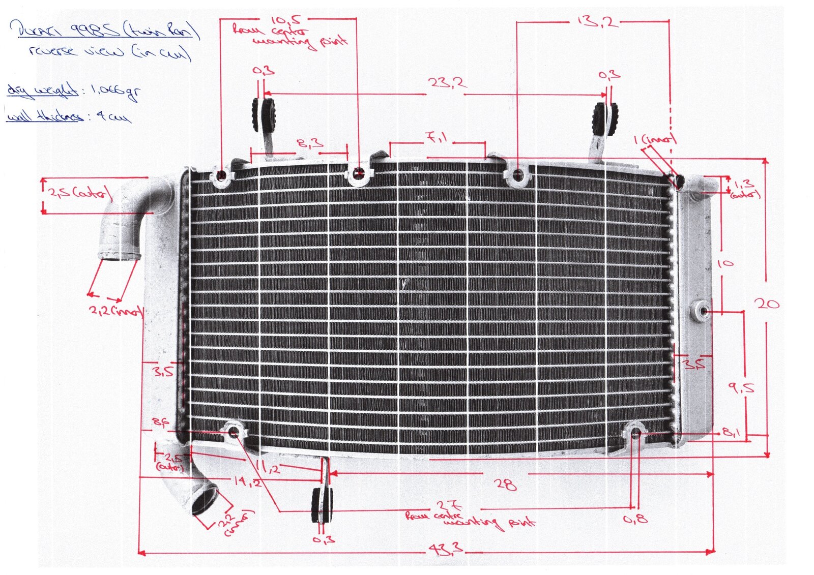

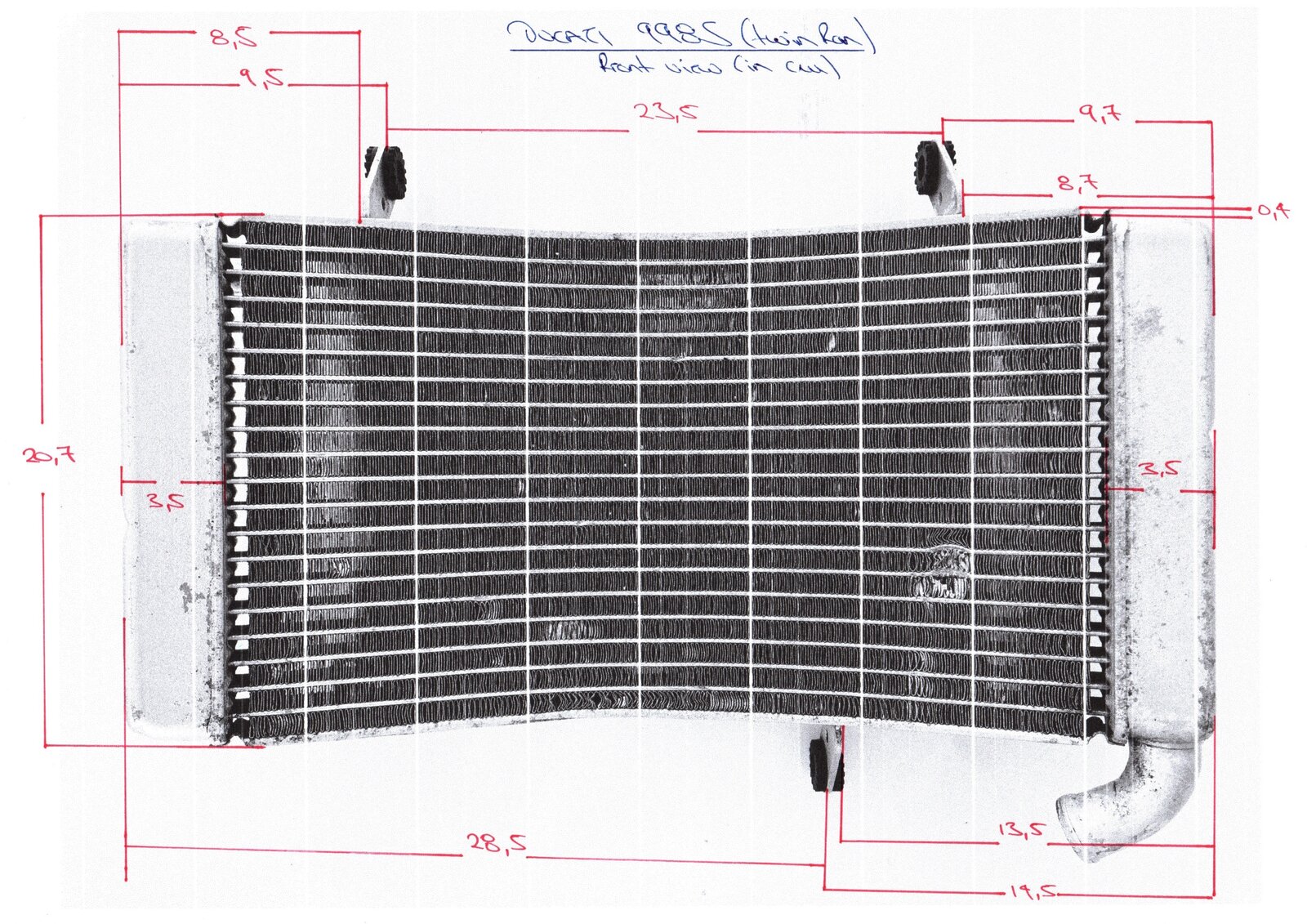

    With the radiator dismounted for cleaning, thought it was a good time to take, and pencil down, some measurements, as some folks may find them useful. All length measurements are in centimetres, and weight measurements in grams. I apologise in advance for the prescription style hand writing.
