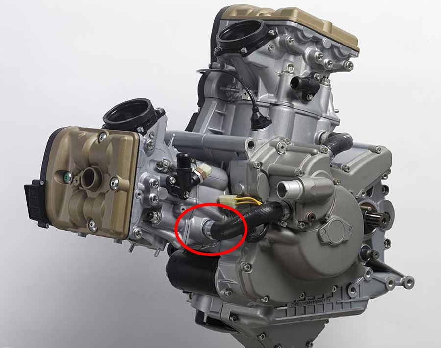

  1. Having recently changed the 1098R's hoses to Samco items, and filled the system with Evans waterless coolant, I took the bike for it's 1st run of the year last weekend.
    I did about 80 miles and with a little sitting in traffic, I saw the temperature gauge reach into the 90's at some points. Whilst moving along it was around 65ish.
    Upon returning home I noticed a little bit of red liquid on the fairing and a small drip under the bike. I immediately knew it was the coolant and thought I must have to nip a jubilee clip a little more. Embarrassingly I found I had managed to fit a jubilee clip on the engine behind the battery box to the union and totally miss the hose. :oops: The hose was basically just pushed onto the union. I was able to pull it off (which I didn't do as I didn't fancy coolant everywhere).
    After fitting the hose correctly I found I had lost about 20ml of coolant from the system after 80 miles. I was a fan of waterless coolant before, but the lack of pressure saved me an embarrassing breakdown. :upyeah:
    And before anybody states the obvious, yes I know I'm a bell end. :Shamefullyembarrased:
