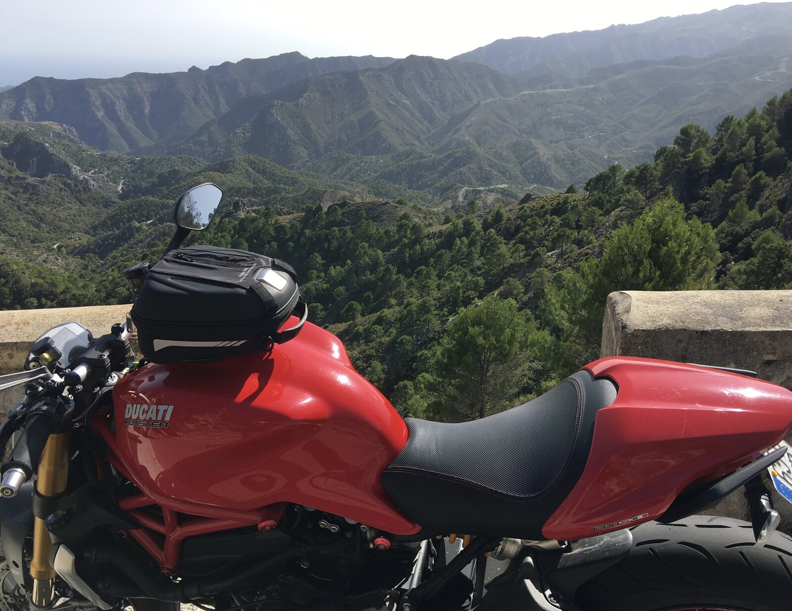

  1. A couple of days ago I went to start the Monster. It didn’t fire up first time, which is a first since I put a new battery in about a year ago. It’s had several good long run outs lately so there should be plenty of charge. It was turned over slightly lazily and took about 6 attempts before firing up and running properly.
    It rode fine and fired up fine after gassing up and the first coffee stop. Then after we stopped to admire a view the starter button was totally dead. Absolutely nothing, not even a whisper on the button. We were a couple of thousand feet high at the time so a bump start in 3rd was no problem and neither was the return ride. I made sure to keep it running, everything went perfectly.
