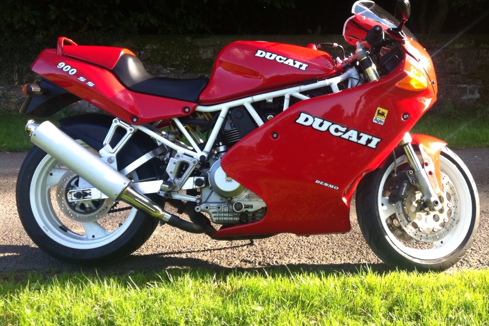

  1. Thought I’d start a thread re what’s the worst failure you’ve experienced with your 900ss, I have a 1991 carby, so far (had it a couple of years done around 7k miles on it) all I’ve had is a rear indicator bulb holder disintigrate and a high tickover suddenly appear, not sure what fixed the tickover because I did several things at the same time such as oil cables/choke mechanism, sprayed inside carbs with cleaner etc, anyway it went away, the rear bulb holder (silver reflector bit) is still lashed up with a rubber band, really must get a replacement:),so mines been good so far, how has yours been?
