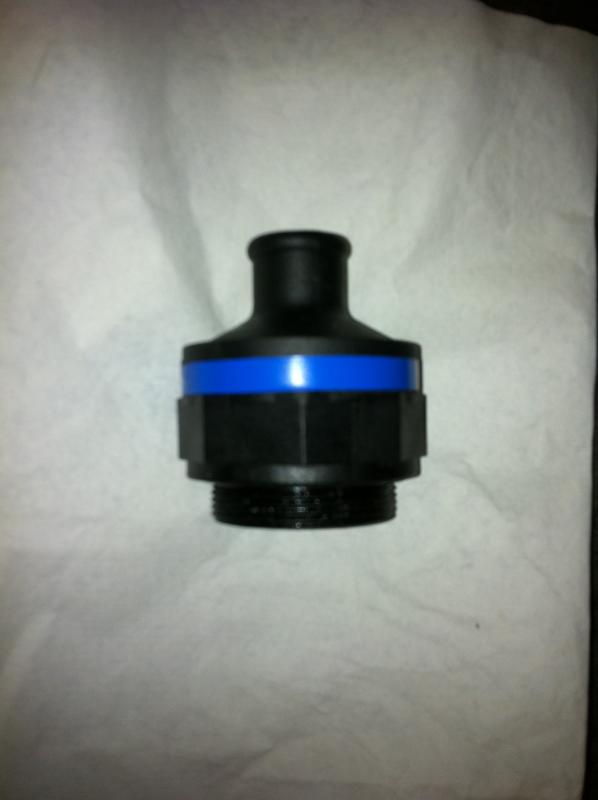

  1. I've got an stm anodised engine breather. Its just straight through in the center, about 20mm.
    Why would this be better,if at all over the standard breather?

  3. If it's a straight-through breather then it's designed for use with a larger (usually underseat) breather/catch tank and a reed valve in the airbox. This setup is/was used on race bikes to give less crankcase pressure, by effectively increasing the crankcase volume and the larger tank helps prevent oil getting into the airbox under extreme conditions, it can also hold the engine oil (prevent it escaping all over the rear of the bike/track) in the event of it being 'puked' out.
    Supposedly gives a couple of HP increase at higher revs too, but you need the complete setup to get any benefit and if you fit a reedless breather you should then fit a reed valve further up the system in the airbox.
    An open breather with K&N filter means you lose the effect of negative pressure from the airbox to the crankcases and you will likely get oil over your rear tyre...
