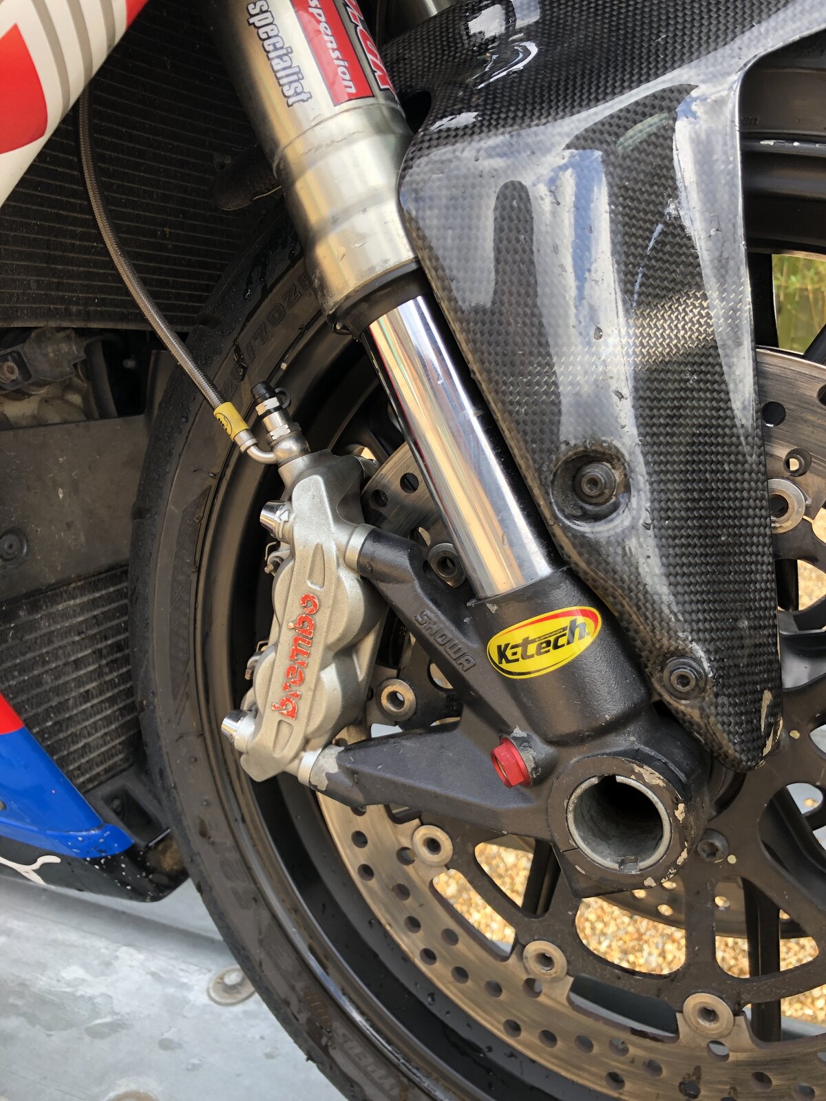

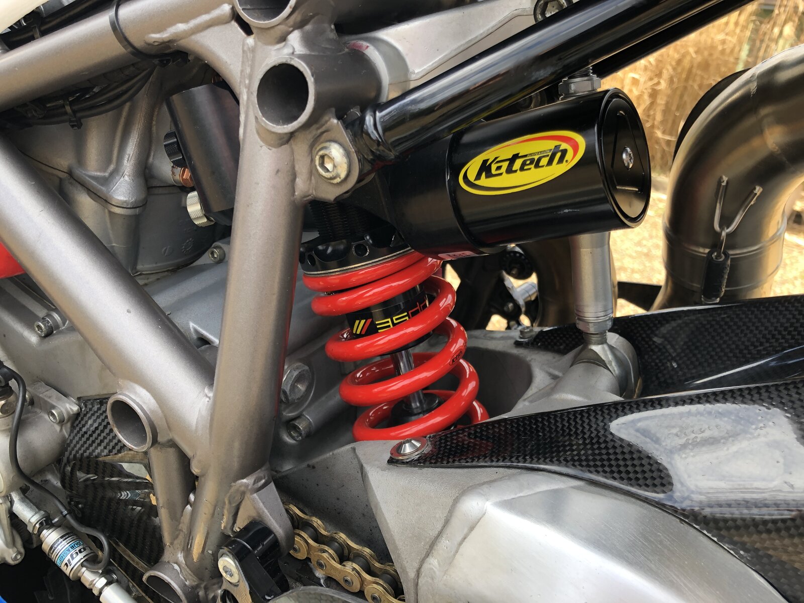

    It was great but felt a bit slow to turn. Taking sage advice (experienced friend rode it and said it was ‘like a plank’) I decided to get the suspension done. I’ve never had suspension set up for my weight and always wanted to try it. Spoke to the helpful guys at HM Racing and decided on fork service with new pistons, springs and a new shock.

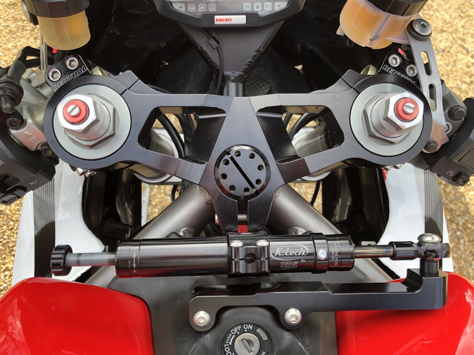

    That was the start of the slippery slope. I’d been somewhat unnerved by flapping bars over the rise after Surtees at Brands, so wanted a steering damper. But that’s not straightforward on the first 848s, there’s no thread in the headstock or mount on the frame (and I don’t like those ones that mount on the fork top). But if you spend enough time on the internet.. you can find and import a special bracket from the US and as luck would have it, get a suitable triple clamp right here via the forum - thanks Phil748.
    So with damper added to the order for KTech bits, that was the suspension sorted.

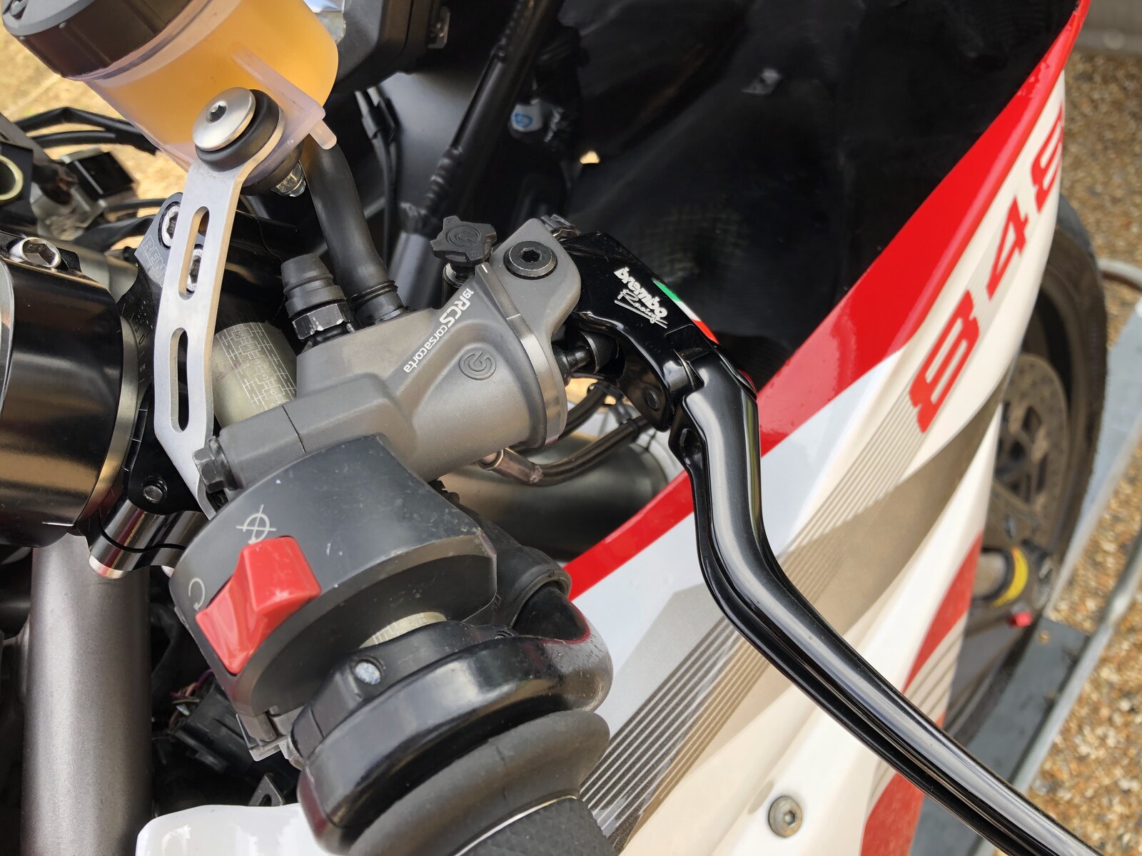

    The brakes had felt a little weak at the lever and another ‘encouraging’ friend said if you’re doing the suspension you should do the brakes. Best money you’ll ever spend. Friends are helpful aren’t they, particularly if they’re not paying. Conveniently HM had a Brembo RCS Corsa master cylinder in stock.

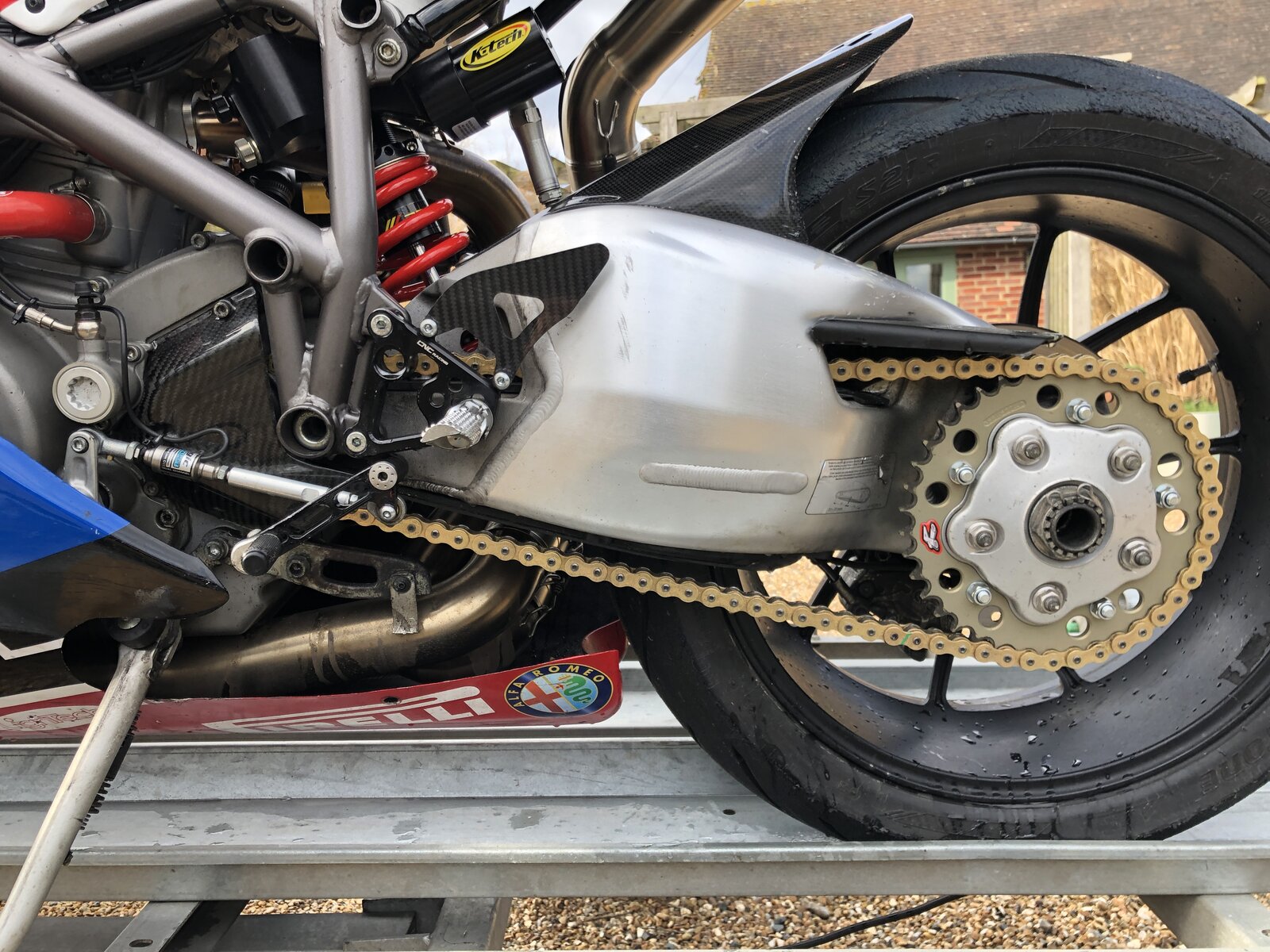

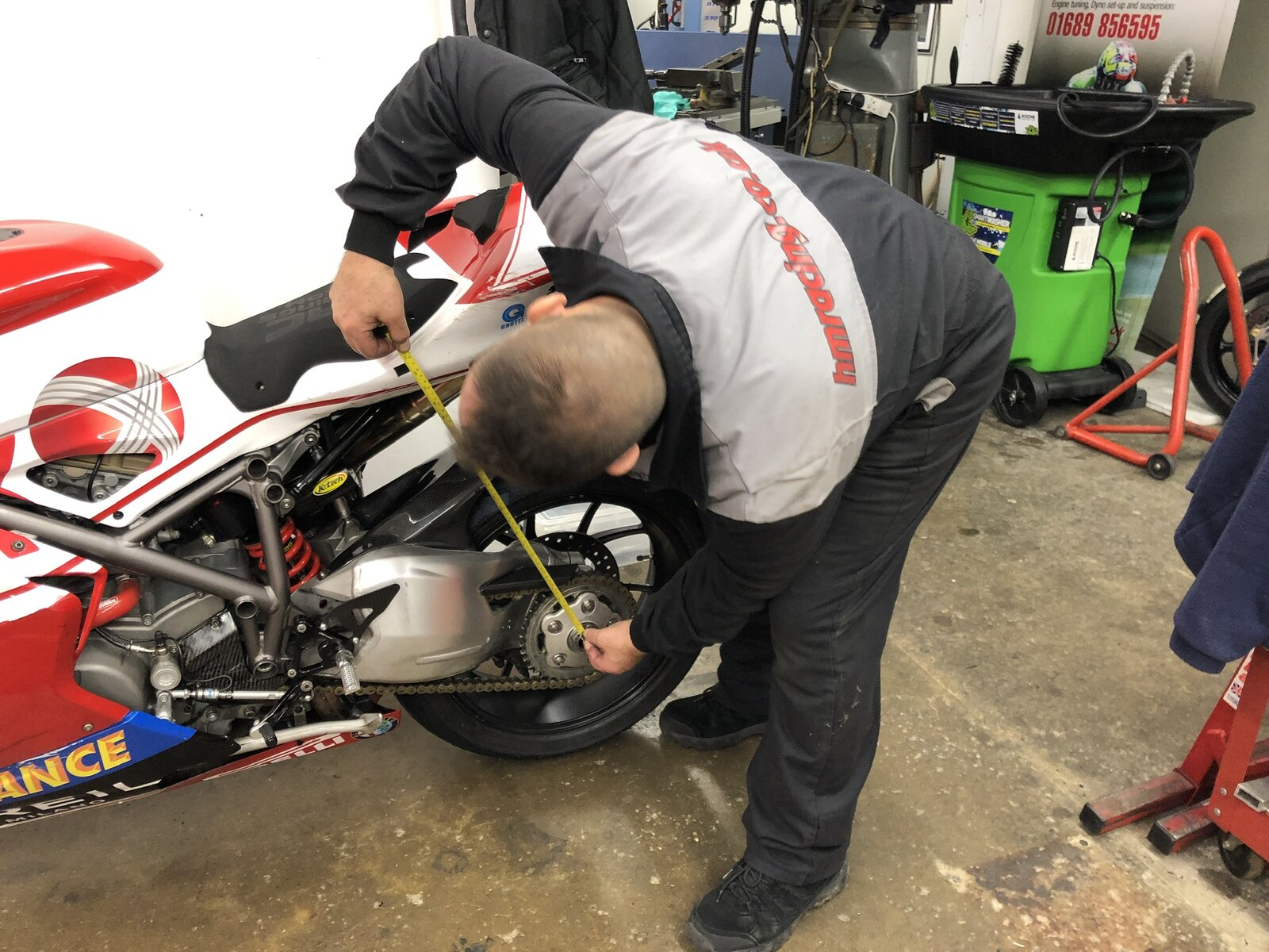

    Then, thinking I was done and chatting it over with my old boss who first got me into this sports bike caper, he asks if I am doing a 520 chain and dropping a tooth on the front and going one up on the back. Compared to everything else, once I got the quote it seemed like a bargain.

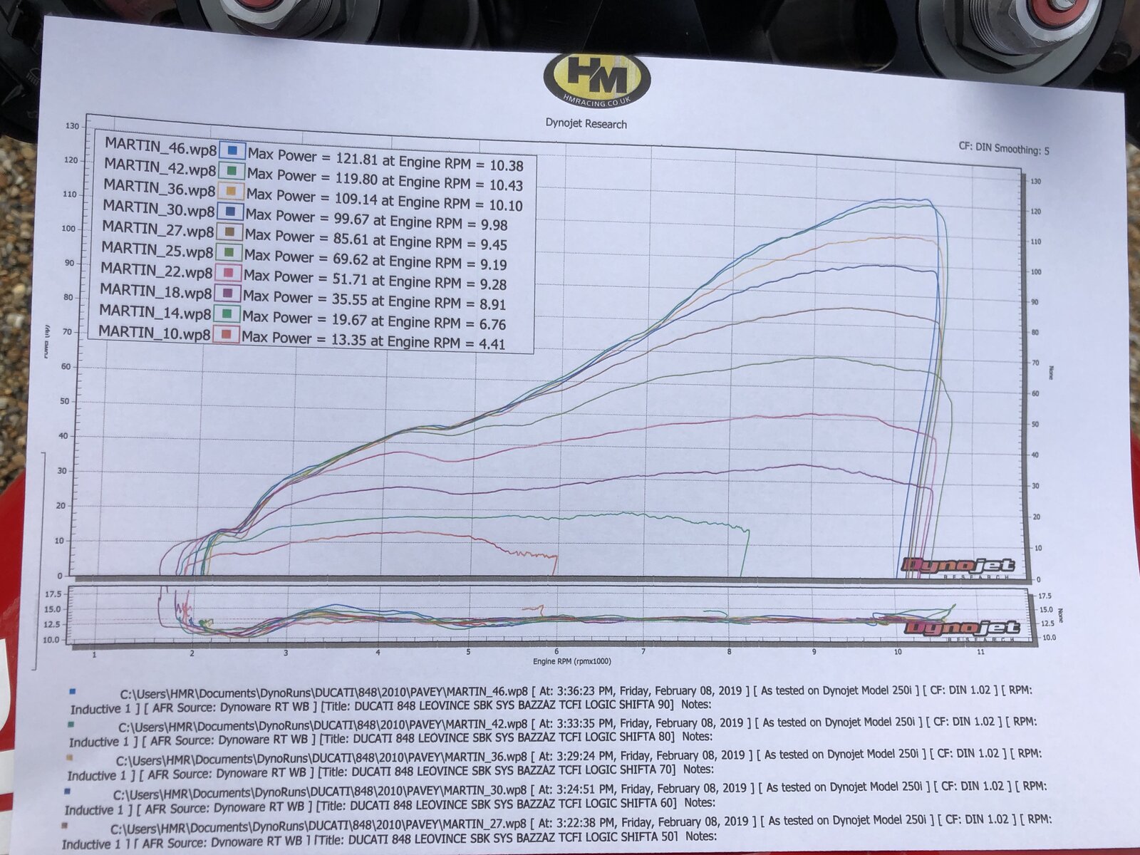

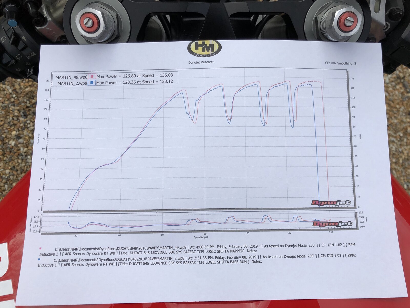

    If you’ve read this far you deserve to know the dyno numbers. With the standard ECU and full system it was 123bhp, with custom mapping on the Bazzaz it was 127bhp. Not too bothered about the numbers, it’s how everything comes together I’m looking forward to finding out. The sound is as you would imagine, joyous.

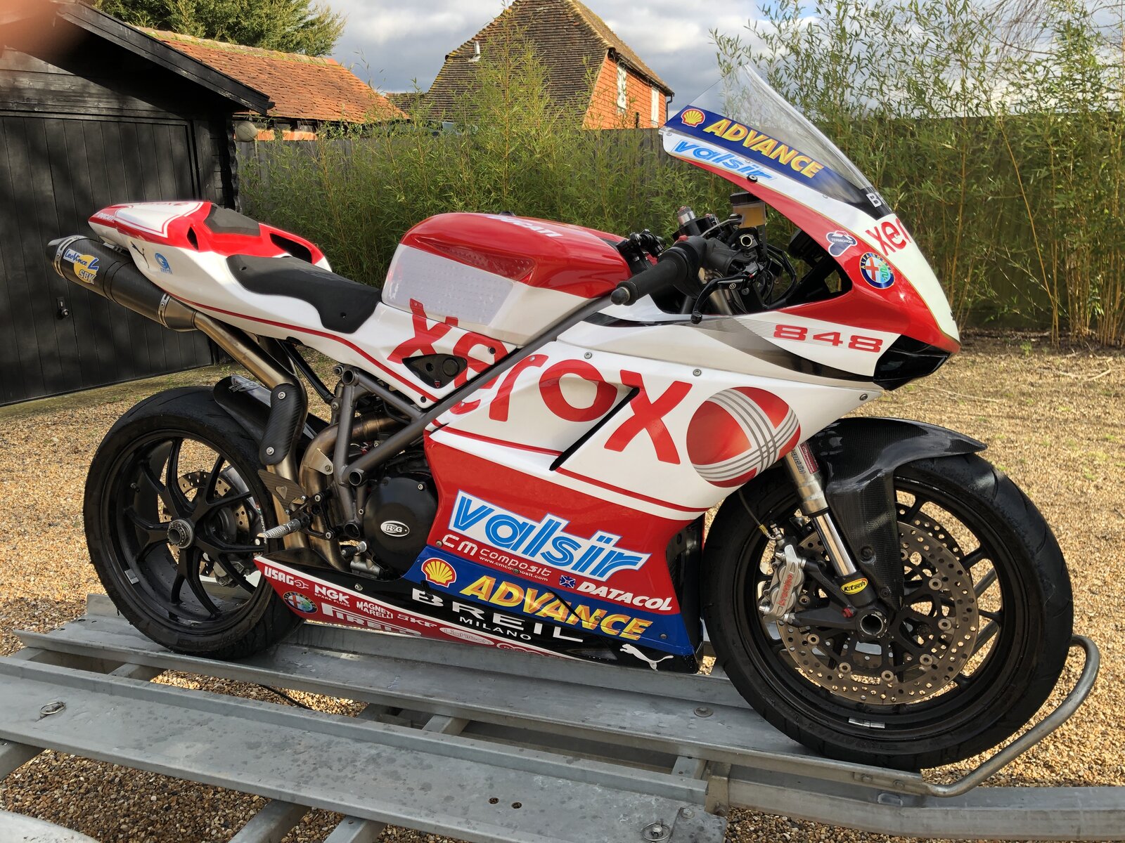

  2. Forgot the blingy pic!

  4. Some lovely looking graphs Pav.

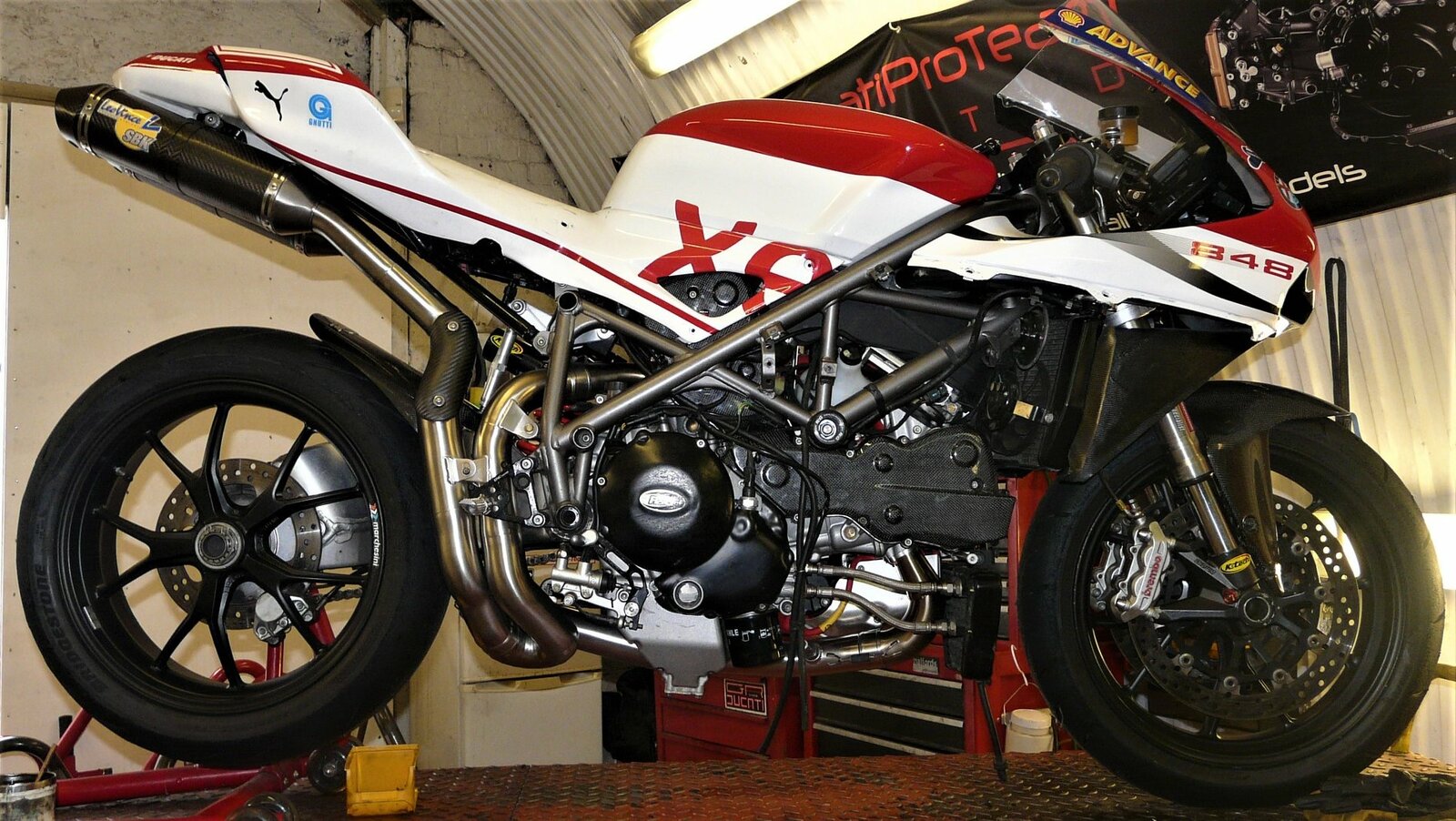

  7. Even the exhausts look in the right place in the middle
  8. Liking this bike!

  9. Wouldn't bother with carbon wheels myself. Very nice, but so easy to damage.
    M4 calipers would be a worthy upgrade.
  10. @Pavsta lovely looking bike!
    Are they CRC race fairings?
  11. Yeah sort the brakes I reckon, hpk calipers and T drive discs with zo4 pads?? :D
  12. Whats the RCS? 19 or 16?

  15. 19 RCS, can see it if you zoom in on the picture. I think 16 RCS is aimed at monodisc. I put one on the Ape a couple of months back. I pulled the trigger on a hydraulic to wire clutch conversion last week, being delivered today

  17. Just wondered as i couldnt picture the size of the pistons on those calipers...so, yeah definately a set of m4's or above...ive got hpk's on my z1000 and the braking is epic. Ive got the stock master cylinder but toying with an RCS...
  18. Yup - decent and affordable upgrade.

  19. Yep that’s them. Painted by Apache race paint.
