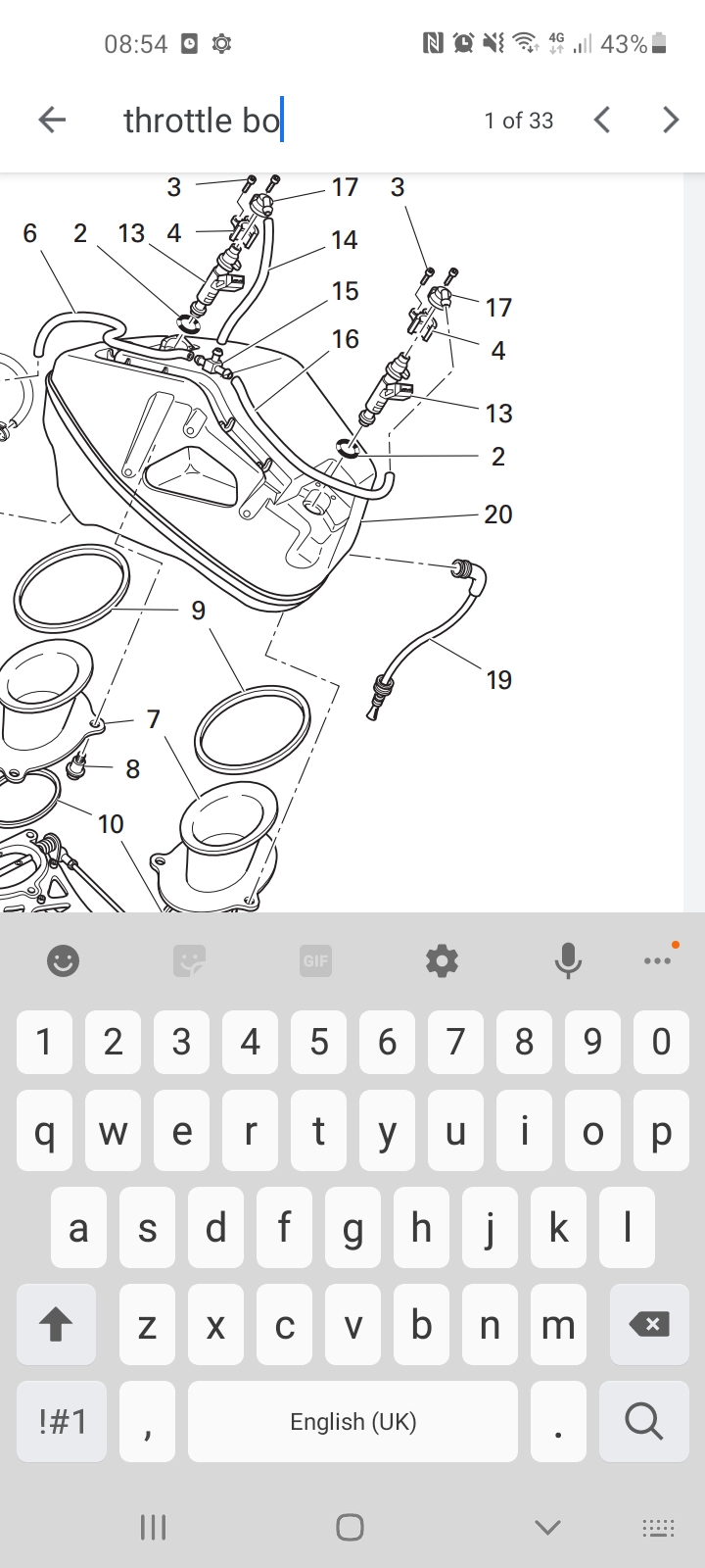

  1. *Pipe is number 19 on diagram*
    Hi All,
    Apologies if this seems like a daft question, bikes almost put back together but I can't for the life of me figure out where it's supposed to connect too? Tried watching a few videos that appear to show both cylinder heads connected to a valve then back to airbox? But still quite unsure. Any help would be appreciated.
    Thanks
    Dan
  2. It’s an air box vent/drain.
    It connects to the air box and the lower end with the flat lips vents to air.
