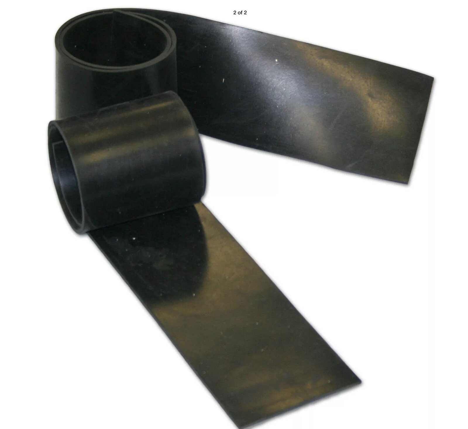

  5. Plenty of people selling neoprene rubber strip on Ebay - you can even buy a sample for 99p
    If there’s enough tolerance in the clamp then a 1.5mm thick piece would provide plenty of protection and not look too heath robinson.
