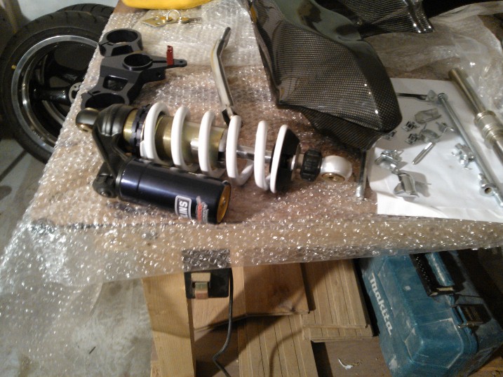

  11. that looks bloody lovely, very WP.
    Did you do the work yourself?
    did you get the body refinished?

  14. I sent it to Brooke suspension ( I thought them great to deal with but have since heard some bad reviews) and the have it a service, powder coated the spring and anodized the gas canister .. the rest I painted black myself.
