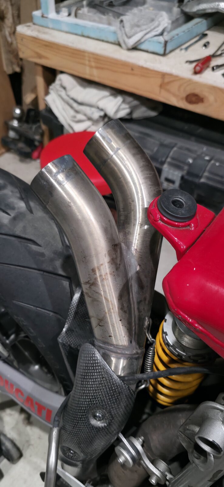

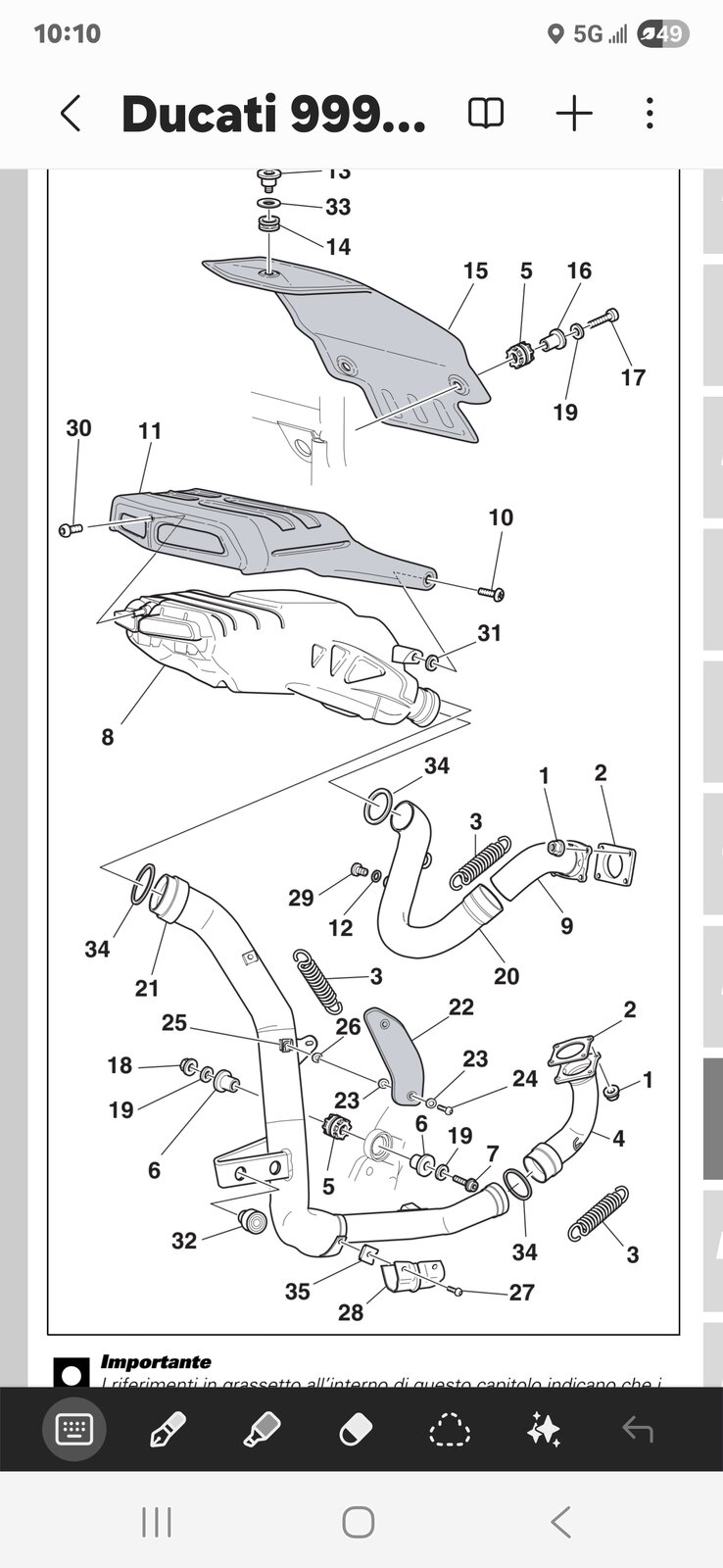

  1. Hello, i have a 03 999s with what I thought was factory exhaust system. After looking through the service manual, I see a different exhaust system in the diagrams. The system on my bike has a 2 into 1 Y pipe. The service manual shows each cylinder has its own exhaust pipe going to the muffler. Anyone have the same system as me. Any info will help. Im trying to fit a pair of mivv cans to replace the Termi silencer. I looks like i need to order a different set of headers.
    Thanks.
  2. Looks like it could be either a 54mm or 57mm full system.

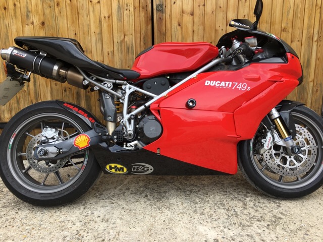

  3. This is a 749 I owned a while back with MIVV cans.
    I think I have a spare, used 999 system lying around somewhere, without cans.

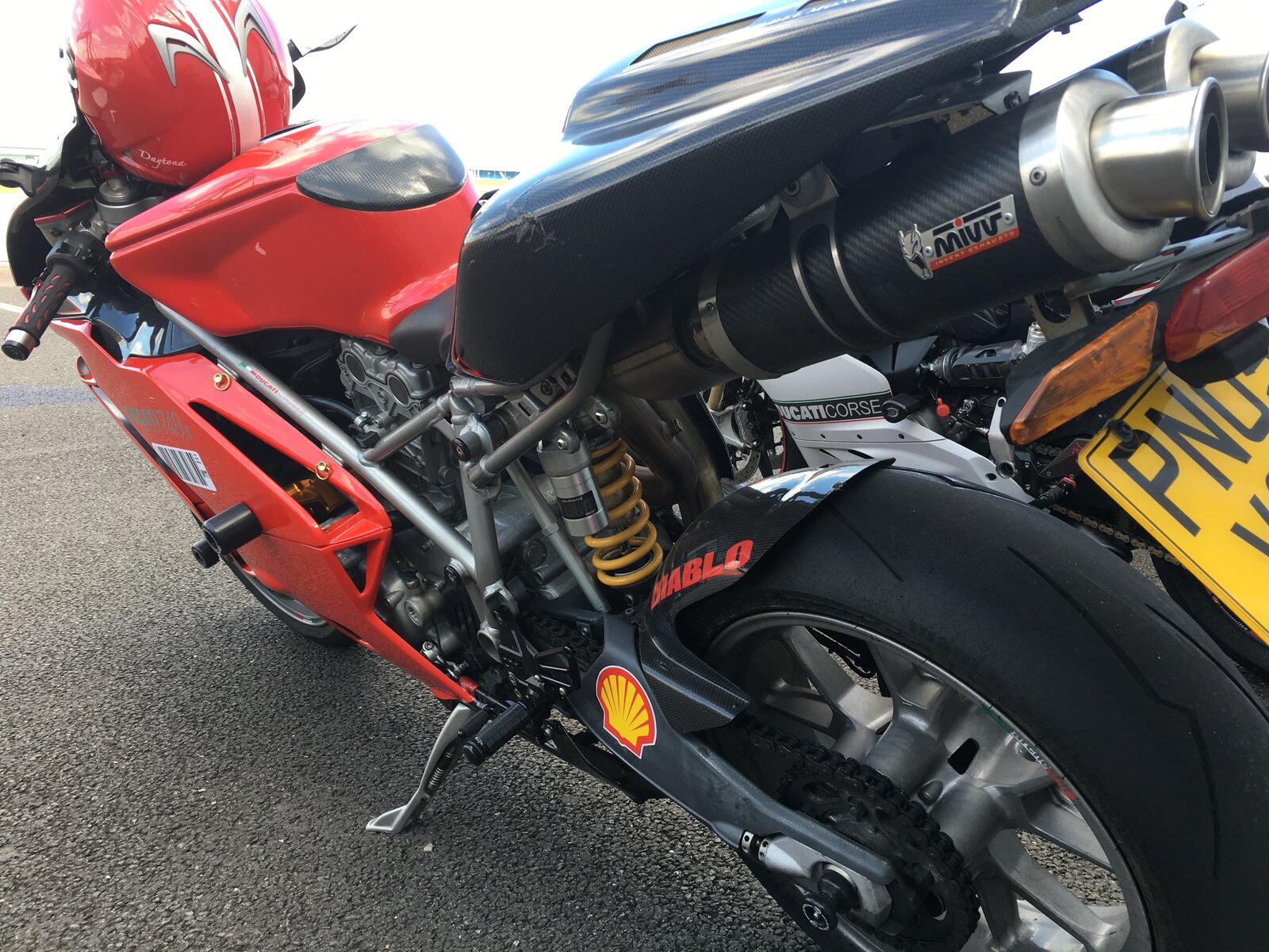

  4. Do you have any different pics showing how the mivv cans are mounted and how the exhaust pipes enter the cans.
  5. Think this is only other pic I have.
