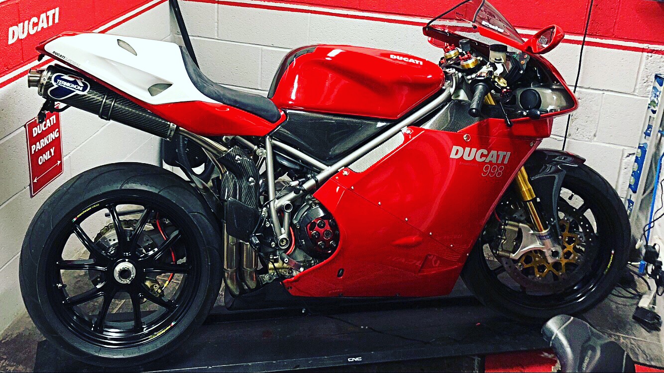

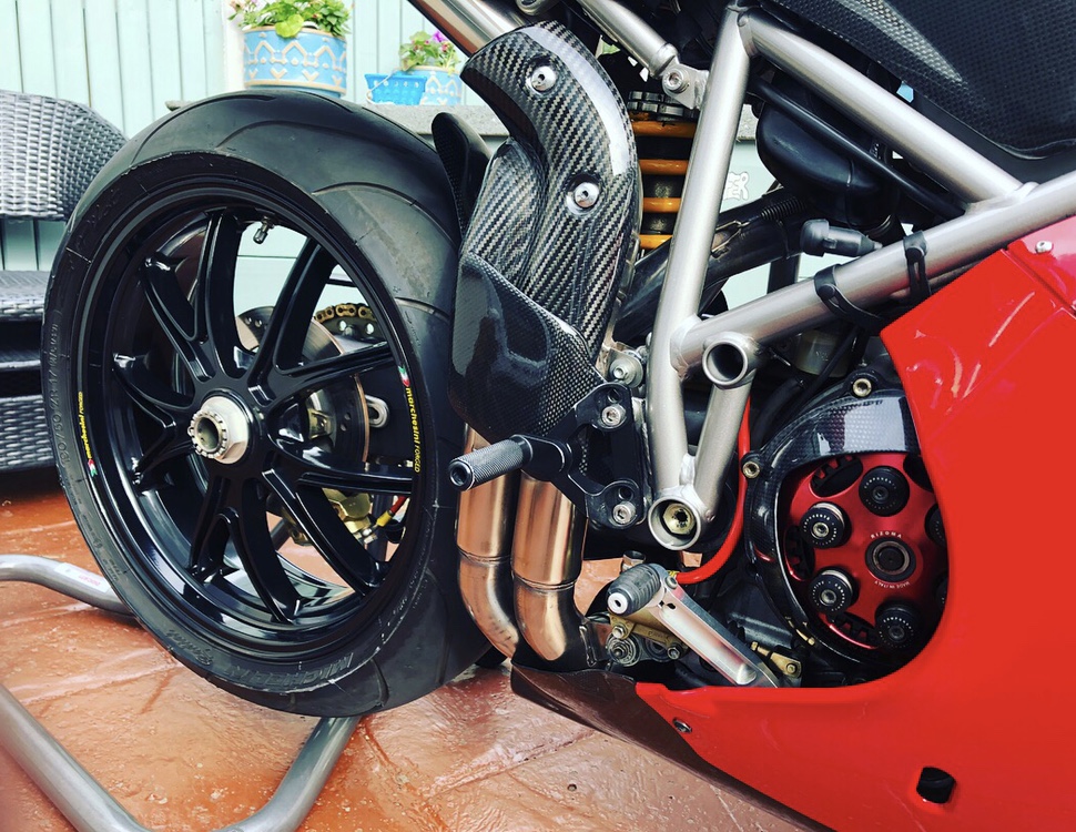

  3. Marchesini 10 spoke I have on my 998 A34797B0-0D7C-44FA-9AD1-837570F9D79B.jpeg

  4. Bloody hell that's amazing.......... Pic of the whole thing ?
    Have you modded it to fit that wheel then ?
  5. Likewise on my 916;
    No, modding required as they are 916/996/998/748 specific.

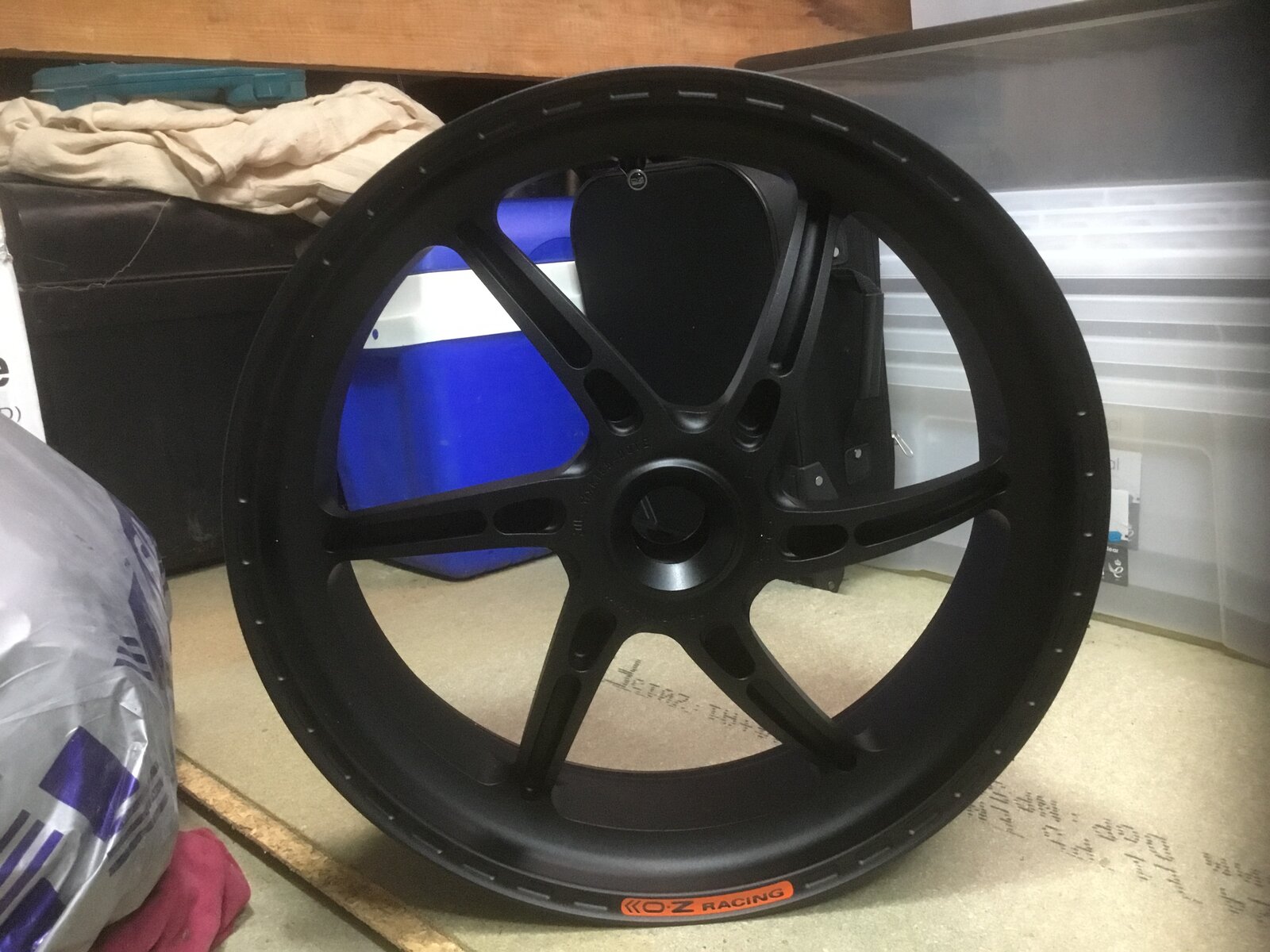

  18. I have a New set of OZ 6 SPOKE Gass wheels complete with box. 4F038C68-8966-4F0C-B193-E6AC4A831E3F.jpeg BC07A942-685E-4908-B627-7FC0B597AA74.jpeg

  19. Love those OZ wheels but would want a different colour.
