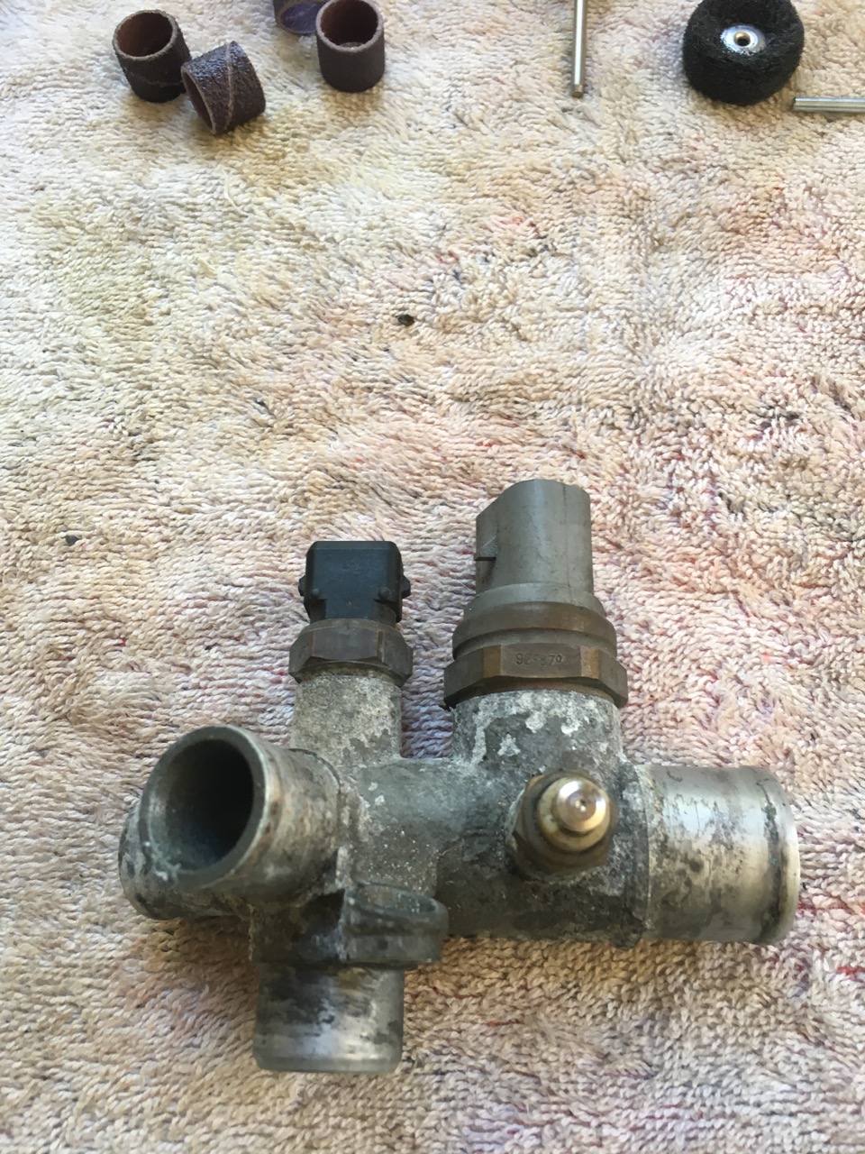

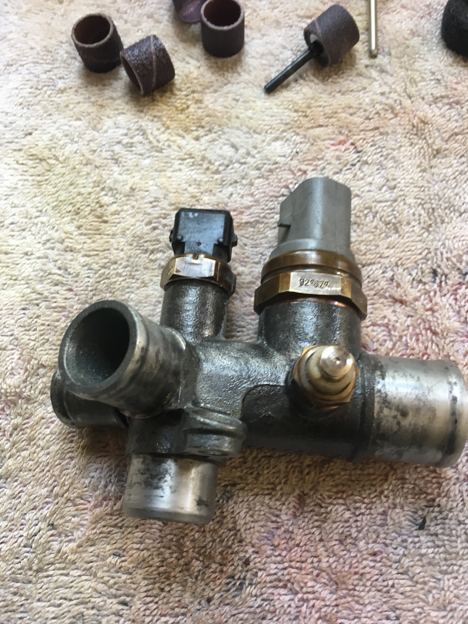

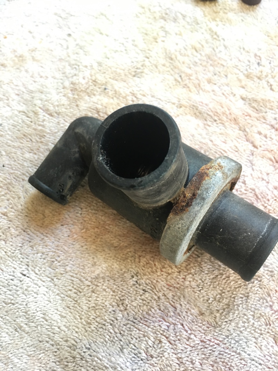

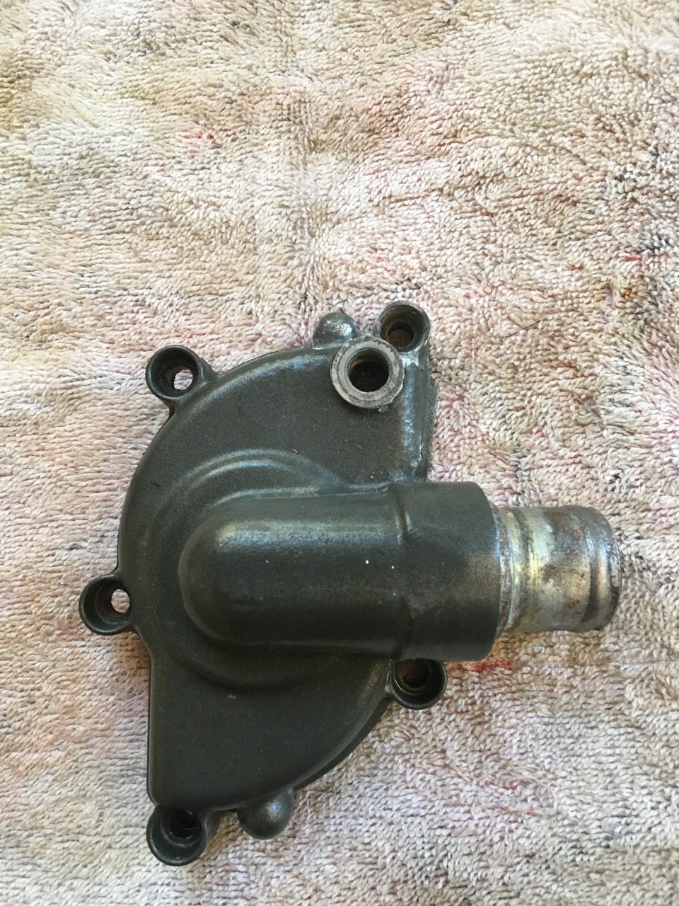

  1. I'm refurbishing my 748 and am wondering what is the best paint to use on the rocker/cam/crankcase covers? My current plan is they will remain in situ on the engine, I'll remove all the flaking paint, in places this will take it back to the bare metal, I'll then sand it to smooth any lips between good paint and bare metal then plan to paint over them. Obviously the paint has to have some heat resistance and I'd like it to be as near as possible, if not exactly the same, as the original grey colour.
    On a related matter, where I've bare metal that's been cleaned/polished what's the best way to keep it that way? Lacquer? AC50? The photos show the union and thermostat from the coolant system before & after my first pass at cleaning them up.

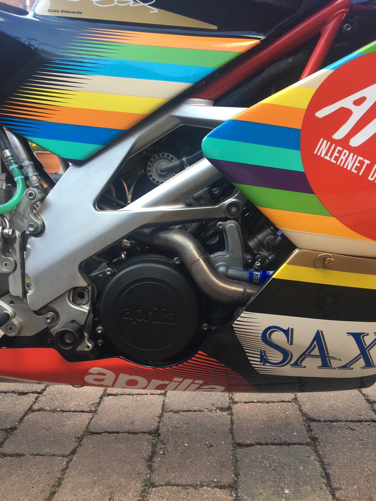

  7. My Aprilia engine has just been rebuilt. Several covers have been powder coated. Don’t know who did the coating but I can ask the engine builder. (Cal550) he’s well know for SXV engines
  8. Thanks. I just the outside coated? Don’t bother asking who did them as I’m in SW Ireland so it’ll be too far away for me.
