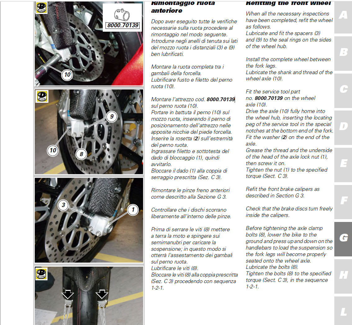

  20. This is from a 749R manual but it's the same procedure. The 'special tool' is used solely to ensure the hole in the front axle aligns with the fork leg (so that you can pass a slim flat-blade screwdriver up through the bottom of the fork leg and adjust the compression damping valve in the bottom of each fork):
