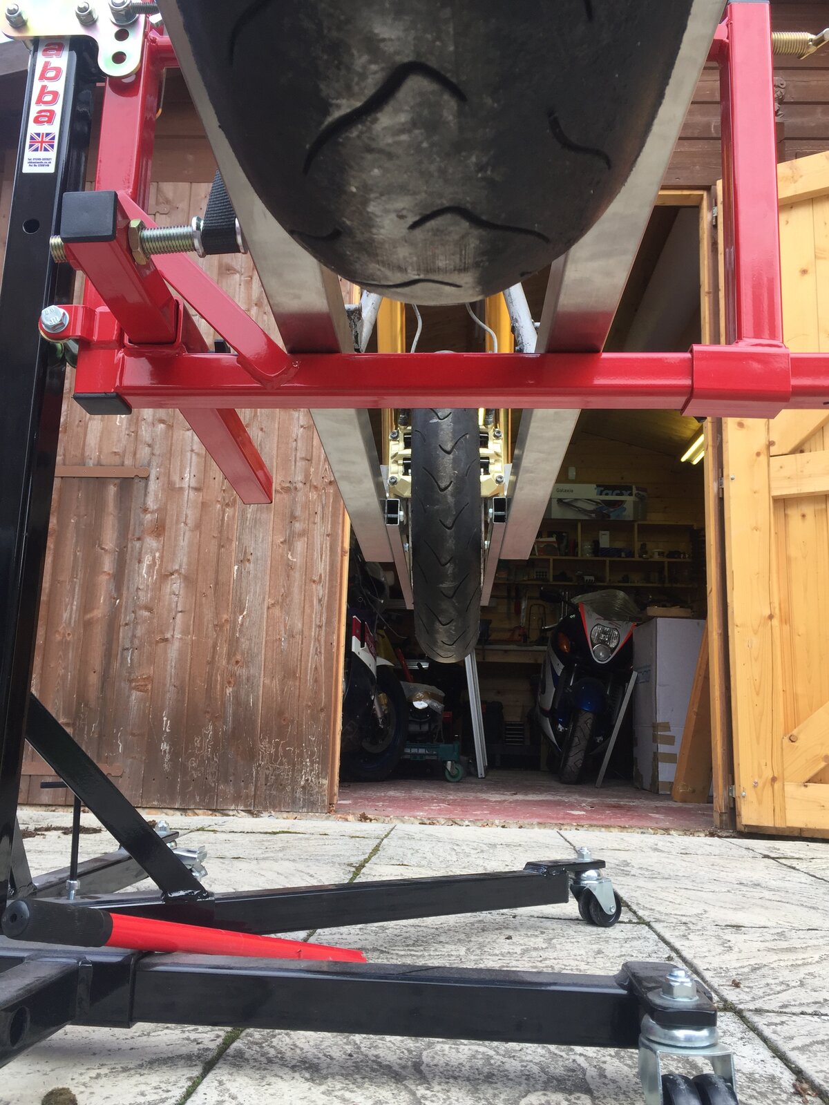

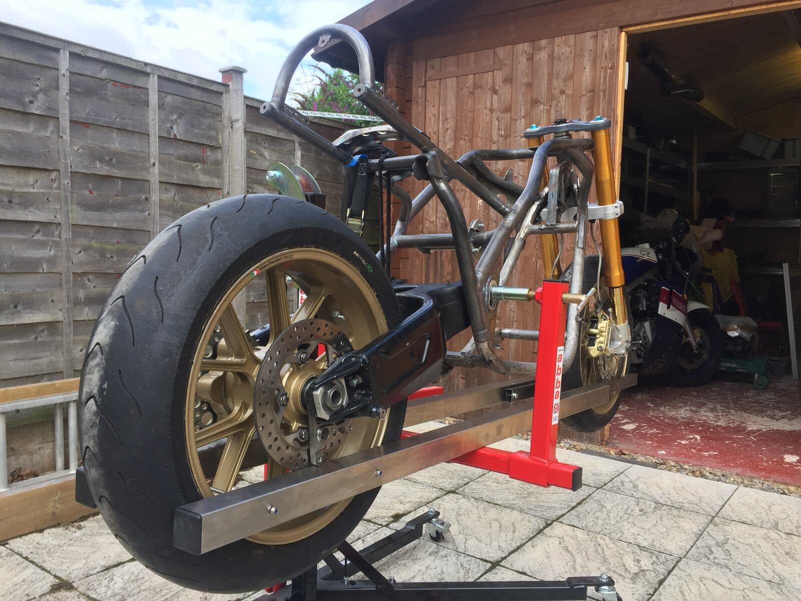

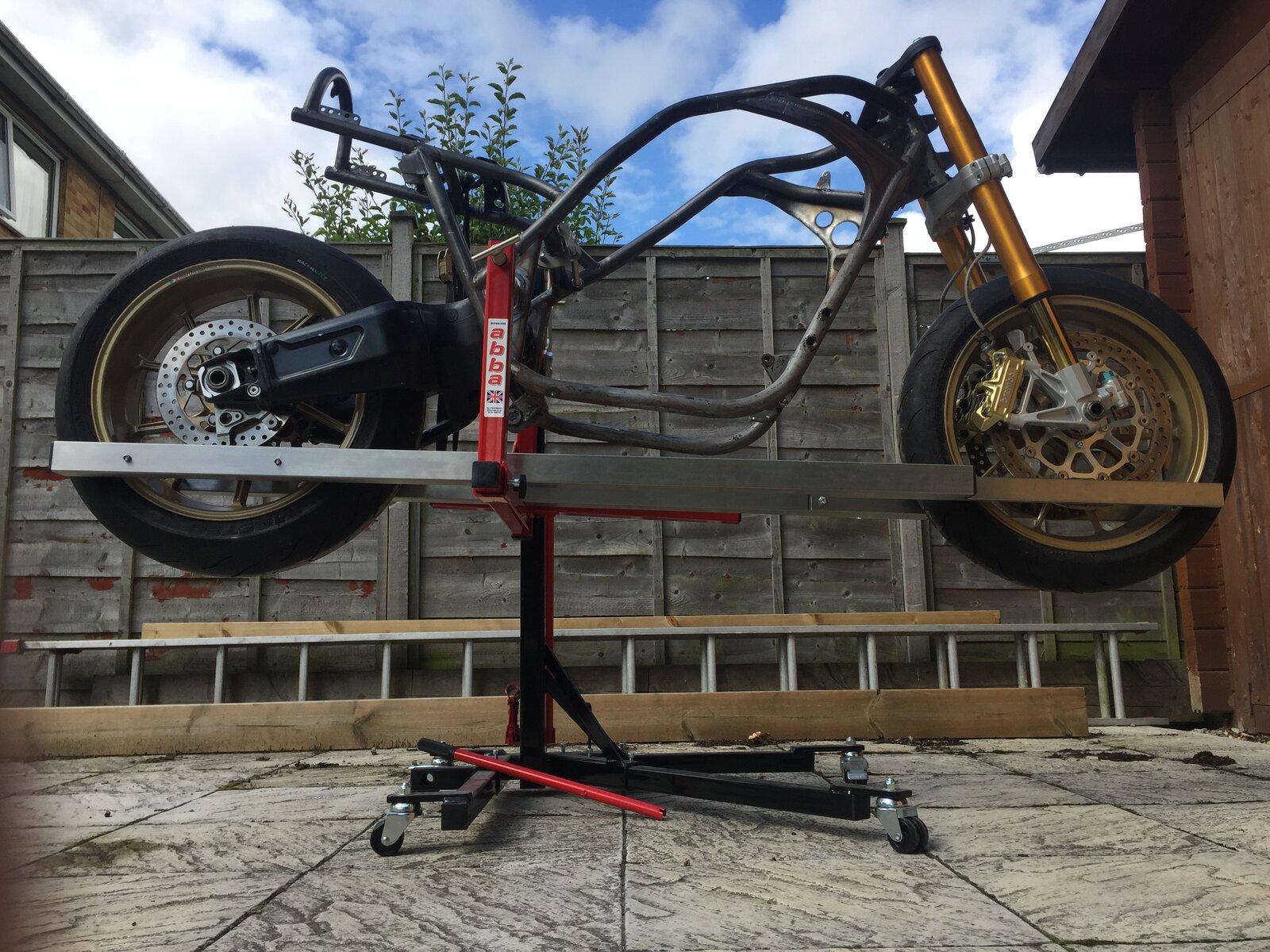

I made this for my project build, it clamps to the rim of the rear wheel 2 positions on either side using tape covered aluminium blocks so as not to damage the rim. You will find bikes fresh out of the factory that are 10mm out or more in some instances not sure how critical it is though got mine to less than 0.5mm
