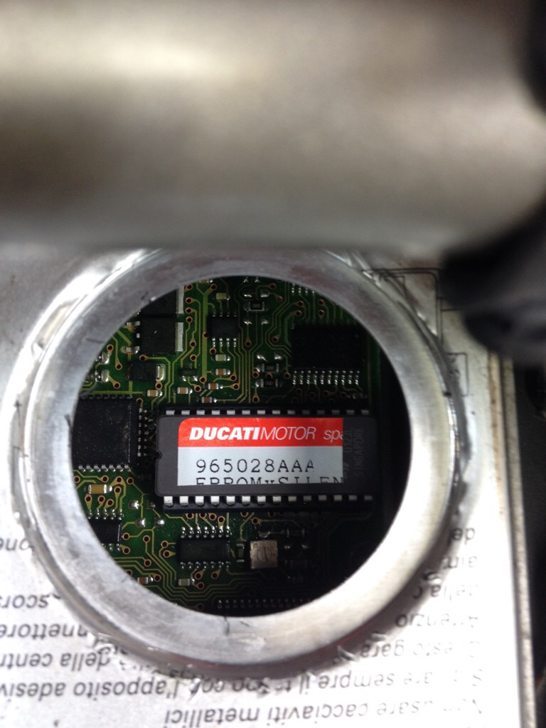

  7. [​IMG]
    Reliable source, I wouldnt rev to 12k

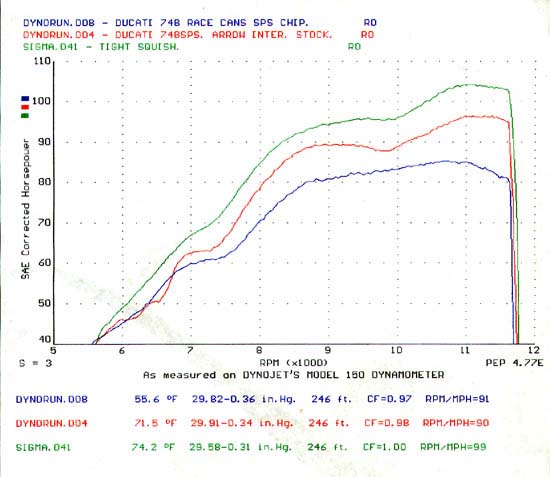

  8. Check out graphs online and a couple seems to show it revving a tad over 12k but most 11500

  10. Check the sigma site, Spalding says its 11500.
    Been a while, cant remember the name (think @nelly may still have the software??) but you could shange the parameters incl lift the limiter. Few of the race bikes had a higher limit as the internals were better and they were serviced more regularly.

  13. Reading the spalding article, he reckons the redline (thats what he describes, not limiter) is close to the limit of where you would want to rev a 4v and maintain reliability

  17. The above eprom is for the model below according to Ducati.
    965028AAA (08054/17) - 748 Biposto silencers Ø 50
    The others are:-
    965014AAA (08054/6) - 748 Twin-seat silencers Racing
    965036AAA (08054/7) - 748 Biposto complete assembly Ø 50
