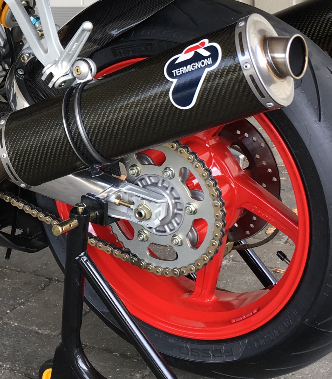

  7. I have a 520 VX2 Gold on my 900SSie with no problems. No stretch. According to the did website the tensile strength and wear resistance is only slightly lower than a 520VM-X and not far from the 525VM-X. The SSie is not a 200HP bike. And the 520 chain is lighter and narrower giving more clearance between chain and edge of tire if you run a 180 rear tire.

  8. Thanks for the replies. Chain arrived today and having seen your picture SalkinSupersport I have now ordered a new sprocket too!
