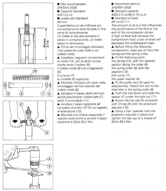

  2. Agree with 5.0w oil. 1 litre is enough. Fill to 94mm from the top of the fork tube with the springs out and the fork collapsed. This page from the manual might help.
