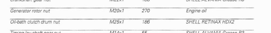

  4. I pity the poor s*d that has to get mine undone - I used 638 - that will not come undone easily without a bit of heat.

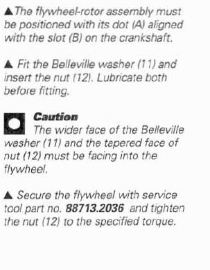

  5. Just waking this one up, manual says use Greese not locktite
  6. What manual?
  7. Ducati workshop. Correction says use engine oil
  8. That's lubricate the mating faces of flywheel, washer and nut face.
    Look at the torque spec charts..
  9. The extract from the workshop manual above appears to be from the IE manual.

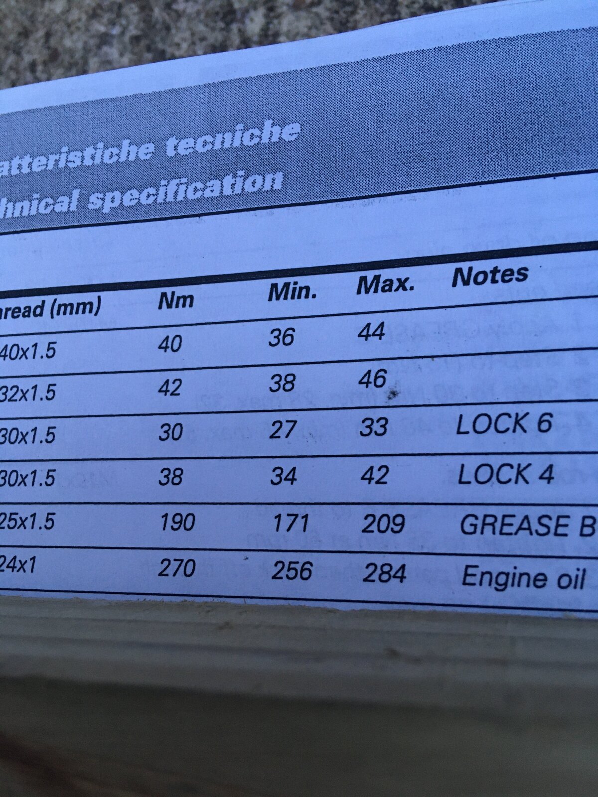

  10. Sorry this is a 2002 ST4S
    Engine Oil is on the torque spec
  11. Engine oil on mine too. A7E2A34E-FC5C-44B8-822A-4A8B313DC8BC.jpeg A6930793-BA75-4E94-8A06-03860361AD40.jpeg
