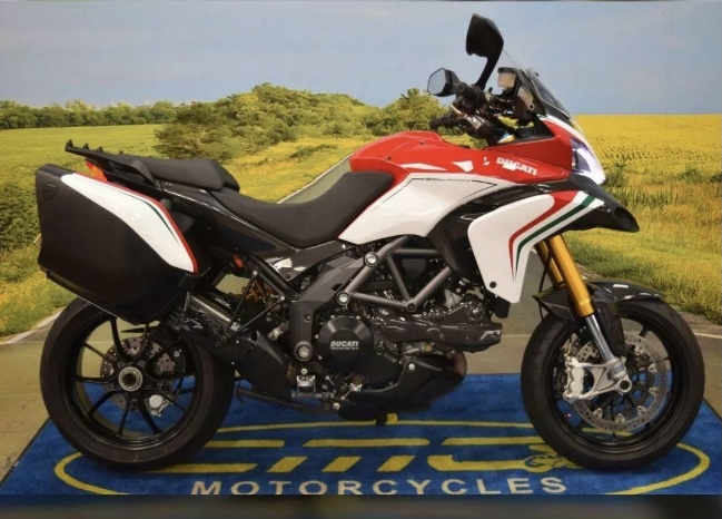

    I like the look of this 2012 single-spark S Touring with less than 5k on the clock, FSH, Ohlins, panniers and top box etc up for £9.5k ...
    https://www.cmcbikes.com/used-motor...istrada-1200-s-touring-for-sale-5f8ed25794c37
    ... but I wonder
    a) if it’ll be too tall for me?
    b) if it could be prone to the porous heads issue with more miles (@Pete1950 thinks this problem may have been sorted by Ducati for the 2012 production run - anyone know for sure?)
    c) any other potential show-stoppers on 2012 bikes?

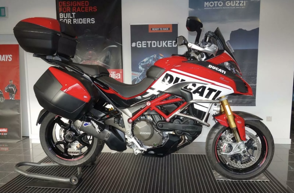

    If I’d be better off with a DVT given my short-arse stature, then this one is up for £13k local to me - 2016 Pikes Peak, 5.5k miles, FSH, Termi with titanium link pipe, Rapid bike self learning fuelling module, Samco coolant hoses, Oberon billet clutch slave cylinder, Touratech OEM crash bars with spotlights, Healtech quickshifter, radiator guard, billet front cylinder guard and paintwork protection film.
    To me it looks like a cracking bike at a good price but I’m not sure if the DVT engine would just be too refined for my taste.

  5. That DVT is running a decat link pipe on a short Termi.
    I’d expect it to be loud, very loud!

  10. Not sure if the first bike you put a picture of is a Pikes Peak, I thought they had a red frame.
  11. Good catch. That's not a Pikes Peak. The 2012 PP had a red frame and red stitching on the seat.
    However, back in 2012 the Pikes Peak wasn’t any different from the "S" other than cosmetics.
    If I was you @Dave, I'd go for the DVT shown.
  12. Good spot. My bad. It’s an S Touring. I’ll edit my post. Thx

  14. £9.5k for a 2012 S Touring is having a laugh, even with 5k miles. That is the exact model I have been riding since March 2012. I had an issue with the horizontal cylinder losing compression at about 33k miles and chose to spend my pennies on a full engine rebuild instead of a new bike. That should tell you everything. Purely my opinion, neither the twin spark nor the DVT could do anything better than the original bike except run a bit less lumpy in high gears at 3000 rpm. Who does 30mph in 3rd gear anyway ? The 1st generation 1200 ECU is the easiest to overwrite and can, if you really want, unleash a beast. I tour, I scratch and I have tracked mine and it is the first of my bikes (including 748R, 1098R and Panigale V4) I choose to ride on the road. Andy

  15. I owned both and in my opinion the DVT is a far superior bike. The front always felt remote to me on the earlier bikes.
    DVT seat is also lower.
