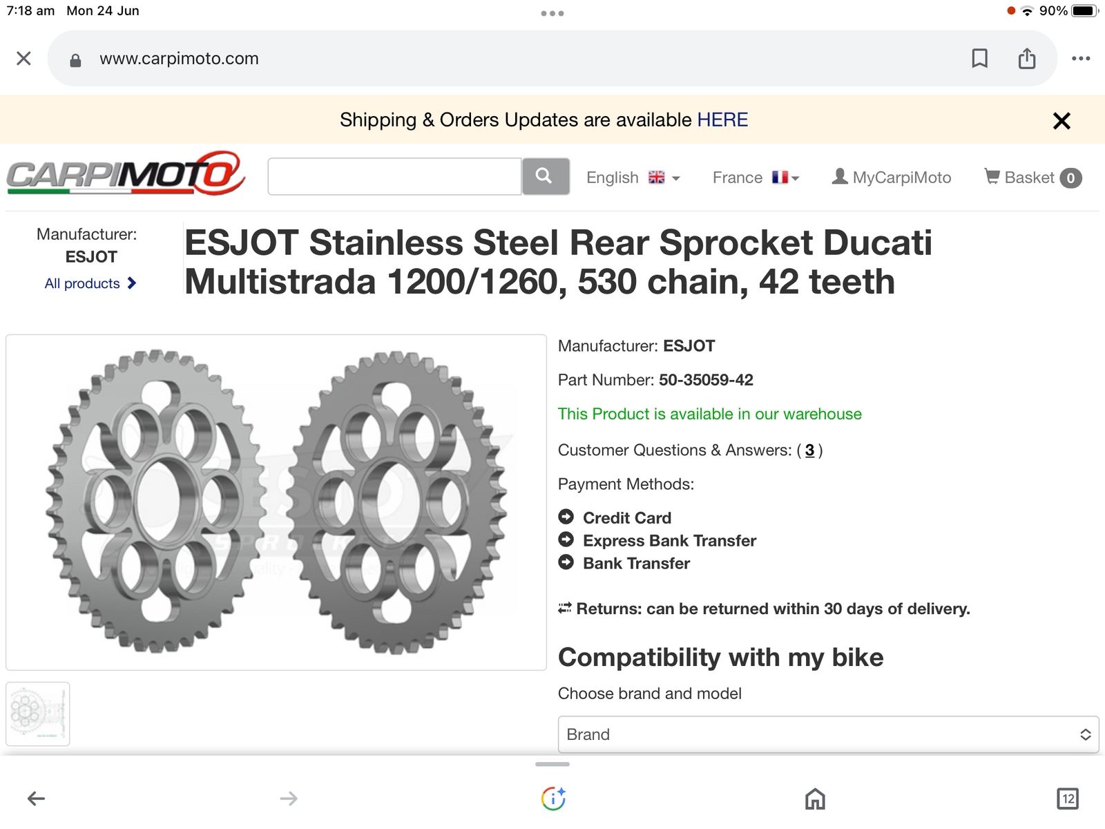

  17. I bought this from Motos Canosport in Spain, they will post to you.or you can try Carpimoto in Italy.
    Also bought an Afam chain and a 14 tooth front sprocket. + 2 links in the chain.
    Personally I preferred to stay with the 530 pitch thinking the stronger the better. The bike is definitely easier to ride at 30mph with the 42 sprocket. I’m very pleased with the setup.
    Pic below gives you the part number.
