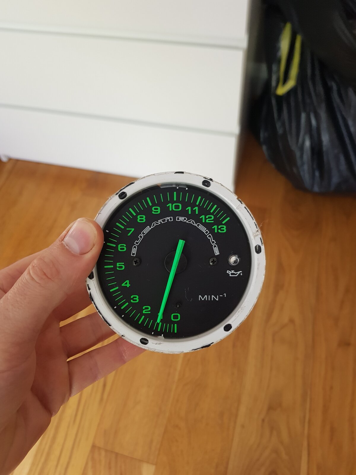

  1. Got this rev counter, my 996 one has Ducati Corse on it but this one has Ducati Racing. Any significance to that, does it denote model year/ compatibility or anything.
    Thanks.​

  8. ok so looks like pre 2000 then, thanks.

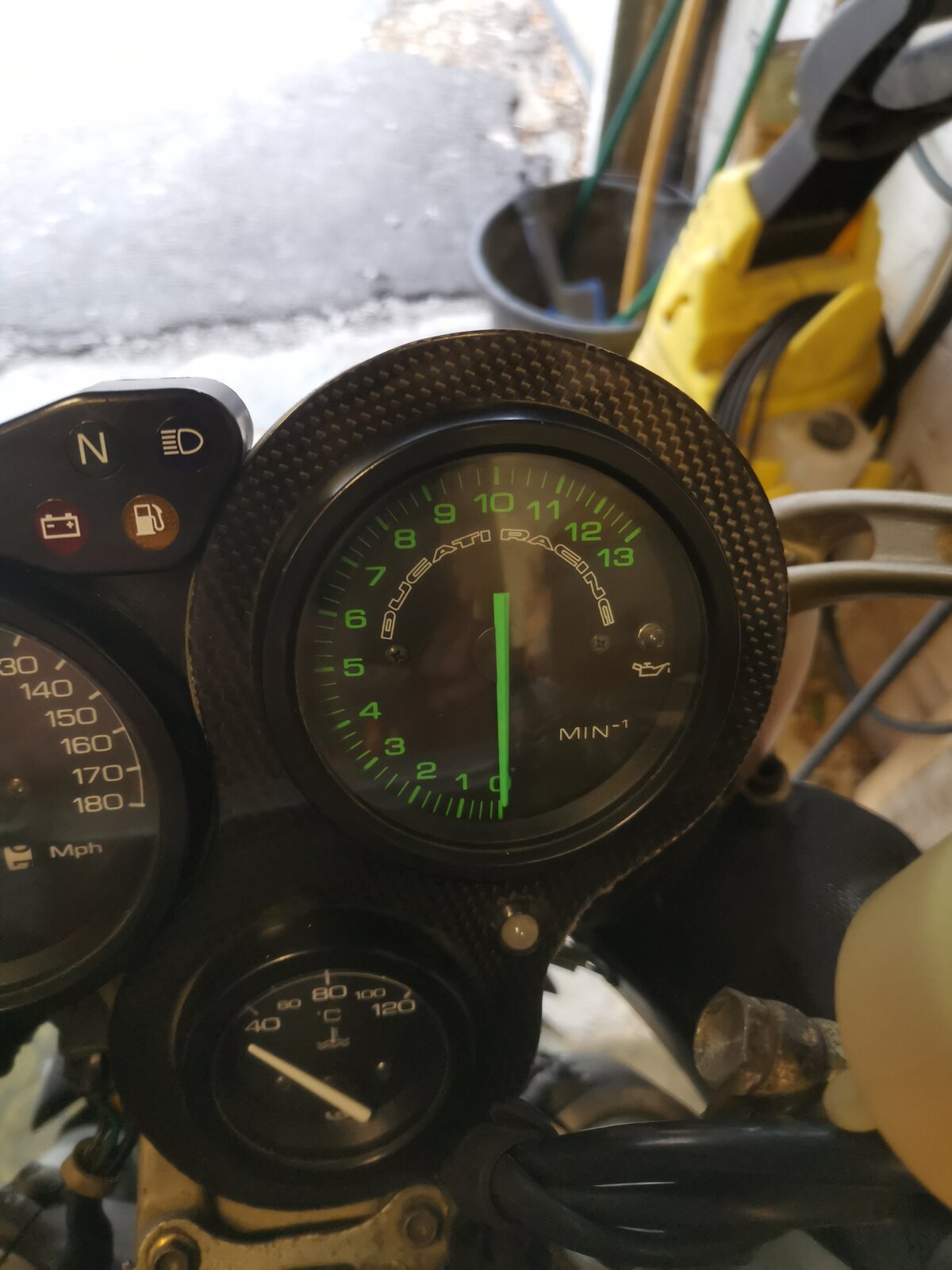

  13. Looks like they made a few variations, mine is different again:

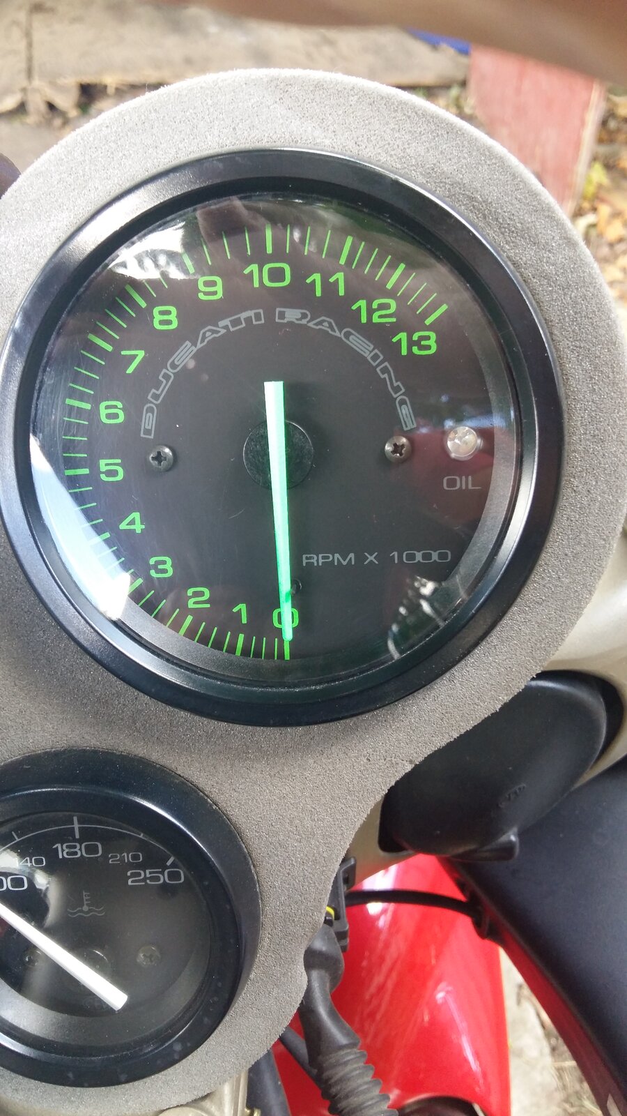

  17. There is a 748.for.sale in the classifieds that has the same one Ducati Racing with no x 1000.
  18. My 1998 748.
