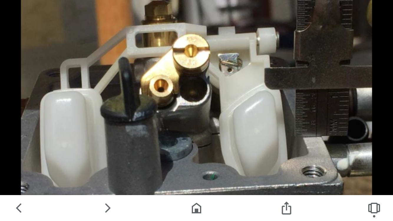

  1. On BDST carbs fitted to an M900 which side of the float should be measured to , I’m pretty sure I know but don’t want to bias any answers and A70A7678-AC6E-44DF-8933-AE2B614B7C56.png 0C52D3E5-030D-4A7F-BF31-75768A9DA2B4.jpeg these photographs contradict each other

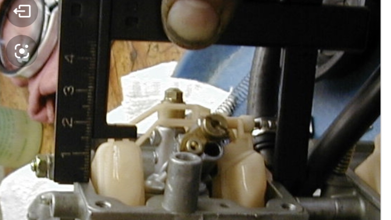

  2. In case anyone finds this lonely little thread in the future it’s this side of the float that you should measure to, if anyone thinks I’m wrong please shout up!. 6B2B2F77-635E-4E50-8AC7-67CD5D0093DE.jpeg
  3. there's much conflict over this Mark, elsewhere and on here. It's best to do this before stripping but, do your adjustment, if you feel certain that it needs it and then confirm with the tube method :-
    http://bradthebikeboy.blogspot.com/2016/03/setting-float-level-on-mikuni-bdst38.html
    I can certainly relate to, and agree with :- "I don't think I've ever checked one that has been wrong. Certainly not one that hasn't been played with anyway. If someone has been in there trying to make it right it's usually not."

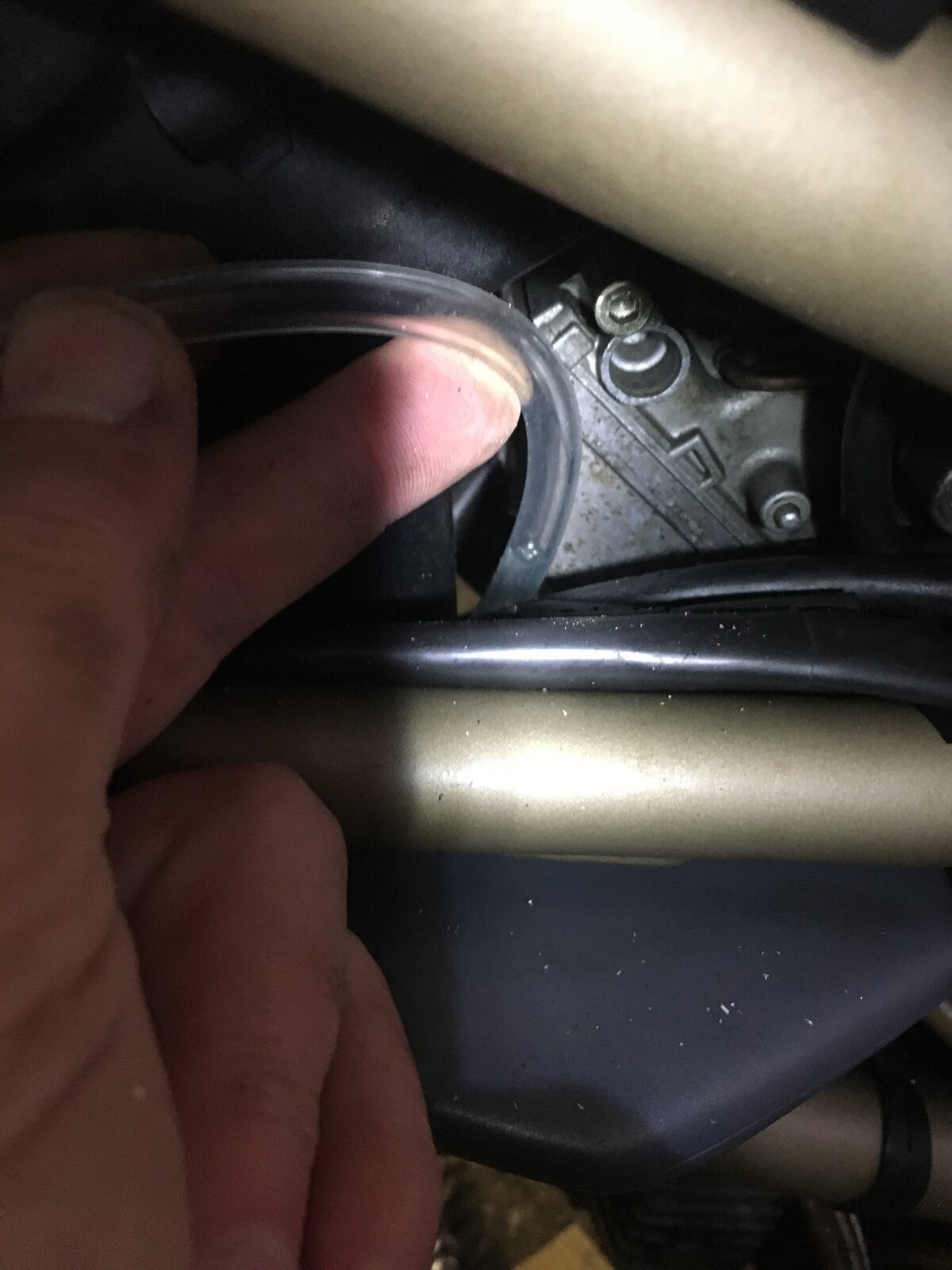

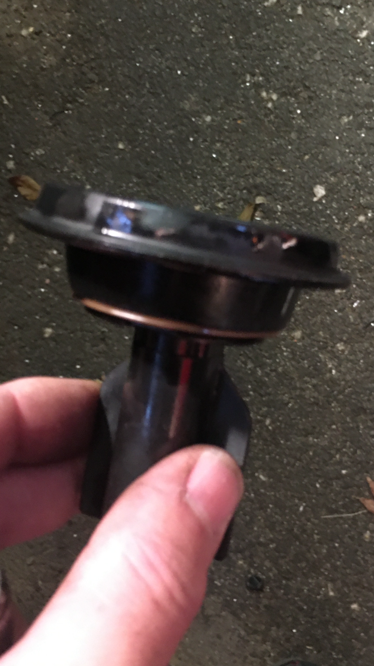

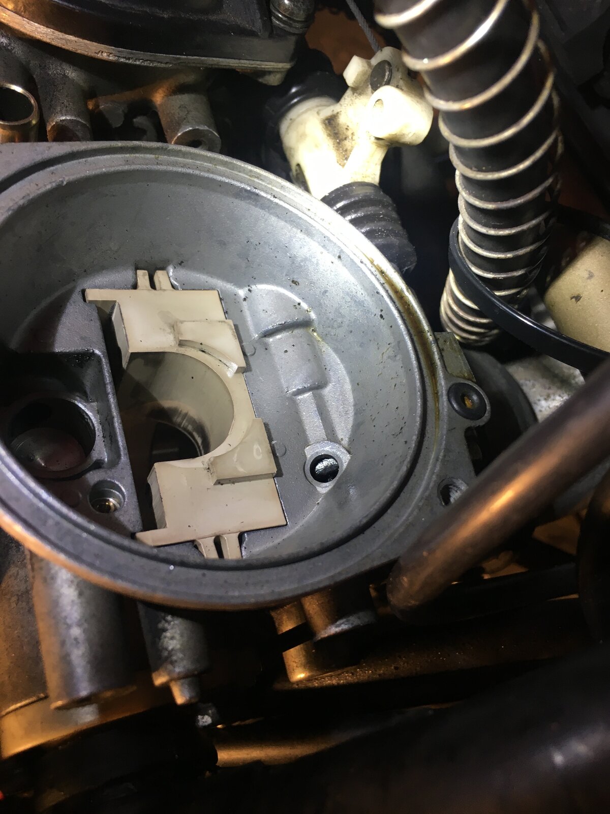

  18. 92AAA230-3C3A-44B2-BE3C-02F9F1B1A51F.jpeg You were right about the fuel level not being the issue Chris, I did the clear pipe check and as you can see in the photo it’s correct, I decided to swap the K&N needles that came with the bike for the standard needles that came with the rebuild kit, didn’t really think that would fix it as the horizontal cylinder was already giving a good plug colour, when I took the carb tops off I found the diaphragm for the vertical (problem) cylinder covered in fuel, also fuel in the recess & channel that the diaphragm sits in (ref photos) so that’s got to be CFA5885A-C50D-45CB-87B0-409497F804C3.png FB524DDA-7FC2-4E3D-9AAE-F268B9589C9A.jpeg a big clue, trouble is I don’t know what the clue is pointing at!, anyway I didn’t strip the carbs any further deciding to use this attempt just to rule out the needles (and more honestly just wanting to get it back together and go for a ride :) ), result is predictably the same, horizontal plug nice tan electrode, vertical plug black as soot and wet, the choke mechanism all seems to be working properly but how is that fuel getting up there?, I’m thinking could the primary jet have unscrewed itself and dropped out, total guess and I’ll obviously be taking the carbs off again and investigating but any suggestions are very welcome, cheers Mark.
