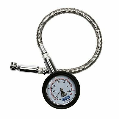

  8. Mine is like ^ but is a Venhill job. C£20. I like as it has a pressure release button so you can drop pressure without taking the line off the valve.

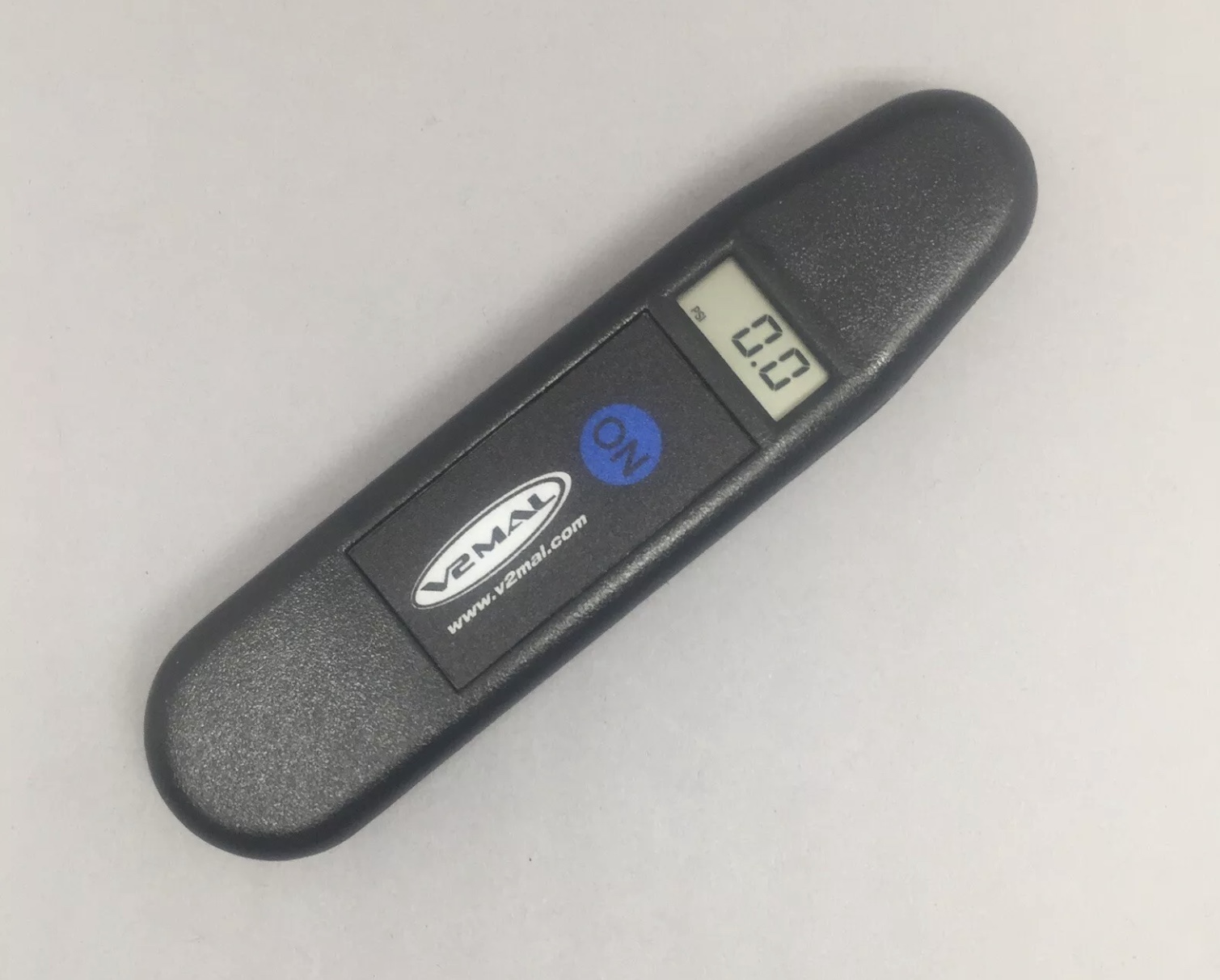

  18. I read a magazine review of tyre gauges and the two most accurate ones were Venhill and these little fellas.
    When an opportunity came up of a job lot of them I bought a whole lot and gave them to one of my bros to sell. ( That’s what he does as a part time job, buys and sells things).
    The review said these were pin accurate all through the range,I figured that’s what you want from a pressure gauge. I can’t vouch for that but I have found them consistent.
    I have one in my tank bag, one in the car one in the Mrs car and one at home. I don’t go on any bike trip without one. I check my bike tyre pressures every time I go out, easy peasy.
    I don’t know exactly what he’s selling them for but it’s certainly less than a tenner. I think it’s actually £6.99 posted, I’ll check. If anyone wants one or more let me know.
