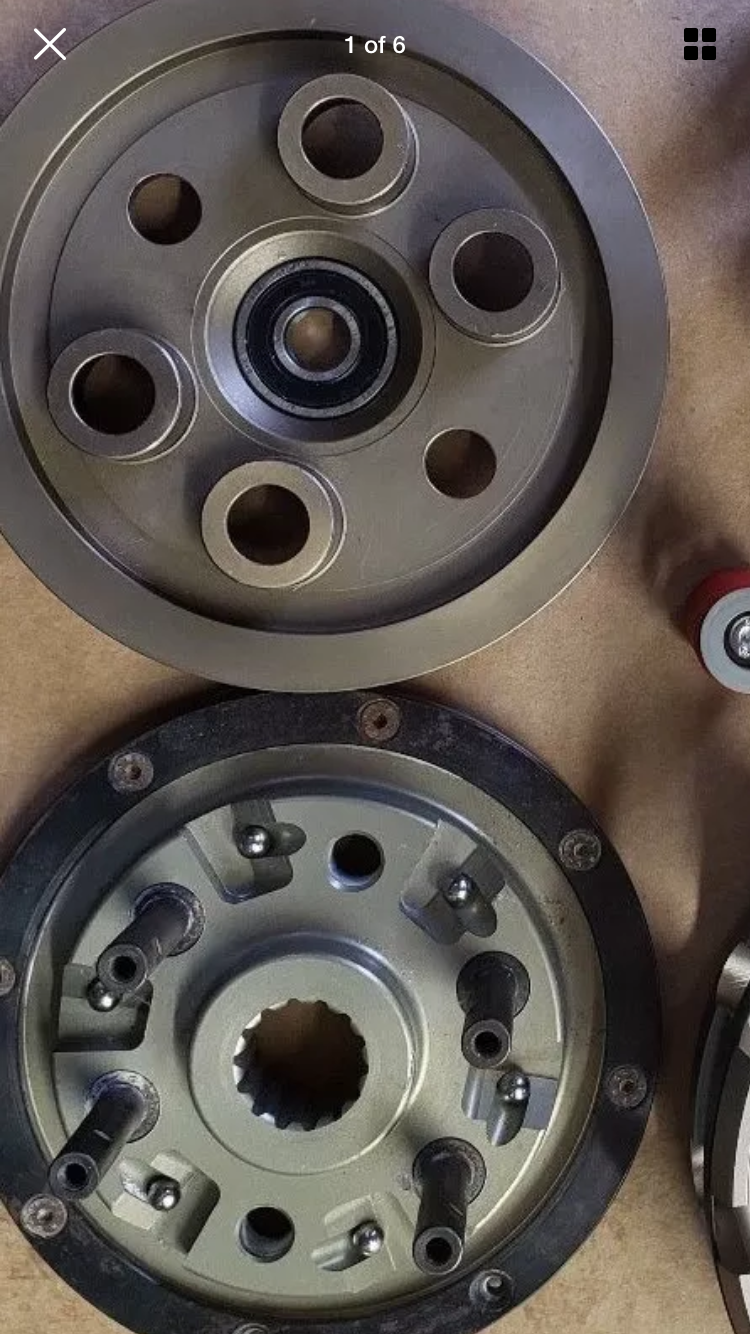

  1. Do you know what brand this Slipper is?

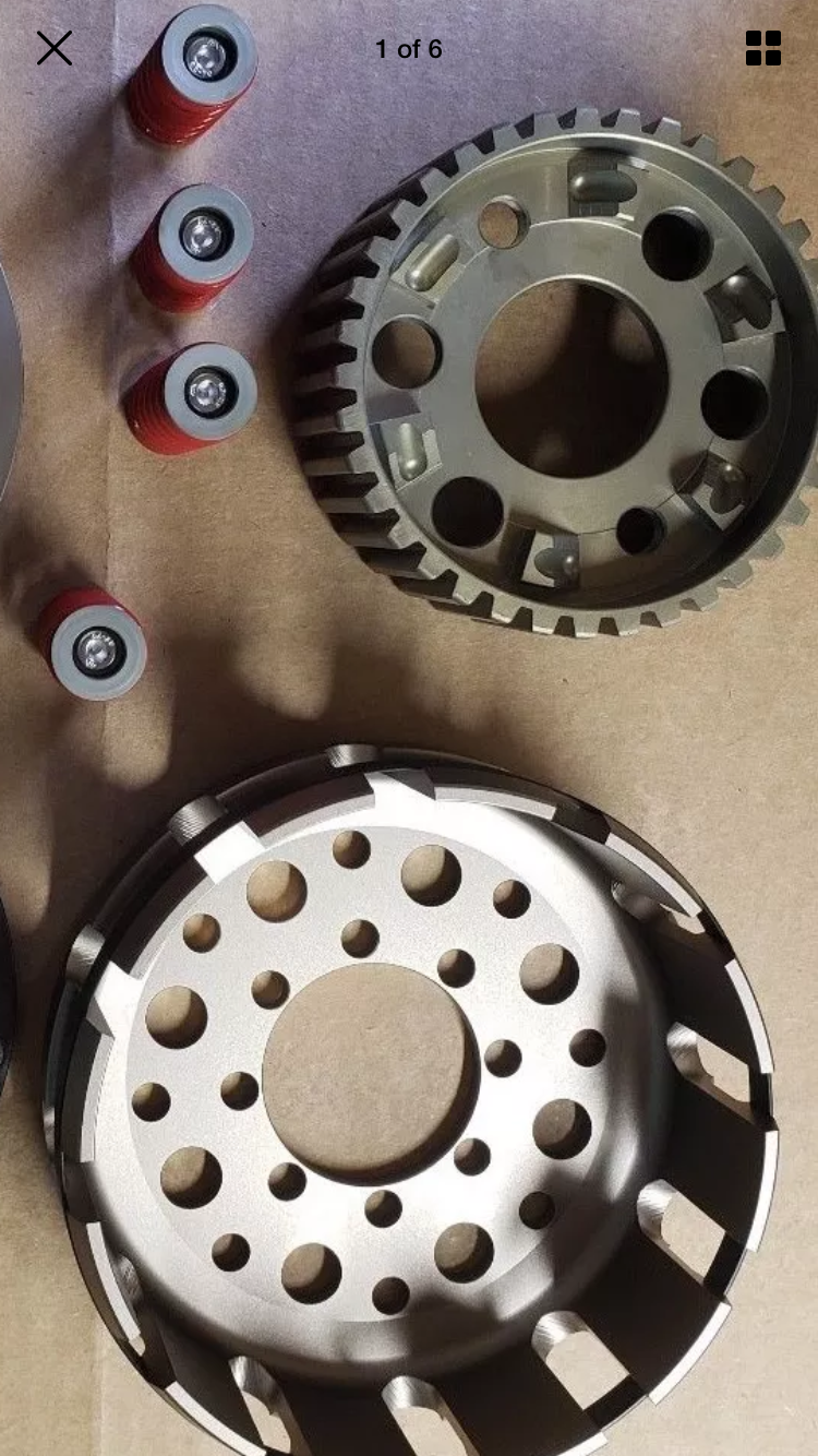

  2. Looks like a race clutch, you lose 2 spring posts for an external starter. Could be Ducati Performance at a guess so bought in from someone like Bucci. Andy
  3. Yes, but it has no branding or parts number what so ever (not even on the outside of the pressure plate). Can it be an asian copy of a DP? Wouldn't the quality brands use branding and/or parts numbers on their stuff?

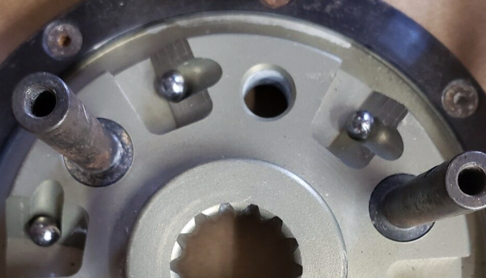

  6. Here is a closer look. I hesitate a bit. Doesn't it look like "low quality" finish? (file attached)

  7. it'll be alright...
  8. What's the brand name on the central bearing?
  9. SKF :) I was thinking the same thing... China = not SKF :)
  10. Great minds etc :) The knock offs use cheaper bearings.
  11. So we are looking for an american that bought a cheap chinese copy of a slipper clutch fitted his own release bearing in it and then decided not to fir it to his bike.

    After spending some time with my whiteboard and investigating things (drawing arrows, hanging pictures etc.), I decided to not buy it. My guess its a good basket, and ok (but cheap or refurbished slipper parts - painted badly). I am sure it works but with missing parts in mind I will go for something else.
  15. Agreed with the others, race clutch genuine or copy, it's got steel ball ramps and the 4 post with locking pins, but it uses a thrust spring and post springs like the old OEM clutches on 748R etc. Also clearly designed for standard plates, hence the basket and centre hub design
