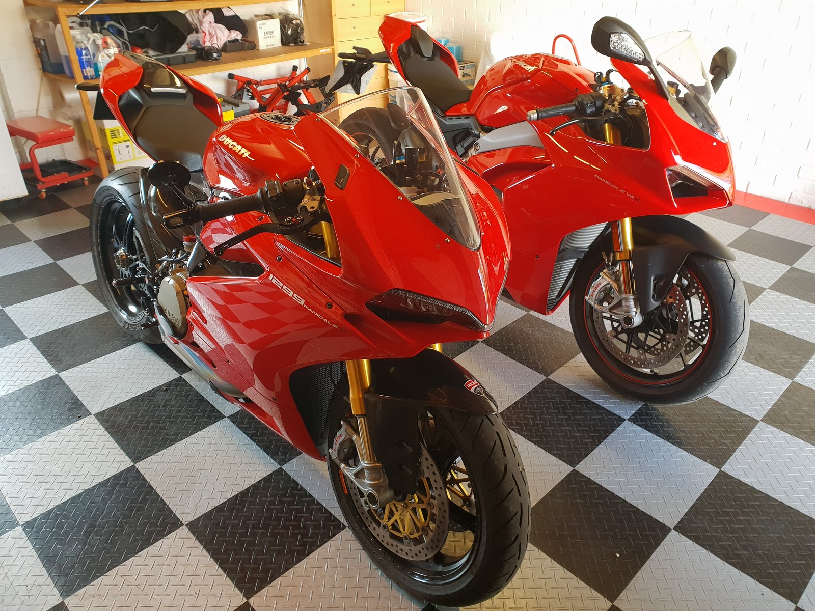

  1. Not sure how this happened! Keeping my 1299S company, albeit briefly, since this V4S was a demonstrator from the local dealer. Will be a few more months yet until I pick mine up.

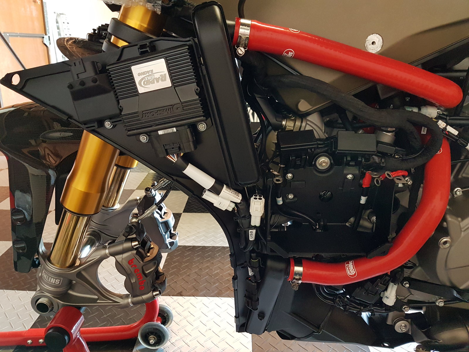

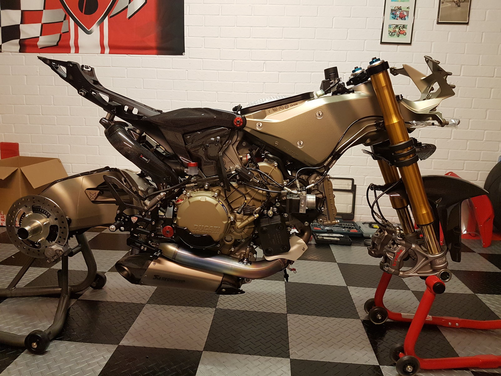

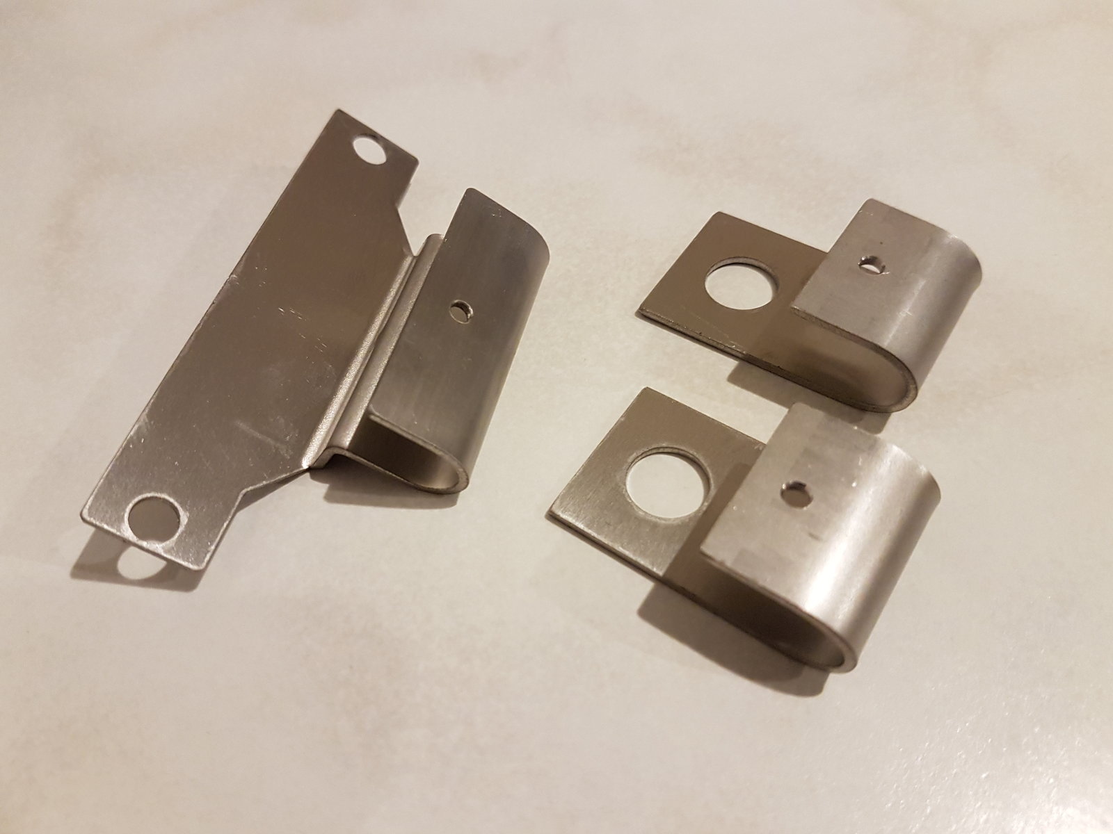

  12. Cinderella? Perhaps due to the fact that the 1299S has had a lot of extensive mods done to it. The V4 is in line for the same fate. This was my new PDI mileage 1299 a few weeks into the engine up rebuild after I had the frame and swingarm Cerakoted. Electronics were by far the most time consuming to route neatly and efficiently. Tackling the V4 will be similarly challenging but not altogether that difficult. Already have the engine support tool on order, so it'll be in bits within a few days of me taking delivery. I plan to do the work over the Winter months as normal, so the bike will be ready for Spring 2019.
  13. some nice modifications there, i must have missed your pictures previously..
    and the RB Race install is well placed, what attachments did you use? anything special?

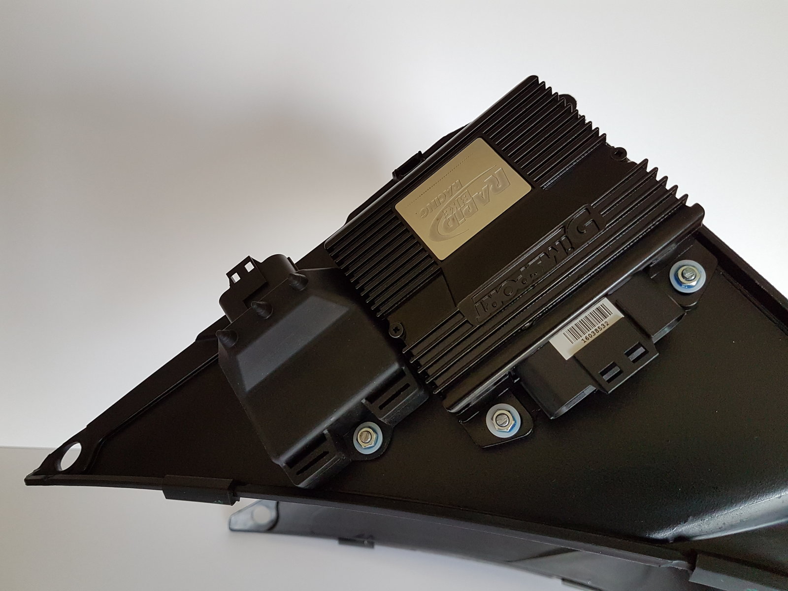

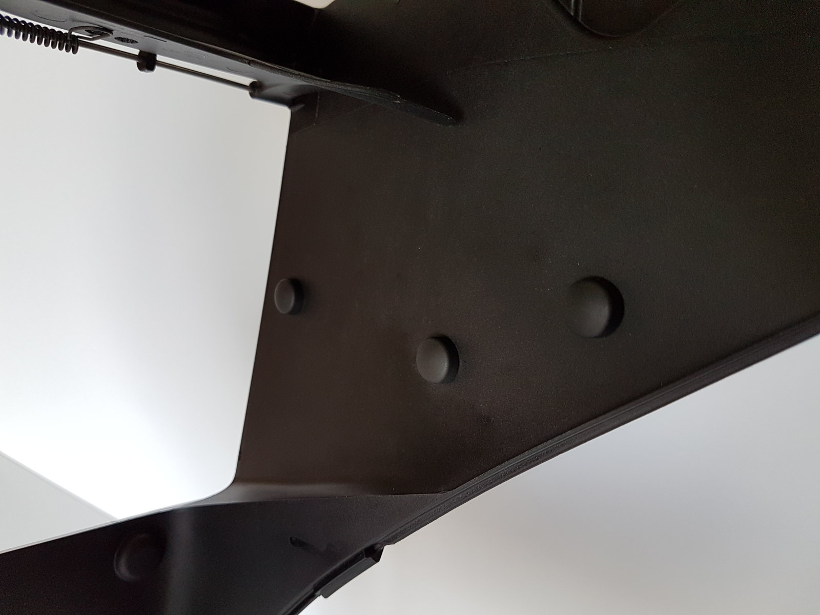

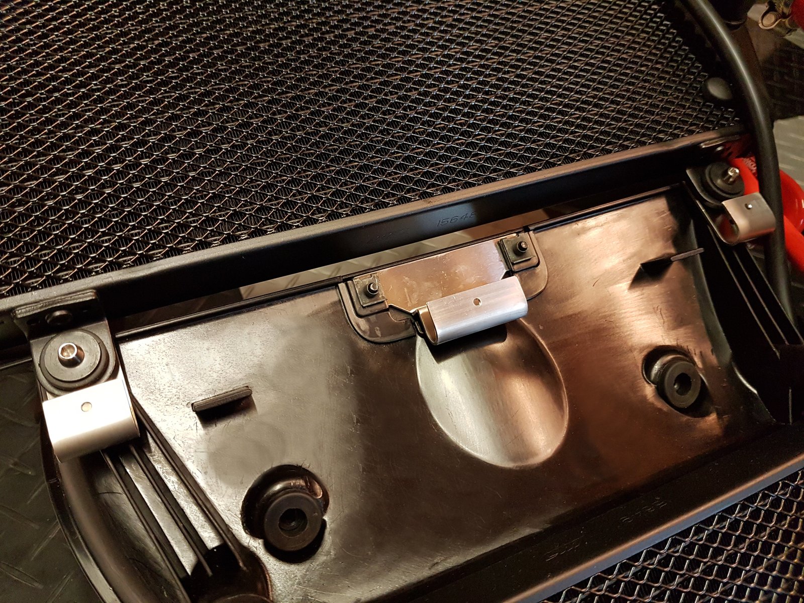

  17. Never ran a thread on the build. Not sure if people would want to see another one. I used 'Snaplock' fasteners and stainless nuts and bolts. These allow you to hide the fixtures with a finishing cap that snaps over a special cup washer. in the second picture you can see the cups fitted. On the inside, they have yet to go on. The Ohlins EC module had to be remounted forward of its OEM position and the rubber mounting modified to suit. Original plastic lugs were removed from radiator shroud to allow RB module to sit flush. I also had some special aluminium brackets made up to route the RB wiring module across and behind the radiator to neaten things up. Small pilot holes are for tie wraps.
