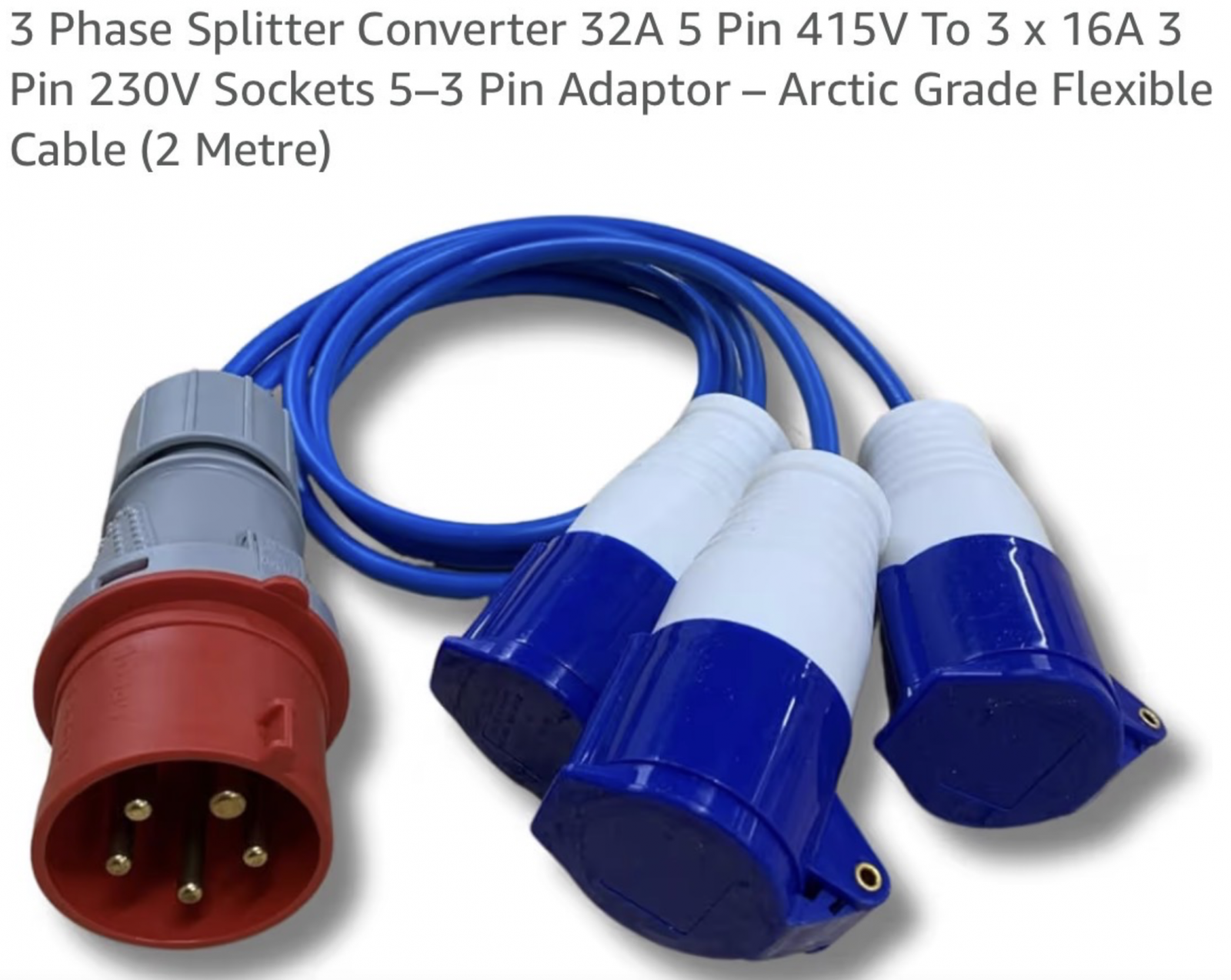

  1. So who can tell me please?
    the red plug is 3 phase so has
    3 x pos
    1 x neg
    1 x earth
    I want to connect 3 leads to the 16amp blue connectors. I know its possible as you can but them already completed, m but the parts are cheaper.
  2. it seems as simple as just using one of the L1 L2 L3 with a common earth and neutral
  3. This, but if you don't know that for sure, should you be doing it?

  4. thanks good to have confirmation
